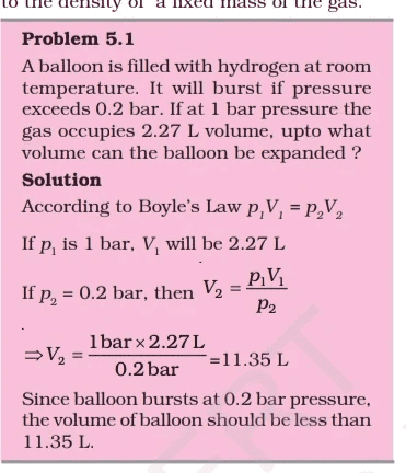

Problem 5.1
A balloon is filled with hydrogen at room
temperature. It will burst if pressure
exceeds 0.2 bar. If at 1 bar pressure the
gas occupies 2.27 L volume, upto what
volume can the balloon be expanded ?
My doubt is that in the answer it states(solution attached below) that volume of gas should be less than 11.35 liter , wouldn't a lesser volume lead to a pressure more than .2 bar and hence bursting of baloon.
Boyle's law

It sounds like both the question and answer are incorrect. I'd guess the intended question should state:
The balloon will burst if the internal pressure exceeds the external pressure by 0.2 bar.
(That would mean the ‘bursting pressure’ is 1.2bar.)
Strictly speaking,, the question should ask for the maximum balloon volume at room temperature, though I suppose this is implied.
This is a very badly worded question. The author has committed conflation of inflation with pressurization.
It makes sense only if the balloon is not stretchy at all hence the volume is fixed as the air is introduced, causing an overpressure
TahirMaqbool said:
The ##V_2## in the solution is the total gas volume (if at STP) that the ballooon will contain at bursting.
I agree that the problem is not very well worded. Here is how to rephrase it in order to get the given answer without confusion.
A balloon is filled with gas at room temperature and at pressure 0.2 bar. This same amount of gas, if placed in a 2.27 L rigid container at room temperature, would be at pressure 1 bar. Find the volume of the balloon.

That's all fine , how will you explain this
"Since balloon bursts at 0.2 bar pressure,
the volume of balloon should be less than
11.35 L."
A lesser volume will lead to a Higher pressure, isn't it wrong?

I believe this confusion arises from the 0.2 bar being a gauge pressure which means 1.2 bar absolute pressure (at STP in lab)

From the solution it would seem that the baloon is expanded at constant temperature and it has a constant amount of gas (it uses Boyle's law). How would you do that to a ballon? How do you increase/decrease pressure in a ballon without adding/removing gas or changing the temperature? If it is a soft ballon the pressure is equal to the atmospheric pressure. You can't increase its volume. Jus, maybe, squeeze the gas in a restricted portion of the balloon. But this can only increase pressure.
If it's a ballon with rigid walls, you can change volume even less.
Possibly the author just wanted a problem with Boyle's law and threw some random words into it thinking it would look better.

I don't have to explain anything. I just reworded the problem so that it makes sense. Note that there is no mention of bursting in my version.
The application of Boyle's law in that case wouldn't be done in a manner it is done
I have no idea what they think they have done. But Boyle's is linear in both P and V so who knows what they are doing. Can you provide the citation for the problem? I think it is probably a well conceived but badly stated problem and advise @PeroK solution. Why recycle it?
Except, the solution treats it as absolute.

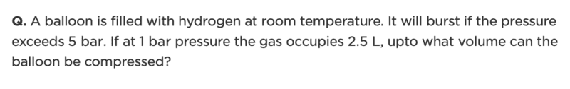

The question can be found at https://byjus.com/question-answer/a...-temperature-it-will-burst-if-the-pressure-1/
I have seen arrant nonsense at that website before. Can't find a way to give feedback without joining up (if then).

The solution treats the 0.2 bar as absolute pressure. Assuming that the solution is correct as written by the author(s), then we have to accept that the balloon was filled in a vacuum chamber from a reservoir containing gas at room temperature and absolute pressure of 1 bar. The gas transfer was done quasi-statically, maintaining the pressure and temperature of the gas in the reservoir constant. This was accomplished (sounds like a lab report, doesn't it?) by reducing the volume of the reservoir accordingly. At the moment just before the balloon burst, the amount of gas transferred was 2.7 L.

You give the BYJU crew way too much credit. Some of them may be good, but there seems to be inadequate peer review.
I admit I did not follow the BYJU link until now. Looking at the "Similar questions" was an eye opener. The "similar questions" differ mostly in the input numerical values except for when the authors decide to get creative with the laws of Nature as in the one below.
