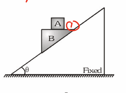

Block a of mass m is placed over a wedge of the same mass m. Both the block and wedge are placed on a fixed inclined plane. assuming all surfaces to be smooth calculate the displacement of block in ground frame in 1 s
the homework question.
This is what I thought. since the y component of both their accelerations will be same. we can do this. Mg-N=ma where N is the normal force. and for the wedge it is N+Mgsin^2(theta)=ma using second law of motion where N is the normal force. sin^2(theta) because i resolved gravity twice. now if you elminate N from the equation you get g(1+sin^2(theta))/2 and if you put it in the law of kinematics with t=1 it becomes g(1+sin^2(theta))/4. But apparently thats not the correct answer and I have no idea why.

Do you have an accompanying diagram by any chance?
Write Newtons 2nd for the wedged shaped block in the vertical direction. A FBD would be good practice.
Another tip would be to designate the normal forces by double subscripts. i.e. the normal force acting on block B from the fixed incline might be ##N_{IB}##, and the normal force from block A acting on B might be designated as ##N_{AB}##.
You have overlooked that N, the normal force between block and wedge, increases the normal force between wedge and ramp, and that this last has a vertical component.

@erobz told you how to proceed in post #4. Draw separate FBDs for the two bodies and write their F=ma equations. I merely pointed out where your attempt went wrong.

Thanks, I re-solved it. I am getting the solution. yeah the normal force exerted on the wedge by the block also needs to be resolved into components. im so dumb
