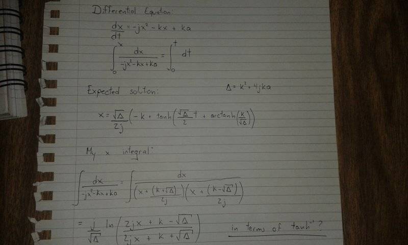

The problem is actually from chemical kinetics, but my problem is solving the differential equation obtained.
(dx(t))/(dt) = -j*x^2-k*x+k*a ; x is a function of t, and j,k,a are all real positive constants.
I know this is a Ricatti type equation. But this is from a class for chemists who haven't taken any differential equations classes. So I was trying to solve it by separation of variables. So, the x integral you obtain is
∫ dx/ (-j*x^2-k*x+k*a) with x from 0 to x.
I integrate this by means of partial fraction decomposition to obtain the answer in terms of natural log, and in terms of Δ (the discriminant of the second order polynomial)
∫=(j/√Δ)ln[(2jx+k-√Δ)/(2jx+k+√Δ)] + c (this is the indefinite integral)
but the answer expected to obtain is in terms of arctanh (inverse hyperbolic tangent function), I know they're related by arctanhx = ln(1+x/1-x)/2 , but I can't see how to relate my answer to this.
I attach basically the same information I already wrote but in paper, and the expected solution for the differential equation, even though I know that if I can relate the ln answer to the arctan one the rest of the problem is just solving for x.
Thanks for the help!

You dropped a factor of j and have a sign error. Also, use the fact that
$$\tanh^{-1} \alpha = \frac 12 \log \frac{1+\alpha}{1-\alpha}.$$

Just divide the numerator and denominator of the fraction you got in ln(..) by ##\sqrt\Delta##. Also j shouldn't be there , it is just ##\frac{1}{\sqrt\Delta}ln(...)##. ( I guess you forgot to put 1/j when taking the integral of ##\frac{1}{2jx+k+\sqrt\Delta}##)

I did checked Wolfram's answer, and it is in terms of arctanh, that's why I'm trying to relate my answer to it. Also, I tried what you said, dividing by ##\sqrt\Delta## but that gives something of the form ln(x-1/x+1) and the identity is in the form:
is there an identity I'm missing for logarithms?
I can see I'm almost there, but I don't know how to change the sign inside the log term.
Perhaps you need to use the fact that ##\frac{1+a}{1-a} = \left(\frac{1-a}{1+a}\right)^{-1}##.
There is a sign error afterall, as vela pointed out early on, you actually factorized jx^2+kx-ka the way you did it. So, we must put a minus sign in front so it becomes after all (using -lny=ln(1/y), ##ln\frac{2jx+k+\sqrt\Delta}{2jx+k-\sqrt\Delta}## but hmm this last expression is equal to ##2coth^{-1}(\frac{2jx+k}{\sqrt\Delta})=2tanh^{-1}(\frac{\sqrt\Delta}{2jx+k})##. i wonder what is going on here...
