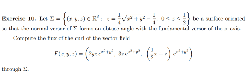

Problem with the positive orientation of a surface (Stokes' theorem)
In summary, the solution is the following: the current orientation of the Path is positive regarding to stocks (the surface should remain to the left), but the current N vector of the surface is positive regarding stockes theorem.

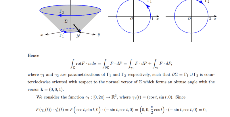

the solution is the following which I understand
I do understand why the current orientation of the Path is positive regarding to stocks (the surface should remain to the left) but I don´t understand why the current N vector of the surface is positive regarding stockes theorem

First off, the name is Stokes, not stockes and not stocks. The theorem is Stokes' (or Stokes's) Theorem, AKA Kelvin-Stokes Theorem.
Regarding your question, "I don´t understand why the current N vector of the surface is positive" -- I'm not sure what you mean by N being positive. Numbers can be positive or negative or zero, but vectors aren't comparable to numbers.

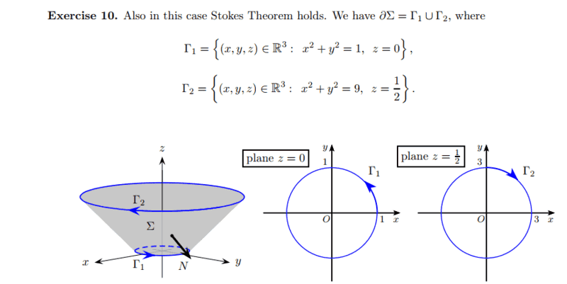

The problem statement, "the normal versor of ##\Sigma## forms an obtuse angle with the fundamental versor of the z-axis." I interpret this to mean that N is the vector that makes an obtuse (> 90°) angle with the positive z-axis. That means that N points outward and down, as shown in the drawing. A normal vector that pointed inward and up would make an acute angle with the positive z-axis.
What I find really interesting in this problem is the surface and its boundary. More specifically the boundary ##\partial\Sigma## consists of two closed curves and not just one.

I think the problem usually with surface is if the normal vector will be taken positive as inwards or outwards. For this particular surface, if it is taken positive as inwards, then it makes an acute angle with z-axis, if it is taken positive as outwards, then it makes an obtuse angle with the z-axis. But ok now I see @Mark44 already did a similar comment.

in the case of one simple surface the direction of the path determine the orientation of the surface with the right hand rule, in this case we have two borders if one gives us a surface with an orientation that goes with N and the second with one negative with N I hope you got my point
If that is the case then the curves do not form the directed boundary of the surface and you cannot apply the curl theorem.
Edit: … and note that this is not the case here. Both curves indicate the same normal direction.

when I apply the right hand rule on curve1 it goes up down when I apply it to curve 2, is there soemthing I'm missing?
Yes, you are applying the right hand rule wrong. You are applying it as if the surface was a disc in the middle of the curve - it is not.
The correct way to apply the right hand rule is to think about grabbing the curve with your right hand with the the thumb on the side the curve is directed towards. Then the normal of the surface is in the direction your other fingers point.
