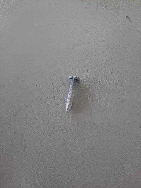

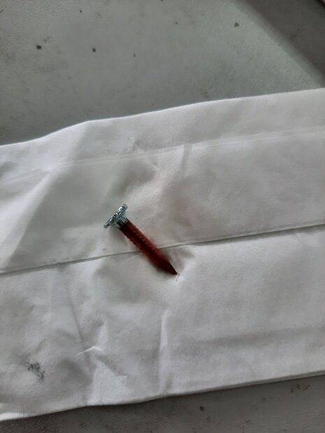

Pic 1: The first time we electroplated iron nail with copper. The surface of the nail had black substance after electroplating it.
Pic 2: The second time we did it & we used a lower concentration of copper(II) sulphate as electrolyte.
I wonder is that black substance copper oxide & what is the relationship between that black substance and the concentration of copper(II) sulphate.
Thanks!!

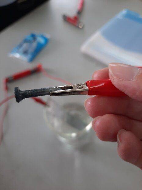

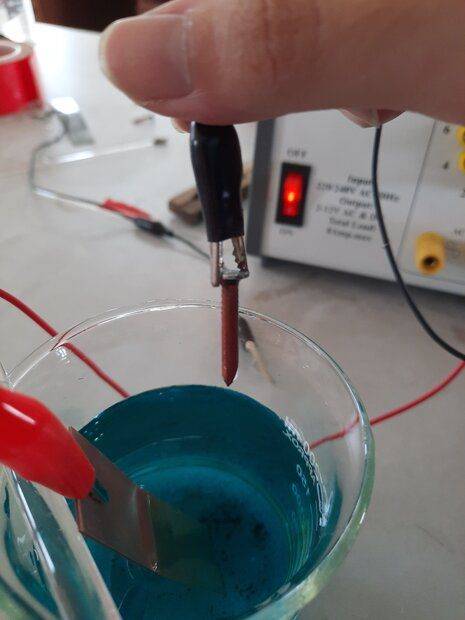

Can you say more about your plating setup? What settings are you using? How long are you letting the plating process run?
Cu plating on an iron nail is spontaneous. You shouldn’t have needed any current. What was the other electrode made of? Were those galvanized nails?

We used 3.0V (combination of two 1.5V batteries), copper plate, iron nail, 2 wires with crocodile clips, copper(II) sulphate solution (about 0.5M) (We didn't measure the concentration precisely) ThxThx

You are using two iron nails for electrodes. Only one will produce copper. Which one is black? Anode or cathode?
There is a problem with OP post formatting, but I believe they used copper plate for the anode.
