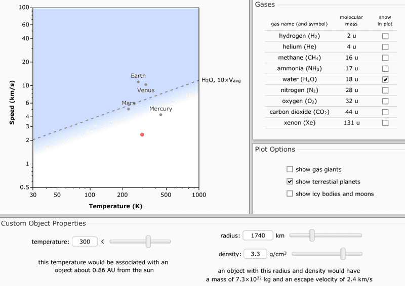

Yes, as you correctly noticed, the main thing is that a 1-meter water layer would completely evaporate because under its full weight at Moon, ~0.015 bar of pressure, boiling temp is below 20 C. So the conditions would be much closer to today's Mars than to anything "terraformed".
And this assumes that all water stays as vapor. Not the case. Taking into account slow rotation of the Moon, it is much hotter than 20 C during days (IIRC it's more like 90 C), and much below freezing during night, so even less water vapor will actually *be* an atmosphere.
Mean thermal velocity of water at 20 C is 585 m/s and is substantially lower than escape velocity 2380 m/s, but not as drastically lower as on Earth. High-speed tail of Maxwell–Boltzmann will be substantial. I have no tools here to calculate with good precision how fast it would be, I could be well wrong about "a few years", it might well be up to 100 years, but it's much, much faster than even on Mercury:
