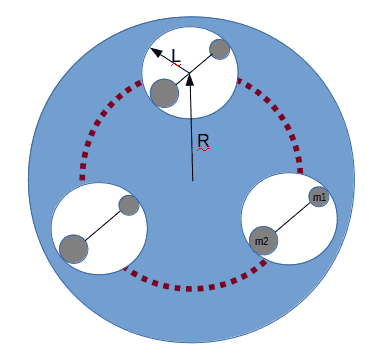

For a second question, substitute the disks by pairs of masses, this is, dumb-bells of length 2L and mass M/2 in each weight, still cased into a sort of ball bearing casing, so that their centre is still constrained to be in the circle of radius R. Solve again the problem. Is it possible to transfer angular momentum from the orbiting system to each dumb-bell, altering thus the rotational speed?
Now, for a more complicated thing, allow the dumb-bell to have assymetrical masses, say m1 and m2 with m1+m2=M. Will the rotational speed of the spinner, after the initial percussion, be constant in this case? If not, can you describe the variation?

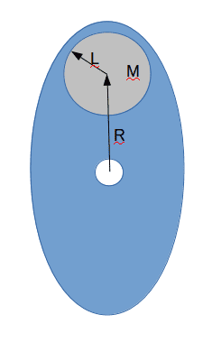

To fix the notation, and provide some drawing, I think the the general case could be this one
In the simplifications one could consider uniform disks of mass M instead of the dumbars, and to start considering only one disk, so

Yes I think that for the common support and with an uniform disk or a symmetric dumbar, the questions is the same that with a point mass M at distance R, is it? So if the impulse is I, the angular momentum would be (L+R) x I, and the angular speed [tex] (L+R) I \over M R^2[/tex]
is it?
for the less trivial case, we could consider the impulse at the same distance, R+L, and direction (tangential to the main casing) but applied on the internal disk. At this moment I am unsure of how the total angular momentum, say J, should divide between "orbital" and "spin" parts
