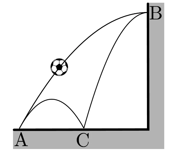

During the school holidays, we kick a football against the wall. The place of the kick is the point marked ##\text{A}## in the diagram. The balls hits the wall exactly perpendicular at point ##\text{B}##, and after the bounce it lands at point ##\text{C}##. After bouncing off the ground, the ball bounces back to its original starting point. A collision with a wall or a ground can be modelled as follows: the velocity component parallel to the surface does not change, while the one perpendicular to it changes by a factor of ##(-k)##. Generalize the above case and bounce the ball exactly ##N## times on the ground before returning to its starting position.
a) What is the value of ##k## for a given ##N##?
b) How long is the ball in the air?
Examine in detail the case ##N \to \infty##.
Projectile motion equations, some Calculus.
Imagine we kick the ball from point ##\text{A}## with horizontal speed ##u_x^{\text{initial, A}} = v \cos \alpha## and vertical speed ##u_y^{\text{initial, A}} = v \sin \alpha##.
The gravitational acceleration is ##\vec g##, the x-axis points towards the wall, the y-axis points upwards.
The first flight ##\text A \to \text B## draws a parabolic trajectory ending when the ball touches the wall at point ##\text B##, at the very highest point of the arc. At that instant, the vertical speed is ##u_y^{\text{initial, B}}=0##; the horizontal speed is still ##u_x^{\text{initial, \, B}}= u_x^{\text{initial, \, A}}##. The height of top point ##\text B## is ##H = \dfrac{{u_y^2}^{\text{initial, A}}}{2g}##; the ascent time is ##t_{\text{ascent}}=\dfrac{u_y^{\text{initial, A}}}{g}##. Then, the horizontal distance between wall and starting point is

After the ball hits the wall, what happens is described by the problem: the velocity component parallel to the wall doesn't change, while the one perpendicular to the wall changes by a factor of ##(-k)##. Since the velocity component parallel to the wall is the vertical component, then the vertical component of velocity doesn't change; thus, its magnitude is ##u_y^{\text{final, B}} = 0##. Since the velocity component perpendicular to the wall is the horizontal component, then the horizontal component of velocity is reversed and decreased; thus, from ##u_x^{\text{initial, B}}## it becomes ##u_x^{\text{final, B}} = -k \, u_x^{\text{initial, B}}##, with ##0 < k < 1##. The ball falls from height ##H = \dfrac{{u_y^2}^{\text{initial, A}}}{2g}## and again takes time ##t_{\text{descent}}= t_{\text{ascent}}=\dfrac{u_y^{\text{initial, A}}}{g}## to drop. During the fall from ##\text{B}## to ##\text{C}##, the ball moves horizontally by a distance
$$\begin{aligned}
D_{\text{BC}} &= k \, u_x^{\text{initial, A}} \, t_{\text{descent}} \\
&= k \, \underbrace{u_x^{\text{initial, A}} \frac{u_y^{\text{initial, A}}}{g}}_{= \, D_{\text{AB}}}\\
&= k \, D_{\text{AB}}.
\end{aligned}$$
The ball lands at point ##\text C##, which is at a horizontal distance from ##\text A## equal to

Then, $$D_{\text{AC}} = D_{\text{AB}} \, (1-k).$$
After the ball hits the ground, what happens is described by the problem: the velocity component parallel to the wall doesn't change, while the one perpendicular to the wall changes by a factor of ##(-k)##. Since the velocity component parallel to the gound is the horizontal component, then the horizontal component of velocity doesn't change; thus, it is ##u_x^{\text{initial, C}} = u_x^{\text{final, B}} = - k \, u_x^{\text{initial, A}}##. Since the velocity component perpendicular to the ground is the vertical component, then the vertical component of velocity is reversed and decreased; thus, from ##u_y^{\text{final, B}} = 0## it becomes ##u_y^{\text{initial, C}} = - k \, u_y^{\text{initial, A}}##, with ##0 < k < 1##.
I'm not sure about that.
a) From here, repeated parabolic trajectories start. After each bounce on the ground, vertical component of speed is multiplied by ##k##, horizontal component of velocity remains constant in magnitude.
If we number such paths with ##j=0, 1, 2, \ldots, N-1## starting from point ##\text C##:

The sum of horizontal displacements ##x_j## from ##j=0## to ##j=N-1## must then be equal to ##D_{\text{AC}}##. Thus:

So, ##k = 1/2## for ##N=1##.
For ##N \geqslant 2##, I really don't know how to solve Equation ##(*)##.
For ##N \to \infty##, we have
$$\begin{aligned}
\lim_{n \to \infty} \left(k^2 + 2 \, k - 1 \right)= \lim_{n \to \infty}2 \, k^{N+2} &\iff k^2 + 2 \, k -1 = 2 \, k^2 \lim_{n \to \infty} k^{N} \\
&\iff k^2 + 2 \, k -1 = 2 \lim_{n \to \infty} k^{N} k^2 \\
&\iff k^2 + 2 \, k -1 = 2 \, k^2 \underbrace{\lim_{n \to \infty} k^{N}}_{= \, 0 \, \text{since} \, 0 \, < \, k \, < \, 1} \\
&\iff k^2 + 2 \, k -1 = 2 \, k^2 \cdot 0 \\
&\iff k^2 + 2 \, k -1 = 0 \\
&\iff \underbrace{\cancel{k = - \sqrt 2 - 1}}_{\text{because} \, 0 \, < \, k \, < \, 1} \quad \vee \quad k = \sqrt 2 - 1 \\
&\iff k = \sqrt 2 - 1.
\end{aligned}$$
So, $$\boxed{k= \sqrt 2 - 1 \qquad \text{for} \quad N \to \infty}.$$

@Meden Agan, Your work looks excellent, and I think your results are correct.
Like you, I don't see how to solve your equation (*) analytically for ##k## for general values of ##N##. But this equation does give an implicit equation for ##k## that can be solved numerically.
A couple of thoughts…
You don’t need to exclude N=0, k=1. That only seemed to be invalid because the closed form expression for the geometric sum has a divisor k-1. But that later cancelled and the resulting expression is correct for N=0, k=1.
Your method for finding the limit as ##N\rightarrow \infty## is invalid, however. You overlook that k is a function of N. You cannot take the limit of ##f(k)g(k, N)## as being ##f(k)\lim g(k,N)## treating k as a constant.
See if you can do it rigorously.

Meden Agan said:
Binomial expansion of ##\left(1+ \varepsilon\right)^N##? We would have $$\left(1+ \varepsilon \right)^N = 1+ N \, \varepsilon + \frac{N \, (N-1)}{2!} \varepsilon^2 + \ldots \, .$$ Yes?
Yes, or via the ##e^{\epsilon N}## approximation. Either works.
OK.
We know that $$k^2 + 2 \, k - 1 = 2 \, k^{N+2}. \tag{*}$$
If we write ##k = 1 + \varepsilon##, under the first-order approximation ##(1+ \varepsilon)^N \approx 1 + N \, \varepsilon## (binomial expansion), ##(*)## becomes:
$$\begin{aligned}
(1+ \varepsilon)^2 + 2 \, (1+\varepsilon) - 1 = 2 \, (1+\varepsilon)^{N+2} &\iff 1 + 2 \, \varepsilon + \varepsilon^2 + 2 + 2 \, \varepsilon - 1 = 2 \, (1+\varepsilon)^2 \, (1+\varepsilon)^N \\
&\iff \cancel{1} + 2 \, \varepsilon + \varepsilon^2 + 2 + 2 \, \varepsilon \cancel{- 1} = 2 \, (1+\varepsilon)^2 \, (1+\varepsilon)^N \\
&\iff \varepsilon^2 + 4 \, \varepsilon + 2 = 2 \, \left(1+ 2 \, \varepsilon +\varepsilon^2 \right)\, (1+\varepsilon)^N \\
&\iff \varepsilon^2 + 4 \, \varepsilon + 2 = (2 + 4 \, \varepsilon + 2 \, \varepsilon^2)(1+ N \, \varepsilon) \\
&\iff \varepsilon^2 + 4 \, \varepsilon + 2 = 2 + 4 \, \varepsilon + 2 \, \varepsilon^2 + 2 \, N \, \varepsilon + 4 \, N \, \varepsilon^2 + 2 \, N \, \varepsilon^3 \\
&\iff \varepsilon^2 \cancel{+ 4 \, \varepsilon} \cancel{+ 2} = \cancel{2} \cancel{+ 4 \, \varepsilon} + 2 \, \varepsilon^2 + 2 \, N \, \varepsilon + 4 \, N \, \varepsilon^2 + 2 \, N \, \varepsilon^3 \\
&\iff 2 \, N \, \varepsilon^3 + \varepsilon^2 + 4 \, N \, \varepsilon^2 + 2 \, N \, \varepsilon = 0 \\
&\iff \varepsilon \, [2 \, N \, \varepsilon^2 + (1+4 \, N) \, \varepsilon + 2 \, N] = 0 \\
&\iff \varepsilon = 0 \quad \vee \quad \varepsilon = \frac{-(1+4 \, N) \pm \sqrt{(1+4 \, N)^2 - 16 \, N^2}}{4 \, N} \\
&\iff \varepsilon = 0 \quad \vee \quad \varepsilon = \frac{-(1+4 \, N) \pm \sqrt{1 + 8 \, N + 16 \, N^2 - 16 \, N^2}}{4 \, N} \\
&\iff \varepsilon = 0 \quad \vee \quad \varepsilon = \frac{-(1+4 \, N) \pm \sqrt{1 + 8 \, N \cancel{+ 16 \, N^2} \cancel{- 16 \, N^2}}}{4 \, N} \\
&\iff \varepsilon = 0 \quad \vee \quad \varepsilon = \frac{-(1+4 \, N) \pm \sqrt{1 + 8 \, N}}{4 \, N}.
\end{aligned}$$
For ##\varepsilon = 0##, then ##k = 1## for all ##N##.
Then, ##k = 1## as ##N \to \infty## would be a solution, but I'm very suspicious of that.
For ##\varepsilon = \dfrac{-(1+4 \, N) \pm \sqrt{1 + 8 \, N}}{4 \, N}##, then ##k = 1 + \dfrac{-(1+4 \, N) \pm \sqrt{1 + 8 \, N}}{4 \, N}##.
Evaluating the limit as ##N## approaches ##\infty##, we have:
$$\begin{aligned}
\lim_{N \to \infty} k(N) &= \lim_{N \to \infty}\left[1 +\frac{-(1+4 \, N) \pm \sqrt{1 + 8 \, N}}{4 \, N}\right]\\
&= \lim_{N \to \infty} 1 + \lim_{N \to \infty}\left[\frac{-(1+4 \, N) \pm \sqrt{1 + 8 \, N}}{4 \, N}\right] \\
&= 1 + \lim_{N \to \infty}\left[\frac{-(1+4 \, N) \pm \sqrt{1 + 8 \, N}}{4 \, N}\right] \\
&= 1 + \lim_{N \to \infty}\left(\frac{-1 -4 \, N \pm \sqrt{1 + 8 \, N}}{4 \, N}\right) \\
&= 1 + \lim_{N \to \infty}\left(\frac{-1}{4 \, N} - \frac{4 \, N}{4 \, N} \pm \frac{\sqrt{1 + 8 \, N}}{4 \, N}\right) \\
&= 1 - \underbrace{\lim_{N \to \infty} \frac{1}{4 \, N}}_{= \, 0} - \underbrace{\lim_{N \to \infty} 1}_{= \, 1} \pm \underbrace{\lim_{N \to \infty} \frac{\sqrt{1 + 8 \, N}}{4 \, N}}_{= \, 0} \\
&= 1 - 0 - 1 \pm 0 \\
&= 0.
\end{aligned}$$
Then, ##k \to 0## as ##N \to \infty##, but I'm not sure about that.
Does that make sense?
When making approximations you need to be consistent about what order terms you keep. You kept ##\epsilon^2## in some places but not all.
Mhm, OK.
Then, should I consider $$\left(1+ \varepsilon \right)^N \approx 1+ N \, \varepsilon + \frac{N \, (N-1)}{2} \varepsilon^2$$ rather than $$\left(1+ \varepsilon \right)^N \approx 1+ N \, \varepsilon \, ?$$
Meden Agan said:
Mhm, OK.
Yes. But since N will become very large you can use ##N^2## rather than ##N(N-1)##.
Mhm. I get really tedious and lengthy algebra. You too?
I obtain
$$\varepsilon(N) = -\frac{2 \, N^2 + 2 \, N}{3 \, N^2} + \frac{\sqrt[3]{N^6 - 6 \, N^5 + 21 \, N^4 + \, N^3 + 3\sqrt{3}\sqrt{N^{10} - 6 \, N^9 + 14 \, N^8 + 2 \, N^7}}}{3 \, N^2} - \frac{-N^4 + 4 \, N^3 - N^2}{3 \, N^2\sqrt[3]{N^6 - 6 \, N^5 + 21 \, N^4 + N^3 + 3\sqrt{3}\sqrt{N^{10} - 6 \, N^9 + 14 \, N^8 + 2 \, N^7}}}.$$
Then
$$k(N) = 1 -\frac{2 \, N^2 + 2 \, N}{3 \, N^2} + \frac{\sqrt[3]{N^6 - 6 \, N^5 + 21 \, N^4 + \, N^3 + 3\sqrt{3}\sqrt{N^{10} - 6 \, N^9 + 14 \, N^8 + 2 \, N^7}}}{3 \, N^2} - \frac{-N^4 + 4 \, N^3 - N^2}{3 \, N^2\sqrt[3]{N^6 - 6 \, N^5 + 21 \, N^4 + N^3 + 3\sqrt{3}\sqrt{N^{10} - 6 \, N^9 + 14 \, N^8 + 2 \, N^7}}}$$
and $$\lim_{N \to \infty} k(N) = 1.$$
If that were true, we would have ##k \to 1## as ##N \to \infty##.
No, nothing like that.
As mentioned, might as well use N rather than N+2. They’re both going to infinity:
##(1+\epsilon)^2+2(1+\epsilon)-1=2(1+\epsilon)^N##
Expand both sides up to ##\epsilon^2##. The constant term cancels, allowing you to cancel a factor of ##\epsilon## and yielding an expression for ##\epsilon##.
There's no need for the approximations. Note that ##k^N \to 0## as ##N \to \infty##. In which case, the equation for ##k## reduces to:
$$k^2 +2k -1 =0$$
Here's how I did it. Let ##t_1/2## be the time to hit the wall, and also the time after hitting the wall to the first bounce. Then ##t_j = k^{j-1}t_1## is the time for the jth bounce. Let ##u## be the initial horizontal velocity and ##T## be the total time after hitting the wall. And ##d## be the distance to the wall and ##h## the height of impact on the wall.
We have:$$\frac {t_1}{2} = \frac d u$$We can calculate ##T## two ways:
$$T = \frac d {ku} = \frac{t_1}{2k}$$And
$$T = \frac {t_1}{2} + \sum_{j =2}^N k^{j-1}t_1 = t_1\big (\frac 1 2 + \frac {k -k^N}{1-k}\big )$$This leads to:
$$k^2+2k-1 = 2k^{N+1}$$
$$k^2 +2k -1 =0$$
That is what I did in post #1. See post #4.
If we write ##k = 1 + \varepsilon##, ##(*)## becomes:
$$(1+ \varepsilon)^2 + 2 \, (1+\varepsilon) - 1 = 2 \, (1+\varepsilon)^{N+2}. \tag{1}$$
As ##N \to \infty##, ##N+2 \sim N##. Then ##(1)## becomes:
$$(1+ \varepsilon)^2 + 2 \, (1+\varepsilon) - 1 = 2 \, (1+\varepsilon)^{N}. \tag{2}$$
If we expand ##(1+ \varepsilon)^N## up to second-order, we have ##(1+ \varepsilon)^N \approx 1 + N \, \varepsilon + \dfrac{N \, (N-1)}{2} \varepsilon^2##.
Then ##(2)## becomes:
$$(1+ \varepsilon)^2 + 2 \, (1+\varepsilon) - 1 = 2 \left(1 + N \, \varepsilon + \frac{N \, (N-1)}{2} \varepsilon^2\right). \tag{3}$$
As ##N \to \infty##, ##N-1 \sim N \implies N \, (N-1) \sim N^2##. Then ##(3)## becomes:
$$\begin{aligned}
(1+ \varepsilon)^2 + 2 \, (1+\varepsilon) - 1 = 2 \left(1 + N \, \varepsilon + \frac{N^2}{2} \varepsilon^2\right) &\iff 1 + 2 \, \varepsilon + \varepsilon^2 + 2 + 2 \, \varepsilon - 1 = 2 + 2 \, N \, \varepsilon + 2 \, \frac{N^2}{2} \, \varepsilon^2 \\
&\iff \cancel{1} + 2 \, \varepsilon + \varepsilon^2 + 2 + 2 \, \varepsilon \cancel{- 1} = 2 + 2 \, N \, \varepsilon + \cancel{2} \, \frac{N^2}{\cancel{2}} \, \varepsilon^2 \\
&\iff \varepsilon^2 + 4 \, \varepsilon + 2 = 2 + 2 \, N \, \varepsilon + N^2 \, \varepsilon^2 \\
&\iff \varepsilon^2 + 4 \, \varepsilon \cancel{+ 2} = \cancel{2} + 2 \, N \, \varepsilon + N^2 \, \varepsilon^2 \\
&\iff \varepsilon^2 - N^2 \, \varepsilon^2+ 4 \, \varepsilon - 2 \, N \, \varepsilon = 0 \\
&\iff \varepsilon^2 \, \left(1- N^2 \right)+ 2 \, \varepsilon \left(2- N \right)= 0 \\
&\iff \varepsilon \left[\varepsilon \, \left(1- N^2 \right) + 2 \left(2-N \right)\right] = 0 \\
&\iff \varepsilon = 0 \quad \vee \quad\varepsilon \, \left(1- N^2 \right) + 2 \left(2-N \right) = 0 \\
&\iff \varepsilon = 0 \quad \vee \quad \varepsilon \, \left(1- N^2 \right) - 2 \left(N-2 \right) = 0 \\
&\iff \varepsilon = 0 \quad \vee \quad \varepsilon \, \left(1- N^2 \right) = 2 \left(N-2 \right) \\
&\iff \varepsilon = 0 \quad \vee \quad \varepsilon = \frac{2 \, \left(N-2 \right)}{\left(1- N^2 \right)}.
\end{aligned}$$
Then, ##k = 1## as ##N \to \infty## would be a solution.
For ##\varepsilon = \dfrac{2 \, \left(N-2 \right)}{\left(1- N^2 \right)}##, then ##k(N) = 1 + \dfrac{2 \, \left(N-2 \right)}{\left(1- N^2 \right)}##.
Evaluating the limit of ##k(N)## as ##N## approaches ##\infty##, we have:
\begin{aligned}
\lim_{N \to \infty} k(N) &= \lim_{N \to \infty} \left[1+\frac{2 \, \left(N-2 \right)}{\left(1- N^2 \right)}\right] \\
&= \lim_{N \to \infty} 1 + \lim_{N \to \infty} \frac{2 \, \left(N-2 \right)}{\left(1- N^2 \right)} \\
&= 1 + \lim_{N \to \infty} \frac{2 \, \left[N\left(1- \cancelto{0}{\dfrac{2}{N}} \right)\right]}{\left[-N^2 \left(1 \cancelto{0}{- \, \dfrac{1}{N^2}} \right)\right]} \\
&= 1 +\lim_{N \to \infty} \frac{2 \, N}{- N^2} \\
&= 1 +\lim_{N \to \infty} \frac{2 \, \cancel{N}}{- N^{\cancel{2}}} \\
&= 1 - \underbrace{\lim_{N \to \infty} \frac{2}{N}}_{= \, 0} \\
&= 1.
\end{aligned}
Then ##k \to 1## as ##N \to \infty##.
In both cases, we would have ##k \to 1## as ##N \to \infty##.
I do apologise, I have taken you the wrong way.
Just realised there should have been a caveat where you cancelled ##D_{AB}## in post #1. If k=1 then ##D_{AB}=0##, so N=0 is the only solution for k=1.
To take the limit, the substitution for k should have been ##k=\sqrt 2-1+\epsilon## (Doh!).
This leads to ##-2\sqrt 2\epsilon=(\sqrt 2-1)^N(1+\frac{N\epsilon}{\sqrt 2-1})##, which gives the desired result.
Mhm. How can we guess ##k = \sqrt 2 - 1 + \varepsilon##? Seems we need to know in advance the result is ##k= \sqrt 2 - 1##...
Your original approach strongly suggested that limiting value, it just wasn't a valid proof.
For ##N > 1## the two functions intersect at a point greater than ##\sqrt 2 -1##. You do know that is the positive zero of the quadratic. They also intersect at ##k=1##.
For large ##N## the power function converges pointwise to zero. The sequence of intersection points as N increases must have arbitrarily small function vales, hence must converge to the zero of the quadratic.
You could do an explicit epsilon-based argument if you wanted, but that's the outline.
