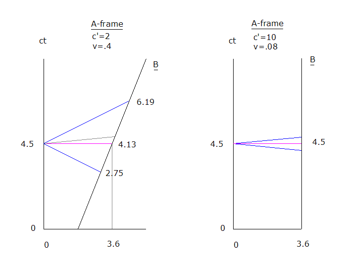

phyti said:
In drawing ftl2 the ftl signal moves at 2c. B moves at .5c, with c=1
Using the SR synch convention (radar or pinging method), the emission event A(x,t)=(0,1) is assigned to B(x,t)=(-.58,1.15),
and the detection event A(x,t)=(0,1.67) is assigned to B(x,t)=(-.96,1.92).
B calculates the incoming signal as instantaneous,
and the outgoing signal at .96/(1.92-1.15)=1.25.
In drawing ftl3 the ftl signal is instantaneous. B moves at .5c, with c=1
Since the time of travel is zero, and equivalent to zero distance, emission, reflection, and detection events are simultaneous and coincident for A. Thus must be coincident for all frames.
There could be any number of cycles relative to A in zero time. No information can be obtained in zero time. The same radar method does not work for this case because it requires a finite amount of time.
This is the view of universal time, before SR, i.e. observers see events in real time(as it happens).

For clarification, I have one issue with the op.
The speed of B and the ftl signal do not affect the rate of the A clock.
The op seems to think a ftl signal somehow implies motion backwards in time.
Then he doesn't offer an explanation for the expected results.
The 1st case I submitted shows for any signal speed in the range of c to instantaneous, the return is always
positive/later for the A clock.
Since it is an incorrect assumption as part of his argument, he can't make a case using it.
B will have a different description, but that's not part of my disagreement.

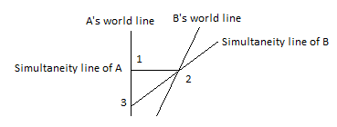

  • #43
vela said:
From A's perspective, for example, you will conclude it takes a positive amount of time for the signal to propagate from A to B and a positive amount of time for the return signal to propagate from B back to A.
But that isn't the case. If we let [itex]e_1[/itex] be the event where the original signal is sent from [itex]A[/itex], and we let [itex]e_2[/itex] be the event where that signal is received by [itex]B[/itex] (and also when the return signal is sent by [itex]B[/itex]--we can assume there is a negligible delay) and we let [itex]e_3[/itex] be the event where the return signal is received by [itex]A[/itex], then
From the point of view of [itex]A[/itex]:
  • [itex]e_2[/itex] happens after [itex]e_1[/itex]
  • [itex]e_3[/itex] happens BEFORE [itex]e_1[/itex]
So it's false that "it takes a positive amount of time for the return signal to propagate from B back to A". It takes a negative amount of time. The round trip takes a negative amount of time. The return signal from [itex]B[/itex] arrives BEFORE the original signal is sent by [itex]A[/itex].
What you, and phyti, are saying is that no matter how fast signals propagate, a round trip always takes positive time. But SR + the assumption of FTL communication says otherwise. That's the reason people say that FTL is incompatible with SR, because together they imply seemingly nonsensical results, that a message reply can arrive before the original message is sent.
SR says that FTL in one frame means back in time for another frame. In the list of events above:
  • [itex]e_1 \Rightarrow e_2[/itex] is FTL in A's frame, but back-in-time for B's frame.
  • [itex]e_2 \Rightarrow e_3[/itex] is FTL in B's frame, but back-in-time for A's frame.
  • The complete loop [itex]e_1 \Rightarrow e_2 \Rightarrow e_3[/itex] is back-in-time for BOTH [itex]A[/itex] and [itex]B[/itex]. Both of them agree that [itex]e_3[/itex] is before [itex]e_1[/itex].

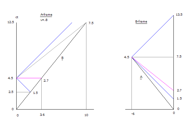

fredrik: post 133 link
So if Alice receives a message at (0,0), no matter what that message is, we get a contradiction. If she doesn't receive a message at (0,0), she sends 1 at (8,0). Bob receives that message at (8,10), and replies with 1 at (8,10). So Alice receives 1 at (0,0), and we still have a contradiction.
There is no contradiction. You have a two part program that runs as a signal inverter. You don't need Bob. Setup his system in the A frame, and get the same results (but not by your explanation).
The drawing is setup per your instructions, on the left, with a time line for B for clarity.
Using time only, signals detected at A(0) must be sent at B(2.7). Signals sent at A(8) must be detected at B(7.5). Signals sent at B(7.5) must be detected at A(8). Each only gets to send one signal at each specified time since their clocks are running.
Your choice of an 8 unit delay conveniently coincides with the SR calculated assignment of event A(0) to B(7.5). This is misleading to the conclusion that A(0) and A(8) are temporally connected, which they are not. They would be if using ftl signals with c’=c/v which in this case is 1.25c. Then the A ftl signal will appear to be instantaneous to B. The problem and confusion is not with ftl signals but the SR synch convention.
The motion induced phenomena of length contraction and time dilation work in a complementary way to preserve a constant round trip time for light signals, which is experimentally verifiable. In the 1905 paper, Einstein states “there is an A time and a B time, but no common time”. Despite knowing A cannot assign an accurate local time to the remote reflection event at B, he extends the theory by defining the light path segments out and back to be equal. (We can’t measure it but we can at least make it consistent).
Later in “Relativity- The Special and General Theory” 1961 Crown Publishing, pg 28, he states, the equivalent of a disclaimer, “That light requires the same time to traverse the path AM as for the path BM (M being a position between A and B) is in reality neither a supposition nor a hypothesis about the physical nature of light, but a stipulation which I can make of my own free will in order to arrive at a definition of simultaneity”.
The simultaneity axis is not real, it’s a calculated abstraction to provide an answer where none can be found (with current scientific knowledge).
I’m all for a general disclaimer: “All things mathematical do not correspond to physical reality”.
Notice in the drawings there are ftl signals, but none moving back in time!
The instantaneous signals require zero time, and don’t move forward or backward, and are the limit of speed.
So where does this association of ftl and time travel originate?
Consider a case where people are setting up an explosive device that will be triggered by an em signal. Just as they are about to leave for the bunker the signal is received, even though it was never sent.
With that possibility, there would be fewer controlled and isolated experiments. Physical phenomena would be less consistent and more chaotic.
Cause and effect imply order, let’s preserve it.

Because it's provable that FTL plus SR plus the principle of relativity implies the possibility of sending signals into the past. This has been explained several times. I don't understand what it is that you don't understand.

  • #58
Scenario in the linked post 133.
Fidelity of signal is lost due to program A swapping characters.
Scenario is revised eliminating programs.
Pic 1 has revised ct axis, with a common origin for simplification.
A event is A(0, 4.5).
A sends instantaneous signal (magenta) to B, pic 1.
B assigns time of 7.5 to A event using SR convention (blue), pic 1 and 2.
We assume that a tachyon emitted by one of these transmitters will move at infinite speed in the rest frame of the transmitter that emitted them.
This is contradicted in pic 2, since an instantaneous signal would have no history.
The A to B signal could be interpreted as moving backward in time, but can be explained as the result of using two different standards; an instantaneous signal for communication, and a signal at c for measuring coordinates.
In pic 3, c'=2c, so v=.8/2=.4, with 1/γ=.917.
The B radar round trip is 2.75 to 6.19, assigning A event to 4.47, offset by .34
In pic 4, c'=10c, so v=.8/10=.08, with 1/γ=.997.
The B radar round trip is 4.14 to 4.86, assigning A event to 4.50, offset by 0.
As the radar speed increases, the communication signal becomes near instantaneous in the B frame.
If a different messenger entity existed that moved ftl, the SR synch convention would have to be revised to include it as a replacement for the role of upper speed limit.
Instantaneous signals eliminate the role of cause and effect and an orderly, predictable world, and therefore undesirable.
There is a similar response in the linked post 132, to the suggestion of "abandoning causality" with
"So, instead of pushing to abandon the idea of a preferred temporal order, why not take the radiative arrow of time as fundamental vis the adoption of its archetypal form as the fundamental wave dynamic?
Anyway, this seems to me to be conceptually preferable to taking calculational conveniences as literally corresponding to the real world."
My quotes from the author of SR were intended to show the same, that his "stipulation" is only a convenience, and does not correspond to real world phenomena.
