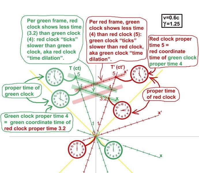

Proper (and coordinate) times re the Twin paradox
In summary, the stay-at-home twin is at rest in her frame and her clock must therefore measure proper time. The traveling twin, carries his clock with him; it is therefore at rest in his frame and must also measure proper time. As each twin is moving relative to the other, they will each measure coordinate time for their twin. Their proper times will be identical. Their coordinate times will be identical. As their relative speeds are the same, their Lorentz transformations will be the same. When the traveling twin slows on his return and comes to rest in his twin's frame they are both once again in the same frame and will have traveled exactly the same each relative to the other. It is only if the traveller continues

This is where it goes wrong:
Grimble said:
...and measure γt = 12.5 seconds (γ = 1.25, t = 10) to have passed (coordinate time?), for the other traveling twin's clock...
That's not correct, each twin measures 12.5 seconds (coordinate time) to have passed on their own clock in order for the other twin's paper to show 10 holes (10 seconds of proper time).
The rule of thumb is: if you can measure it with a single clock then it's a proper time, if you need two (or more) clocks then it's a coordinate time. Alternatively, if you measure it at the same location it's a proper time, if you measure it at different locations it's a coordinate time.
And if either or both events don't happen at the location of the clock, it is always a coordinate time.

The basis of your argument is (assuming a third clock at C:)
In A's frame, A's clock reaching ##10s## coincides with C's clock reaching ##8s## (say).
In B's frame, B's clock reaching ##10s## coincides with C's clock reaching ##8s##.
Therefore, in A's frame: A's clock reaching ##10s##, B's clock reaching ##10s## and C's clock reaching ##8s## are all simultaneous. Hence, simultaneity is not relative and SR is wrong?
Although, given this, C's clock must also read ##10s## as well (just put another clock that stays half-way between A and C) and there's no time dilation either.

Two rulers have their zero markings aligned but do not point in the same direction. The rulers are identical, the distances measured will presumably be identical - what reason is there for the 10cm marks to be in different places?
To expand on this a bit - both rulers and clocks are devices for measuring intervals along lines in spacetime. Rulers can only measure spacelike intervals and clocks can only measure timelike intervals. But notice those likes. There is no unique direction in spacetime that is Time. There are a whole family of directions which are timelike. So, generally, a clock does not necessarily measure what I choose to call time anymore than rulers are restricted to measuring what I choose to call forwards or sideways.
Clocks always measure an interval, but this may be something I call a mix of time and distance. Just as a ruler always measures distance, but this may be something I call a mix of forwards and sideways. The only special thing about Minkowski space is that you can't map the direction you call the future onto any of the spatial directions (or vice versa) by rotation because of the way the geometry is defined.

A set of unique coordinates is made up of a multitude of coordinates each of which is unique...

When both clocks move relative to each other, the 'identical time' you refer to, f.ex event 5 seconds proper time clock A and event 5 seconds proper time on clock B are not occurring simultaneously anymore. When they move relative to each other you are not allowed to say that "When I tick 5 seconds per my inertial ref frame, the other clock also ticks 5 times per his inertial ref frame." It's a statement that doesn't make sense anymore.
Per clock A ref frame clock B ticks slower. It means that f.ex. when clock A shows 5 seconds proper time, clock B shows only 4 seconds of its proper time (for gamma factor 1.25 for 0.6c). For clock A, clock B ticks slower, not because clock B ticks slower in its own inertial ref frame, but because of relativity of simultaneity clock A ref frame and clock B ref frame take different directions in 4D spacetime. This slows the popping up of clock B proper time events per clock A ref frame (and slows the popping up of clock A proper time events per clock B frame).
The 5 seconds clock A proper time is also a clock A coordinate time for 4 seconds clock B proper time.
You know how to read and draw spacetime diagrams?
