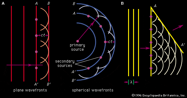

@pixel
Maybe this picture helps here. Assume the purple dots are the elementary emitters. In the rest frame of the source emit simultaneously (most left picture), while in a frame where the source moves they don't, thus producing an oblique wave front (most right picture).
See also:
https://en.wikipedia.org/wiki/Relativity_of_simultaneity
https://en.wikipedia.org/wiki/Huygens–Fresnel_principle
Likes harrylin
pixel said:
I am not questioning that the light has a triangular path in B's frame. I am simply looking for how B explains seeing a vertically oriented light source but a triangular path of light, using a high-school or freshman physics level physical explanation.
Yes, I gave you a high-school level physical explanation why a laterally moving vertical source cannot produce a vertically pointing light ray... from that perspective, the light is pointing at an angle at emission already.
A.T. said:
If I'm interpreting it right, the diagram on the right is very instructive.
Yes it is; the Huygens construction is often very instructive -nice post by AT. :smile:
