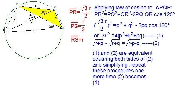

Given a cyclic quadrilateral $PQRS$ where $PQ=p,\,QR=q,\,RS=r$, $\angle PQR=120^{\circ}$ and $\angle PQS=30^{\circ}$.
Prove that $|\sqrt{r+p}-\sqrt{r+q}|=\sqrt{r-p-q}$

my solution :
Thank you Albert for your solution:cool: and I will post the answer that I have at hand later, in case there are others who might want to try it..
