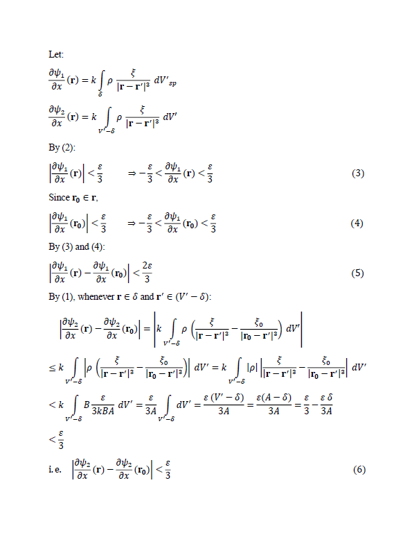

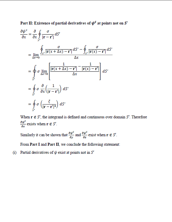

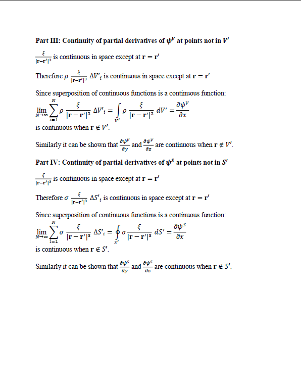

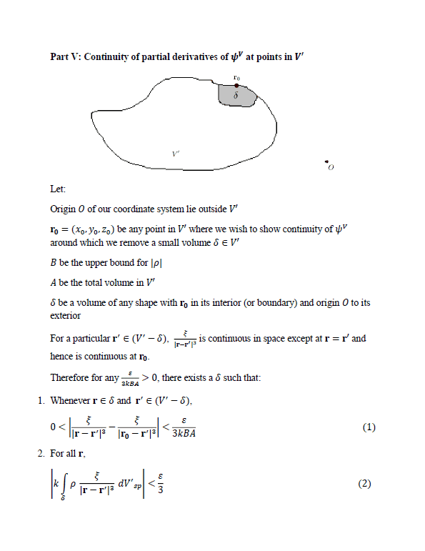

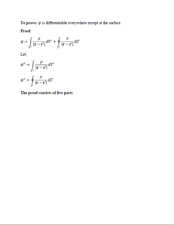

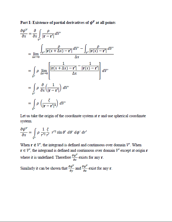

I don't know how much this helps, but it seems you need to use the FTC in 2-dimensions, which is Green's theorem, though I don't have a full understanding of how to do this. Is this what you are aiming for?
I was told by moderators to show my work. I have worked it out myself in the best possible way I could. It just needs to be checked (if there are any mistakes).

Are there any mistakes or anything missing?

Can anyone point out the flaws in my work if there are any.
I had a look at it. In general the result won't be true. It will depend on ##\rho## being well behaved in some way.
Any rigorous proof should identify the required properties of ##\rho##.
The first thing you did was take a limit inside an integral. That in general is not possible.
On the main body you seemed to prove continuity outside the region of charge, but there was nothing to justify continuity at the singularity. A rigorous proof would have to take the limit of proper integrals in this case.
In general a rigorous proof ought to be built on perhaps some intermediate theorems. Doing it from first principles is probably asking too much. And, if I'm honest, of limited value.
Finally, you need to decide whether the integral is Riemann or Lesbesgue.
##\rho## is continuous, bounded and its domain ##V'## is finite. Any more properties required to be added??
I was also not convinced myself with part I and part II in the first place. The convergence theorems seem to be too esoteric to me. Do you know another simpler method to show the existence of partial derivatives of ##\psi^V## and ##\psi^S##?
I think I have done. Please have a look at part V
