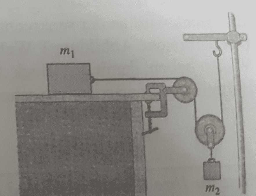

In term of m1, m2 and g, find the acceleration of each block. There is no friction anywhere in the system
∑F= ma

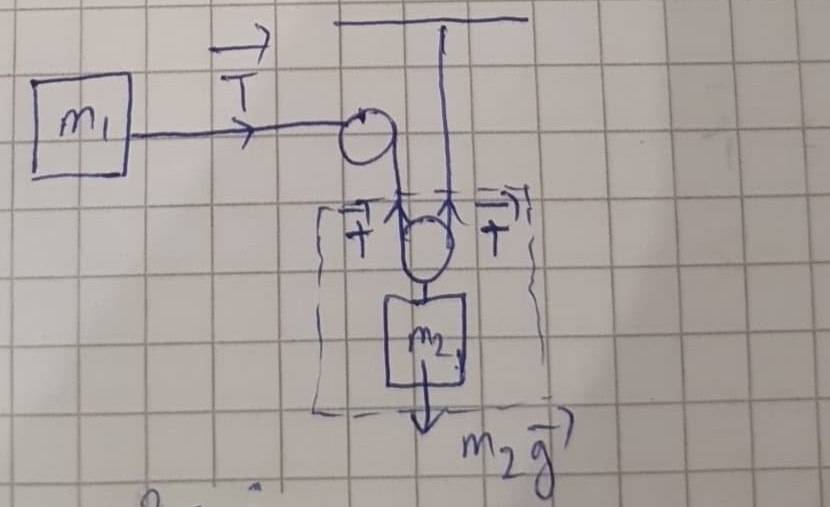

  • Block m2:
    m2g - 2T = m2a2 (1)
  • Block m1:
    ∑F= ma
    T= m1a1 = m1.2a2 (2)
    Cancel T in (1) and (2) I have :
    m2g = a2 (4m1 + m2) => a2 = m2g / (4m1 + m2)
    => a1 = 2m2g / (4m1 + m2)
Is my answer correct ? Thank you
Your work looks correct to me.
Thank you
