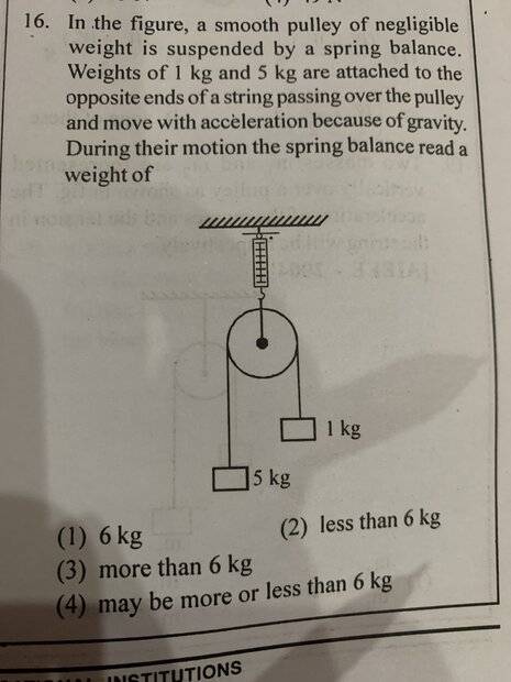

In the fig, a smooth pulley of negligible weight is suspended by a spring balance. Weights of 1kg and 5kg are attached to the opposite ends of a string passing over the pulley and move with acceleration because of gravity. During their motion the spring balance read a weight of ?
##F=ma##
Net force acting downwards is ##5g-g=4g## in downward direction. Net force on pulley is ##2T-4g##. Weight measured by balance?

What do you think?
Same measurement when bodies are released and when accelerating?
I believe that is what the question is about.
The problem is treating kg as unit of force, when it is a unit of mass.
The spring scale can only measure force; therefore, its markings should be kg-force.
https://courses.lumenlearning.com/physics/chapter/9-3-stability/
Your calculations without a free body diagram seem not to be accurate.
The best you can, please draw a FBD for the system of spring scale/masses, not including internal forces (especially T).
The only thing pulling down on the pulley is the string. The weights of the masses act on the masses, not on the pulley.

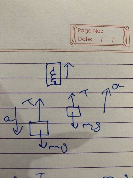

I cannot make a very good FBD. I think the balance will measure less weight than 6 kg, either 5kg or 4kg because the net force on 1kg mass is upwards due to which balance may not measure full 1kg weight. So it will surely be less than 6kg. But I can’t prove it.

Don't "do it in your head" or guess. You have free body diagrams for the masses, now add one for the pulley.
Analyzing forces on the masses will allow you to solve for the acceleration and the tension.

Calculating the spring-balance reading will be a valuable exercise for the OP and I would encourage this.
But it is worth noting that choosing from the list of possible answers requires no calculations (other than 1+5=6).
First realize that the centre of gravity of the pulley+masses accelerates downwards. Finding the allowed range of the upward force (from the spring) is then simple.

When I calculated and taking g=10 I got a=6.67 m/s^2. So if we treat the bodies as one 6kg and the acceleration as a=6.67 m/s^2 then the force acting downwards and on the balance is F=40.02 N. That's what the balance measures. Balance measures 4 kg.
