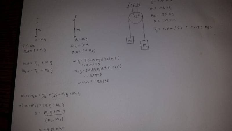

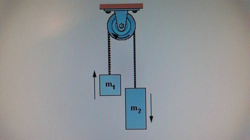

In the figure, block 1 has mass m1 = 450 g, block 2 has mass m2 = 530 g, and the pulley is on a frictionless horizontal axle and has radius R = 5.3 cm. When released from rest, block 2 falls 71 cm in 5.0 s without the cord slipping on the pulley. (a) What is the magnitude of the acceleration of the blocks? What are (b) tension T2 (the tension force on the block 2) and (c) tension T1 (the tension force on the block 1)? (d) What is the magnitude of the pulley’s angular acceleration? (e) What is its rotational inertia? Caution: Try to avoid rounding off answers along the way to the solution. Use g = 9.81 m/s2.
F=ma
im on part a, and i don't know why i keep getting a=-9.81m/s/s, it should be less than that.
I will give a hint, what do you think of the acceleration of the two boxes, can you compare them ? can the acceleration be g ? Apply Newton's second law for both masses, T1 - m1g = m1a, T2 - m2g = m2a, Oh now I've noticed that the two acceleration have different (opposite) ditection !,

a=(m1g-m2g)/(m1+m2) =-.80082m/s/s where am i going wrong?
I see that a is in opposite directions but that is the variable I am solving for. g is still 9.81 for both.
The tensions cancel each other out right?
edit; i have so far; m1a=T-m1g and m2(-a)=T-m2g I must not be doing the algebra correctly when solving for a here.
The T's have the same magnitude, if the cancel them selves out, the objects would be free falling right?, the acceleration you've got seems correct to me !

If the tensions canceled each other out then the gravitational forces of each mass would be working against each other.
w1-w2=-0.7848N

a = (m-M)g/(M+m) is right, I've edit my last post, they don't cancel each other out !,
That should be all you need to find the acceleration. (And the reasonable assumption that acceleration is constant.)
You can't find the acceleration with Newton's laws because you don't know the mass of the pulley.

If you know the final velocity you can simply say that Vf=at (because as I said, you can assume acceleration is constant).
But 0.142 is not the final velocity. You took the total distance divided by the total time, why would that be the final velocity? What does the total distance divided by the total time represent?

The initial velocity is 0, right ? So Vavg = Vf/2

Vavg =(Vf+Vi)/2, initial velocity is 0 so Vavg = Vf/2,
X = at^2/2, you can solve for a, Vavg = Vf+Vi/2, Vi = 0, Vavg = Vf/2

Just work it out, you're almost there, try this because it's very simple,assuming no initial velocity if a is constant then x = 1/2 at^2 , a = 2*x/t^2, for t = 5, x = 0.071, work it out !
  • #33
ok i got a=.0568m/s/s
