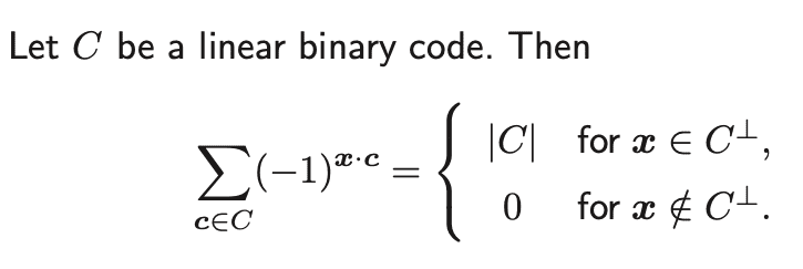

A Quantum linear code/ Dual Code (CSS) proof
steve1763
TL;DR Summary
What would the proof be for the following identity? I cannot find the proof anywhere
How should we know, what your symbols mean? You have to give a bit more information or a link to the paper you are referring too.
If ##x\in C^\perp## then it is clear. If not, then there is a ##c_0\in C## such that ##x\cdot c_0 =1##. The you have
-1\sum_{c\in C}(-1)^{x\cdot c}=(-1)^{x\cdot c_0}\sum_{c\in C}(-1)^{x\cdot c}=\sum_{c\in C}(-1)^{x\cdot (c-c_0)}=\sum_{c\in C}(-1)^{x\cdot c}
The last equality is because ##C## is a subspace.
-1\sum_{c\in C}(-1)^{x\cdot c}=(-1)^{x\cdot c}\sum_{c\in C}(-1)^{x\cdot c}=\sum_{c\in C}(-1)^{x\cdot (c-c_0)}=\sum_{c\in C}(-1)^{x\cdot c}
Thank you very much
