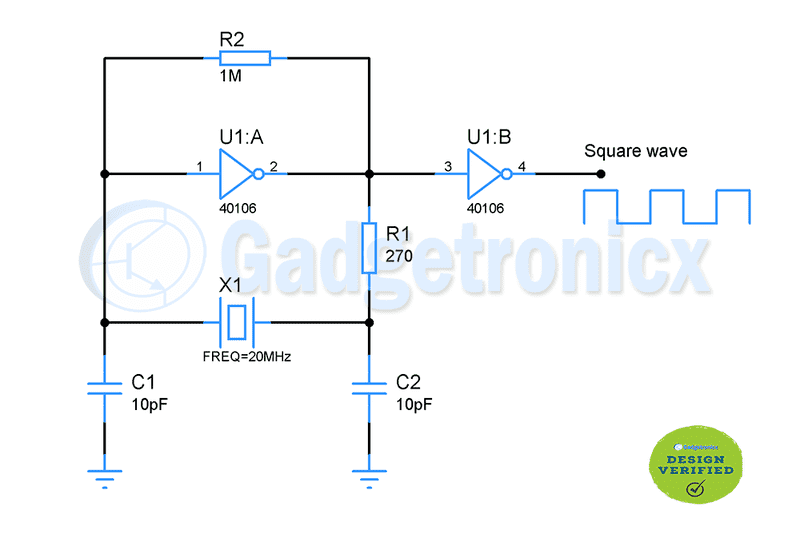

I'm with @anorlunda -- I don't understand your question. Do you have a datasheet for the clock you are asking about?
Or perhaps are you asking about how to build a crystal oscillator circuit? There are some requirements on the oscillator circuit (like using an unbuffered inverter for some configurations), but you would need to tell us more in order for us to help you.
https://www.gadgetronicx.com/square-wave-generator-crystal-oscillator/

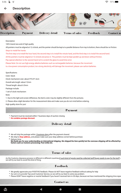

The manufacturer in China says not to use rechargeable or alkaline batteries even Seikos website says no alkaline batteries, seems to me on DC you only have volts and amps.
See what a seller on Ebay writes about batteries.

All battery-operated equipment must run off a range of voltages, since batteries vary over their useful life. Both Zn-C and alkaline batteries are nominally 1.5 V and spend most of their life between about 1.5 - 1.3 V
NiCd and NiMH have a lower voltage, starting around 1.3 V and spending most of their life around 1.2 - 1.1 V, so I can see why they might not work. And I certainly have equipment which does not work with rechargeables (on a one to one replacement basis) or works only briefly with a freshly charged battery.
Alkaline batteries are preferred for higher current loads and because they may(!) be less likely to leak if left in past their useful life.
Zn-C I've seen specifically recommended for low-drain applications like clocks.
Clocks are also less likely to leak as they are not usually on stand-by: they operate all the time and you notice quickly if the battery reaches the end of its useful life.
If the current demand of the short pulses is significant, I'd have thought designers would include a bit of capacitance to support the transient load.
Quote from above image: "Too strong electricity will damage the movement."
OMG....

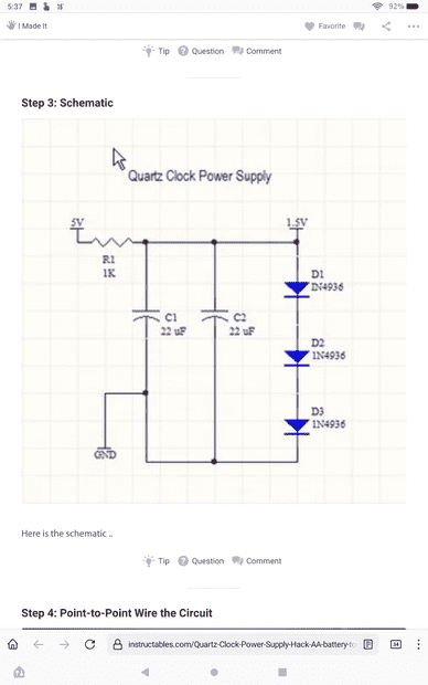

Somebody thinks this will work three diodes in row cuts voltage from 5 to 1.5.
"Somebody" is not a valid reference at PF. I checked the datasheet for those diodes and this schematic is obviously in error. Lordy.
