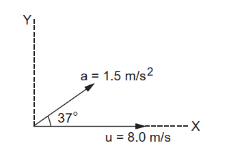

A particle moves in the X-Y plane with a constant acceleration of 1.5 m/s^2 in the direction making an angle of 37° with the X-axis. At t = 0, the particle is at the origin and its velocity is 8.0 m/s along the X-axis. Find the velocity and the position of the particle at t = 4.0 s. The graph corresponding to the question is attached herewith.
