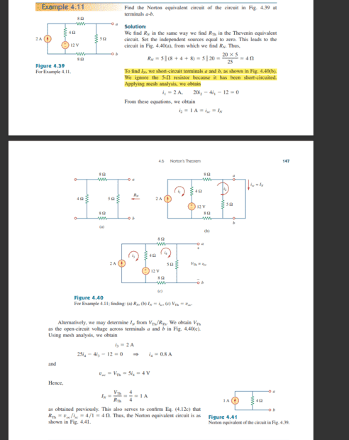

See picture please, it is highlighted in yellow.

I was wondering whether I could get some help about the highlighted part. What I don't understand is why we are able to ignore the 5-ohms resistor when we have short circuited terminals a-b.
Thanks in advance.
Because a zero ohm resistor in parallel with a 5 ohm, (or any other resistor) is going to be zero ohms.
Thanks! and thanks once again! I didn't think this through then.. makes total sense (also just noticed I was looking at fig(c) not (b) :'D) Thanks though!
