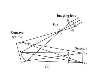

Thanks a lot for your answer. It clears some of my doubts. But I am bit confused here. The collimating light in the picture is falling on imaging lens and focuses on the slit. Inside a typical spectrometer, there are already some collimating mirrors and gratings that help differentiate the light. I am curious if the light is really required to be focused on the slits or not before entering the spectrometer .
Yes, of cause, the feeding optics should fit the light within the acceptance etendue of spectrometer. That means you should aim 1) even spatial illumination within the entrance slit and 2) even angular illumination within the numerical aperture (the latest to obtain even illumination across dispersive grating).

Thanks for your response. Actually, in our system, collimated light is incident on the sample and then, reflection from the sample is used for imaging. So, I was confused whether the reflection rays from sample is also collimated or not. If these reflected rays aren't collimated, then should we add additional collimation lenses or focusing lenses in front of the spectrometer's slit?
Right, presumably you need a sort of relay optics to reimage illuminated sample spot onto spectrometer slit, aiming that the light cone would exceed the acceptance numerical aperture of the spectrometer.

I am into aerials / RF rather than optics and gratings but the same principles apply for all waves. There are two requirements. You need as much light as possible through the system so the source needs to be squeezed into the slit. Then, the path length from all points on the collimator needs to be the equal to points on the grating. Having a curve allows this. You need a sharp image of the slit on the detector for best wavelength resolution. The grating will shift that image according to the wavelength.
I'd imagine that first off you want a sharp image in the detector and then you want it as bright as possible by getting the source focussed on the slit. That would be a way to approach it.

That is not a necessary demand.
If resolution approaching diffraction limit, the slit width should be reduced accordingly and that would filter out phase aberrations.
If resolution defined by detector's pixel pitch, the slit width would be optimally twice the pixel pitch and again, the phase aberrations is not limited factor.
That means, it is enough to focus "somehow " illuminated sample to the entrance slit. The main subject is matching the illumination cone with the spectrometer internal acceptance cone and provide evenness of the light distribution within the cone.
Uneven light cone would result the an apparent wavelength shift compared to the wavelength calibration.
