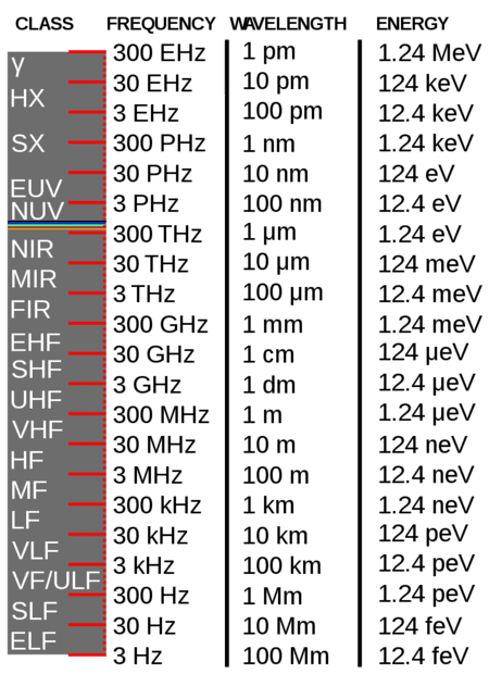

In the past, there was no easy way to measure Radio frequencies directly because the devices weren't available. Engineers (and amateurs) would find the wavelength of a signal by observing max's and min's on transmission lines. Nowadays, you can get a frequency counter to measure some extremely high frequencies but, by the time you get to millimetre waves and shorter, we still use wavelength and, for high energy waves (X Rays and beyond, it's common to talk in terms of Energy and electron Volts (eV). All the same stuff but the units are chosen to suit the particular users.
This table in Wikipedia is interesting and the energy of photons is shown in the right hand column.
Likes Klystron
