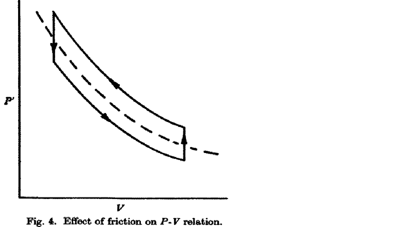

OK. Here we go.
Here are the assumptions I'm proposing to use:
1. During the expansion or compression, the friction force on the piston is constant at F.
2. The piston is massless, and has zero heat capacity
3. All the heat generated between the wall and the piston ends up in the gas
4. The expansion and compression are carried out quasi-statically
Are you in agreement with these assumptions?
Are there any others that you think we should be using?
Which do you want to do first, expansion or compression?
What to you want included in the system: (a) just the gas or (b) the gas plus the piston? (I'm suggesting we eventually do it both ways to see how the two analyses compare).
Chet

Chestermiller said:
OK. Here we go.
Chet

OK. Let's get started.
The first step is to write down the force balance on the piston. In terms of the friction force F, the piston area A, the externally applied pressure Pext, and the gas normal stress at the piston interface τI, what is the force balance on the piston if we are considering expansion? (Of course, for quasi-static deformation, τI is going to be equal to p, the ideal gas law pressure within the cylinder).
Chet
Chestermiller said:
If I remember correctly, yes.
The Newtonian fluid constitutive equation not only applies to homogeneous deformations; it applies locally to all deformations, including non-homogeneous deformations. Check out those partial derivatives in the general Newtonian fluid equations. The validity of applying the Newtonian fluid model locally to non-homogeneous deformations has been demonstrated by hundreds of years of success.
What are homogeneous and non-homogeneous deformations?
From looking at the general equation, what I get from it is that viscous shear stresses acting on some plane are functions of velocity gradients for velocities that may or may not be in the same direction, such as [itex]\tau[/itex]xy = μ[itex]\frac{∂v_x}{∂y}[/itex] in this example where velocity in y-dir is 0 yet shear stress in the y-dir is non-zero as velocity in x-dir is nonzero. Is this correct?
Chet
PI = RT/v and PI = Pext + F/Apiston if the piston is expanding.
Thanks very much
A homogeneous deformation is one for which the velocity gradients are the same at all locations throughout the flow field. A non-homogeneous deformation is one for which the velocity gradients are not the same at all locations throughout the flow field.
Yes.
Good. So, if we combine these equations, we have:
[tex]\frac{nRT}{V}-\frac{F}{A}=P_{ext}[/tex]
We next use this equation to get the work done by the system on the surroundings when the volume of gas increases by dV:
[tex]dW=P_{ext}dV=\frac{nRT}{V}dV-\frac{F}{A}dV[/tex]
We're next going to apply the 1st Law to the system. Let dU = nCvdT be the change in internal energy of the system when the volume of the gas increases quasistatically by dV. Please write that 1st law equation.
Chet

This is where I was confused. I get:
δQ - δW = dU
I am assuming that the work done to overcome friction is equivalent to the heat addition
[tex]δQ = \frac{F}{A}dV [/tex]
but then I end up with which doesn't look right:
[tex]-\frac{nRT}{V}dV = nC_v dT[/tex]
Unless the friction heat addition doesn't come into first law because it occurs at the system boundary and not added via finite temperature gradient. If this is the case δQ = 0 and I get this:
[tex]-\frac{nRT}{V}dV +\frac{F}{A}dV = nC_v dT[/tex]
I suspected that this would be the trouble spot.
I get:
δQ - δW = dU
Not exactly. We said that the cylinder is insulated, so no heat leaves or enters through there. And we said that all the "heat generated" stays in the system, so none leaves or enters through the top of the piston. Since δQ represents the heat entering through the interface between the system and the surroundings, δQ = 0.
We also said that the piston has zero heat capacity, so that the change in internal energy for the system is purely the result of the change in internal energy of the gas (without any contribution from the piston).
Incidentally, unlike the gas dynamics analysis which was rather complicated in the irreversible problems we discussed in the other thread, the heat transfer analysis for the heat generated between the cylinder and the piston, and its conduction through the piston to the gas below is rather easy to set up. This might give you some additional insight into what is happening. If you're interested, just say so.
Yes, this is the correct result. So now, rearranging this into the form of a first order ordinary differential equation, we get:
[tex] nC_v \frac{dT}{dV}+\frac{nRT}{V} =\frac{F}{A}[/tex]
The initial condition on this differential equation is T = T0 at V = V0. Do you remember how to solve a differential equation of this form? If so, please proceed.
Chet

From solving the ODE I got:
[tex] T(V) = \frac{Const}{V^\frac{R}{C_v}}+\frac{F}{nA(R+C_v)}V [/tex]
[tex] Const = V_o^\frac{R}{C_v}(T_o - \frac{FV_o}{nA(R+C_v)}) [/tex]
[tex] T(V) = T_o(\frac{V_o}{V})^\frac{R}{C_v}+\frac{FV_o}{nA(R+C_v)}[(\frac{V_o}{V})^\frac{R}{C_v}-\frac{V}{V_o}] [/tex]
My solution doesn't match yours. I got a minus sign in from of the last term. The friction term should raise the temperature, not lower it.
[tex] T(V) = T_o(\frac{V_o}{V})^\frac{R}{C_v}-\frac{FV_o}{nA(R+C_v)}[(\frac{V_o}{V})^\frac{R}{C_v}-\frac{V}{V_o}] = T_o(\frac{V_o}{V})^\frac{R}{C_v}+\frac{FV}{nAC_p}[1-(\frac{V_o}{V})^\frac{C_p}{C_v}][/tex]
So,
[tex] T(V) = T_o\left(\frac{V_o}{V}\right)^{γ-1}+\frac{FV}{nAC_p}\left[1-\left(\frac{V_o}{V}\right)^γ\right][/tex]
Note that the first term is the temperature change if there were no friction, and the second term is the temperature rise resulting from the friction.
Now, please use the ideal gas law to determine the gas pressure P when the gas has expanded to volume V (in terms of the initial pressure P0), and then use the calculated temperature T to determine the total change in internal energy when the gas expands to volume V. From this, and the first law, you can also get the total amount of work done. What are your conclusions from these results?
Chet

My bad, I had a typo in the last equation and the plus on the last term should be a minus.
The cylinder pressure:
[tex] P(V) = P_o\left(\frac{V_o}{V}\right)^{γ}+\frac{FR}{AC_p}\left[1-\left(\frac{V_o}{V}\right)^γ\right][/tex]
The gas/system internal energy change:
[tex]ΔU = nC_v(T(V) - T_o)[/tex] where T(V) is as before
Since this is expansion, V_o/V < 1, so the last term in the P(V) and T(V) equation is always positive. This tells me that the gas pressure at any point during an expansion when there is piston-cylinder friction will always be higher compared to that of a reversible expansion at the same V. The same can be said for gas temperature/internal energy. Is this correct?
Thanks very much

Yes. I was hoping that you would substitute your equation for T(V) into the equation for ΔU. This will then also tell you the total amount of work done for the expansion.
What we are looking at here is an irreversible process (even though the deformation is quasi static). We can confirm this by calculating the change in entropy ΔS for the gas. Since the process path is adiabatic, from Cauchy's inequality, the entropy change for the system should be positive if the process is irreversible (since ∫dQ/TI is equal to zero). Please determine the change in entropy.
[tex]ΔS=n(C_pln(T(V)/T_0)+Rln(P_0/P(V)))[/tex]
Also, please start thinking about how we can modify these results if the deformation is compression, rather than expansion (without doing the entire analysis over again).
Chet

Hi Red_CCF,
Here's what I came up with regarding ΔS, starting with your original equation and using the ideal gas law:
[tex]ΔS=n(C_pln(\left(\frac{V_o}{V}\right)^{γ-1}+\frac{FRV}{AC_pP_oV_0}\left[1-\left(\frac{V_o}{V}\right)^γ\right])-Rln(\left(\frac{V_o}{V}\right)^{γ}+\frac{FR}{AC_pP_o}\left[1-\left(\frac{V_o}{V}\right)^γ\right])[/tex]
If I factor V/V0 out of the first log term, I get:
[tex]ΔS=n C_pln\left(\frac{V}{V_0}\right)+
nC_pln(\left(\frac{V_o}{V}\right)^{γ}+\frac{FR}{AC_pP_o}\left[1-\left(\frac{V_o}{V}\right)^γ\right])-nRln(\left(\frac{V_o}{V}\right)^{γ}+\frac{FR}{AC_pP_o}\left[1-\left(\frac{V_o}{V}\right)^γ\right])[/tex]
If I now combine the two log terms, I get:
n(C_p-R)ln\left(\left(\frac{V_o}{V}\right)^{γ}+\frac{FR}{AC_pP_o}\left[1-\left(\frac{V_o}{V}\right)^γ\right]\right)[/tex]
If I factor out (V_0/V)γ from the log term, I get:
[tex]ΔS=n C_pln\left(\frac{V}{V_0}\right)+n(C_p-R)γln\left(\frac{V_0}{V}\right)+
n(C_p-R)ln\left(1+\frac{FR}{AC_pP_o}\left[\left(\frac{V}{V_0}\right)^γ-1\right]\right)[/tex]
The first two terms exactly cancel one another, so we are left with:
[tex]ΔS=nC_vln\left(1+\frac{FR}{AC_pP_o}\left[\left(\frac{V}{V_0}\right)^γ-1\right]\right)[/tex]
For expansion, the second term in parenthesis is clearly greater than zero, so ΔS>0.
So is the integral of the TdS equation between any two equilibrium states valid for any process, including irreversible and why?
The integral of the TdS equation between any two equilibrium states is independent of the process. It only depends on the initial and final equilibrium states.
Is it only valid on a differential basis for reversible processes because they traverses through differentially separated equilibrium states?
As I said, it is independent of the process. Since a reversible path must be used to calculate the change in entropy between any two equilibrium states, the TdS equation is the perfect vehicle for doing this because it automatically gives the same result as integrating along any arbitrary reversible path, even if the reversible path is split into several different segments (for example, adiabatic and isothermal).

  • #31
Chestermiller said:
Yes.
My original confusion arises from this. I have seen graphs in books such at the one attached, where the P-v curve for an irreversible expansion lies below that of the reversible (in the attached graph the dotted line is the reversible process). Is there something I'm missing, because the derivations above challenges this.
Also, if wall friction was neglected but viscous dissipation is now the only irreversibility, qualitatively would the trend in the attached graph be accurate since τxx is negative during expansion such that σI decreases compared to the reversible case?
Chestermiller said:
The integral of the TdS equation is valid for any process, reversible or not because the changes in S, U, and V depend only on the beginning and end equilibrium states. Since the TdS equation describes differential changes between closely neighboring equilibrium states, the integral implies moving along a reversible path.
Yes, that's exactly what I've been trying to say, although you articulated it much better.
Chet

  • #35
I don't see an attached graph. But, as we discussed previously, there is considerable ambiguity as to what the P-v curve for an irreversible expansion lies, since, typically, in an irreversible expansion, the pressure varies with position throughout the system during an irreversible path.
Again, I don't see the graph.
