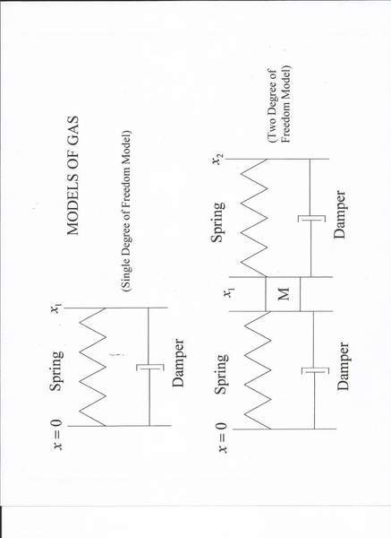

Since you are also referring to chemical reactions as examples of processes under discussion, the following might help.
In the study of chemical reactions, besides thermodynamic considerations, we study kinetics of reactions to arrive at mechanism (Path followed by the reaction in going from a stste A to a state B) of reaction. Unlike the definite (unique) values for changes in the thermodynamic properties, the values of kinetic properties such as rate constants, do not have unique values. We can think of a number of (possible) mechanisms each of which satisfies some of the experimentally observed/measured properties for a given reaction.
In a similar fashion we can give a number of alternate explanations (for the rate of motion of pistion in the presence/absence of friction, whether we call it quasistatic process or irreversible process etc.
In short, uiqueness is lost in rates of processes - plurality of paths connecting two given states becomes possible, which is not the case with thermodynamics of the process. Thermodynamics gives 'yes' or 'no' type of answers ( a process is either reversible or irreversble - no plurality of answers!) with 100% certainity.
In essence, even if we arrive at a possible explanation of how the piston (whether massless or otherwise) moves, with some model for viscocity, pressure distribution etc of the gas, it will not be unique - there exists no way we can prove that it is the correct or unique path the process followed.

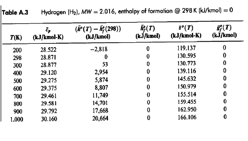

Unfortunately the book I have doesn't say much about the second law, just stuck in two equations in an example that computes product entropy (species and mixture) attached. The plot given was w.r.t. S of the mixture. It seems most books just state the enthalpy/entropy fundamental equations as facts without much explanation.
If both enthalpy/entropy of formation are independent of pressure, does this mean that if temperature is kept constant, the enthalpy/entropy of formation of any substance is constant w.r.t pressure (i.e. forming CO2 at 1atm or 100atm releases the same amount of energy)?
Thanks very much

No doubt, we have been designing and operating equipment and processes in everyday practice. However, for each of those designs, we can have several alternate possible designs, the design takes several other factors (such as financial aspects) into consideration. Suppose we ask if a given design for a process is unique - do we get the answer, yes or no? We don't.
In contrast, thermodynamics of a process yeilds unique results/answers. For example, for questions such as: Can the system reach state B spontaneously from state A? we have unique answers, whereas, with regard to rate processes we can not get such unique answers.
rkmurty
Sorry your book doesn't do a good job. I looked over the excerpt you sent, and it (at least) looks correct. What they are trying to do is calculate what the entropy of the reaction mixture would be at various conversions. The conversion that maximizes the entropy for this isolated reacting system is the one that corresponds to the equilibrium conversion.
It's not quite correct to say that the enthalpy/entropy of formation are "independent of pressure." Both the enthalpy of formation and the entropy of formation occur at a constant pressure of one atmosphere. For an ideal gas, the enthalpy is independent of pressure, but the entropy definitely depends on a pressure. After the material is formed from the elements at 1 atm. pressure, if the pressure of the species changes, its entropy changes.
Was the equation used for the plot the absolute entropy, since the reference entropy is on the right side of the equation?
Chet
For ideal gases, both its enthalpy and enthalpy of formation is pressure independent but the entropy of formation is pressure dependent? Most examples I found conveniently had reactions at 1atm, but if a reaction is at some other pressure can I use the same enthalpy/entropy of formation?
I'm also curious of the way absolute enthalpy is defined. Given absolute enthalpy = enthalpy of formation at (Tref, Pref or 298K and 1atm) + sensible enthalpy. I noticed that enthalpy of formation at (Tf, Pref ) is much lower than the absolute enthalpy at (Tf,Pref) from using the proper equation. Is there a reason why we assume the formation occurs at some standard state (seems a bit arbitrary) and heated to the final temperature as opposed to forming directly at Tf,Pref, which gave the wrong result?
Thanks very much
When I hear the term "absolute entropy," I think of a reference state at absolute zero temperature. I don't think this is what you mean. The entropy on the left side of the equation is the entropy of the mixture, relative to the combined entropy of the pure components (separated) and each in its reference state of 1 atm and 25C.
The entropy of formation describes the change:
Equilibrium State 1: Pure elements in stoichiometric proportions at 25 C and 1 atm
Equilibrium State 2: Pure compound at 25C and 1 atm
As with any system, to determine the entropy change, you would have to identify a reversible path between state 1 and state 2, and then determine the Q for the path.
Yes. In the examples, the total pressure was constant, but not the partial pressures of the various species. The term involving partial pressure in your equations for the individual species partial molar entropies takes into account the difference between the total pressure and the partial pressure of the species.
I don't quite understand this question. The reason for using a reference state is so we don't have to tabulate the enthalpies of the species at every temperature. All we need to do is provide the enthalpy of formation at one temperature (the reference temperature), and provide the heat capacity of the species. I'm sure you already knew this.
Chet

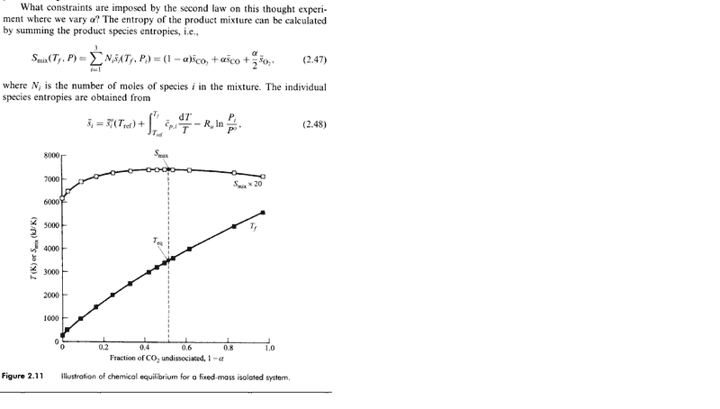

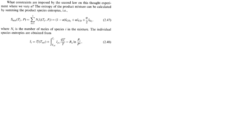

With regards to the equation:
s_i = s_i^o (Tref) + ∫c_p\frac{dT}{T} - R_uln(\frac{P_i}{P^o})
I took the latter two terms to represent entropy change from the reference state to the final state, and the first to be the formation entropy. I also assumed that the first term to be an absolute entropy (from absolute zero) such that s_i is now relative to absolute zero, is this correct?
It doesn't matter, as long as everything is done consistently. You can take s_i as the entropy of the pure species relative to absolute zero, or you can take the entropy of pure elements at Tref as zero. Either way, you get the same answer for changes in entropy.

  • #67
In this response, I will be referring to the attachment below:
https://www.physicsforums.com/attachment.php?attachmentid=70091&stc=1&d=1401192844
Red_CCF said:
In the situation I was thinking, the piston wouldn't be stopping and going at every dP addition. I was trying to avoid the constant back and forth switch between kinetic and static friction, which means that the piston is constantly accelerating up to the end of the compression. The force balance I came up with was:
APext + AdP + mg - k|(x-x0)| - Fkin = ma
I am not sure if the above is correct or how I would solve this to get the velocity at the end of the compression.
In the attachment, I have included two "models" of the gas behavior to help is quantify our discussion. The first model has one degree of freedom, and features a spring in parallel with a damper (the combination is commonly referred to as a Voigt element). The spring simulates the local p-v-t behavior of the gas, and the damper simulates the viscous dissipation. The parameter x1 represents the displacement of the piston.
The second model has two Voigt elements, with a mass in-between (simulating the mass of the gas). This model has two degrees of freedom. In this lumped model, x2 represents the displacement of the piston, and x1 represents the displacement half-way through the gas. The stiffness of the springs and the damper constants in this model are not the same as for the single degree of freedom model, but are appropriately adjusted to give equivalent behavior.
In my responses in this posting, we will be focusing exclusively on the first model. Later we can get to the second model, if necessary.
For the single degree of freedom model, the force balance just before static friction releases would read :
APext+ mg + kx10 - Fstat = 0
where x10 is negative to represent initial compression of the gas.
I'm going to stop here for now, and give you a chance to digest the gas models, and ask questions.

Is there a reason why we are adding a damper? If we assume that there is always a dP difference between Pext and Friction + PI (the system is able to pull back force once static gives away to kinetic friction), the process should be quasistatic so would the "damping" effect from viscous stresses would be zero and are we just doing a general case where we can set the damping to coefficient to zero for the quasistatic model?
If the piston was massless, can we just set m = 0 of the general solution or does it affect the fundamental setup in some way?

I was referring to ΔS of the mixture. For the formation of water H2 + 1/2O2 -> H2O, assuming the process goes to completion with no dissociation and initial and final equilibrium temperatures are the same at 298K (and constant pressure), the entropy of formation so(Tref) for the reactants is 130.595 + 205.043*0.5 = 232.52kJ/molK but for the product (just water) it is 188.715kJ/molK and the two doesn't cancel. In this case the absolute entropy = entropy of formation so had I used the entropy of each species as relative to its reference state entropy, I should have gotten zero for both (and ΔSmix = 0)?
Thanks very much
  • #70
In recent posts, you were referring to the effects of viscous stresses, and to pistons with mass that accelerate. So to try to address these all at one time (rather than bouncing from one to the other), I thought it would be better if we got a little more general. We will be solving several cases. Is that OK with you?
These entropies are absolute entropies. The difference between the 188.715kJ/molK and the 232.52kJ/molK is the change in entropy as a result of reaction, in going from pure oxygen and pure hydrogen at 298K and 1 atm to pure water at 298K and 1 atm.

Chet
  • #72
Chet
So does this mean that the absolute entropy must always be used, and we must never use entropy that is w.r.t. the reference state/entropy of formation (298K, 1atm) as the ΔS of the reaction becomes 0 in the above case?
No. We could have taken the entropies of formation of the elemental species to be zero at 298 and 1atm, in which case the entropy of formation of water in the reference state would have been 189-233 = -44. In this approach, the free energy of formation of the water (from the elements) in the reference state would have been -241826+(298)(44), where the -241826 is the heat of formation of the water (g) in the reference state. If we are working with the equilibrium of chemical reactions, it is important to know the free energies of formation of the species in the reference state, and the enthalpy of formation in the reference state (the latter to get the temperature dependence of the equilibrium constant). The entropy of formation is secondary to this exercise. However, if we are using the entropy of formation to calculate the free energy of formation, the reference state for entropy and for free energy of formation must be consistent.
In the first equation, at the instant the friction switches to kinetic, is the LHS = dP such that dP = -m\frac{dx^2}{dt^2} (difference between applied pressure and sum of system forces)?

I didn't word that question very well. I was really wondering how adding the reactants too quickly or not removing the products fast enough from the reaction chamber will lead to irreversibilities?
Chestermiller said:
I'm puzzled by all this. The free energy, enthalpy, and entropy at the reference state have to be related by:
gref=href-Trefsref
If gref and href of the elements are zero at the reference state, then sref also has to be zero. The g, h, and s of formation of the elements vary with temperature, but at the reference state, they are taken as zero. The g, h, and s of formation of compounds also vary with the temperature, but at the reference state, they are not zero. I wish I could see your table so I could understand better.
I have attached part of the table for H2. I am probably missing/mis-interpreting something. I believe that the entropy give is absolute while the free energy and enthalpy of formation are relative to the reference state; however it seems the book on purposely chose not to term the entropy as "formation" (with subscript f). I believe that the so(T) in the table is the same as that in the equation in the second attachment.

The attachments didn't attach for some reason.
I'm not familiar with what they are doing in these tables, and need more context. What they're doing seems very confusing to me, and apparently it has confused you also. Here's what several texts that I have access to do:
Smith and Van Ness, Introduction to Chemical Engineering thermodynamics:
The standard heat of formation of a species is equal to the change in enthalpy in going from the elements to the species at 1 atm and temperature T.
The standard heat of formation of a species in the reference state is the standard heat of formation at 298.
The standard heat of formation of the elements is equal to zero in the reference state.
The standard free energy of formation of a species is equal to the change in free energy in going from the elements to the species at 1 atm and temperature T.
The standard free energy of formation of a species in the reference state is the standard free energy of formation at 298.
The standard free energy of formation of the elements is equal to zero in the reference state.
Perry and Chilton, Chemical Engineers' Handbook
Same as for Smith and Van Ness
Hougan, Watson, and Ragatz, Chemical Process Principles
Heats of formation handled the same as previous two references.
Standard Molar Absolute Entropies used to get entropy change for a reaction in the reference state (298, 1 atm).
Standard Molar Enthalpies and Entropies used to get change in free energy for a reaction in the reference state.
Standard free energy changes (1atm) for reactions at other temperatures calculated from \frac{d(ΔG^o/RT)}{d(1/T)}=\frac{ΔH^o}{R}
I'm not sure if they help but I have attached the cover sheet of the appendix which outlines the source and calculation method that is slightly different than the above. It appears that the entropy value is absolute and at least close to some other ones on the internet; however I am not sure why it is varying with temperature while the enthalpy/free energies do not.

Red_CCF said:
From assuming Δx = 0 and d(Δx)/dt = 0 at t = 0, for the constants I got:
c_1 = \frac{(F_{kin} - F_{stat})(1-\sqrt{1-\frac{4mk}{C^2}})}{2k\sqrt{1-\frac{4mk}{C^2}}}
c_2 = \frac{(F_{stat} - F_{kin})(1+\sqrt{1-\frac{4mk}{C^2}})}{2k\sqrt{1-\frac{4mk}{C^2}}}
I'm not sure if I'm doing this correctly, but the square root would be linearized, for f(x) = \sqrt{1\pm x} :
L_1(x) = \sqrt{1-\frac{4mk}{C^2}} - 1/2(x-\frac{4mk}{C^2})(1-\frac{4mk}{C^2})^{-0.5} for \sqrt{1-\frac{4mk}{C^2}}
and
L_2(x) = \sqrt{1+\frac{4mk}{C^2}} + 1/2(x-\frac{4mk}{C^2})(1+\frac{4mk}{C^2})^{-0.5} for \sqrt{1+\frac{4mk}{C^2}}
I've corrected some sign errors in the equations for c1 and c2 (the discriminant should have a minus sign; I also made this same typo in one of my previous responses).
Linearizing the equations with respect to \frac{4mk}{C^2} involves making use of the following linearization approximations:
\sqrt{1-x}≈1-\frac{x}{2}
\frac{1}{1-x}≈1+x
After applying these approximations, I obtain:
Δx_1≈-\frac{(F_{stat}-F_{kin})}{k}\left[\left(1+\frac{mk}{C^2}\right)(1-e^{r_1t})-\left(\frac{mk}{C^2}\right)(1-e^{r_2t})\right]
where, in this linearized approximation,
r_1≈-\frac{k}{C}\left(1+\frac{mk}{C^2}\right)
r_2≈-\frac{C}{m}\left(1-\frac{mk}{C^2}\right)
Note the similarity between this solution, and the solution obtained when m = 0. In both cases, the piston displacement at long times Δx1 is exactly the same value. Note also that for small values of \frac{4mk}{C^2}, the piston does not oscillate, but its displacement simply increases monotonically and asymptotically to the final value.
Chet
  • #93
The entropy, enthalpy, and free energy of a pure substance at constant pressure all increase with temperature. I looked over your Tables A1 and A2 description, and can see what they are doing.
My understanding of the variables is as follows:
\bar{h_i^o}(T)=enthalpy of pure species i at 1 atm and temperature T
\bar{h_i^o}(T_{ref})=enthalpy of pure species i at 1 atm and temperature Tref
\bar{h_i^o}(T) and \bar{h_i^o}(T_{ref}) are related by:
\bar{h_i^o}(T)=\bar{h_i^o}(T_{ref})+\int_{T_{ref}}^T{\bar{c}_p(T)dT}
These equations apply both to the elements and to compounds. However, for the elements at Tref, \bar{h_i^o}(T_{ref}) is taken as zero.
\bar{h_{f,i}^o}(T)=heat of formation of pure species i at 1 atm and temperature T from the elements. If
\bar{s_i^o}(T)=absolute entropy of pure species i at 1 atm and temperature T
\bar{s_i^o}(T_{ref})=absolute entropy of pure species i at 1 atm and temperature Tref
\bar{s_i^o}(T) and \bar{s_i^o}(T_{ref}) are related by:
\bar{s_i^o}(T)=\bar{s_i^o}(T_{ref})+\int_{T_{ref}}^T{\frac{\bar{c}_p(T)}{T}dT}
\bar{g_i^o}(T)=free energy of pure species i at 1 atm and temperature T
\bar{g_i^o}(T_{ref})=absolute entropy of pure species i at 1 atm and temperature Tref
\bar{g_i^o}(T)=\bar{h_i^o}(T)-T\bar{s_i^o}(T)
This all looks pretty straightforward. Does this help answer your questions?
\frac{1}{1-x}≈1+x
Chet
Is there a restriction somewhere that mk/C^2 be less than 1?

With regards to the entropy equation, is there supposed to be a pressure component on the right hand side as well?
My main confusion is that they apparently put absolute entropy values next to enthalpy and free energy that is w.r.t the reference state. Is there a general relationship between the absolute entropy in the table and the entropy of formation, as I expect that for elements that 0 = 0 - T*0 (Gf = Hf - TSf)?
How come that entropy here is temperature dependent but Gf and Hf are not? Are the formation entropy, enthalpy, free energy values in general dependent where we set the reference state (T,p)?
No, but we are just trying to address some the doubts you had regarding the transition from small finite piston mass to the limit of zero piston mass, such as:
1. How can you have an accelerating piston if the piston mass is zero?
2. Does the piston oscillate if its mass is very small, but not zero?
3. Is the transition smooth from small finite piston mass to zero piston mass?
This solution answers all these questions.
We can continue the solution to larger mass, if you'd like. If mk/C^2 is equal to 1, the system is critically damped. If it is greater than 1, then the system may oscillate, depending on whether static friction is re-established at the moment that the piston reaches its maximum compression (for the first time).
Those superscript o's refer specifically to the "standard state" where the pressure is 1 atm.
The approach they've described in your book is very confusing, as evidenced by the fact that it has even confused a smart guy like you. I even find it a little confusing myself, and would never work with the kind of notation that they have used. Here is that approach that I learned.
1. Let h(T,p), s(T,p), and g(T,p) represent the enthalpy, entropy, and free energy of a pure species at temperature T and p.
2. Let h°(T), s°(T), and g°(T) represent the values of h(T,p), s(T,p), and g(T,p) at p = 1 atm
3. Let h°(298), s°(298), and g°(298) represent the enthalpy, entropy, and free energy of formation of the pure species from its elements at 298 K and 1 atm. So, for an elemental species, h°(298), s°(298), and g°(298) are equal to zero, and for a compound, they are not. In the case of the entropy of a compound, for example, s°(298) = (absolute entropy of compound at 298 and 1 atm) - (absolute entropies of elements comprising the compound at 298 and 1 atm).

My current understanding is, there are three sets of properties to consider, absolute h, g, s (relative to absolute zero), relative ho,go,so (relative to standard state 298K, 1 atm), and also formation hf, gf, sf, which is found from the formation reaction of a compound. If this is correct, then is it true that:
1. The formation h,g,s are independent of the reference state and I should get the same value whether absolute or relative h, g, s are used (and for water was calculated as -44kJ/kmolK) as it appears to be the difference of reactant and product h, g, or s?
2. Assuming absolute properties are used, Δhf = ∑nihprod - ∑nihreac (and the same for Δsf and Δgf ) and h,g,s here can be either relative to absolute zero or reference state and reactants are elements only
3. I take the standard state ho = 0 (formation) + hsensible for elements in their natural state and using this as reference, ho = hf + hsensible for compounds, where sensible heat = 0 at 298K (and same for go and so). For converting absolute and standard state properties, for enthalpy would it be habs = ho + c_p(298-0).
4. For elements at absolute zero, I assume that absolute h, g, s are zero, but does this hold for compounds?
5. How come in the entropy equation there is a -Rln(P) as opposed to a ratio of P_i/P_o as in my book?
I can't follow all the notation, so I'm going to take another shot at explaining it in the (simpler) way that I understand it. I hope this works for you.
Let's first focus an a compound, rather than an element. Let's talk about two equilibrium states:
State 1: The separate pure elements comprising the compound in stoichiometric proportions (to produce 1 mole of the compound) in their natural states at 298 and 1 atm. Let's call this the standard reference state.
State 2: The compound at temperature T and pressure p.
Let h(T,p) represent the change in enthalpy between State 1 and State 2. From now on, we will call this simply the enthalpy of the compound. The same goes for s(T,p) and g(T,p).
Now for an element:
State 1: The pure element in its natural state at 298 and 1 atm.
State 2: The pure element at temperature T and pressure p.
Note that
h(298,1 atm)= 0
s(298,1 atm) = 0
g(298,1 atm) = 0
In addition, we define the following for states at 1 atm (we call states at 1 atm standard states, and use a superscript o to identify them):
h(298,1 atm) = h°(298) = standard enthalpy of compound or element in the reference state = standard enthalpy of formation of compound or element in the reference state
h(T, 1 atm) = h°(T) = standard enthalpy of compound or element at temperature T.
∑nih°(T)prod - ∑nih°(T)reac= standard heat of formation of compound or element at temperature T
The same definitions apply to s and g.
No. There is an entropy change involved in forming the compound.
I was assuming that the pressure was expressed in atm, and that P_o was 1 atm.

Using the above notation, from what I understand:
h(T,1atm) = ho(T) = hformation + hsensible = ∑nih°(T)prod - ∑nih°(T)reac + cp(T-298)
No. It's
h(T,1atm) = ho(T) = hformation(298) + hsensible = h°compound(298) - ∑nielements(298) + cp(T-298)=h°compound(298)+ cp(T-298)
So h(T,p) from the above notation is not absolute enthalpy of a compound or element, its reference is still set at standard state, but is the difference here that ho essentially a subset of h(T,p) and equivalent to h(T,p = 1atm)?
Yes.
If I were to define an absolute enthalpy, habs(T,p) reference at absolute zero, can I expect ∑nihabs(T)prod - ∑nihabs(T)reac to be the equal to the heat of formation in the last line above? If so, does this mean that habs(T,1atm)= h°(T) + ∫c_pdT (integral from 0 to 298K)?
Well, since the last line above was not correct, and it's not a heat of formation, I don't know how to address these questions.
Is the absolute enthalpy (and therefore free energy) and formation enthalpy also equal to zero for elements and compounds?
I don't know exactly how to answer this question because I don't understand it. But, in the framework that I've described, the enthalpy of formation, entropy of formation, and free energy of formation of the elements at 298 and 1 atm are zero. The enthalpy of formation, entropy of formation, and free energy of formation of compounds at 298 and 1 atm are not.
Outside of the beginning and the end, why is it necessary to apply a constant small acceleration through the process vs. zero acceleration?
It's not. This was just an example that I conceived of which I thought would help you understand things better. But, if it works better to understand it in terms of your constant velocity example, that's fine with me.
Chet
