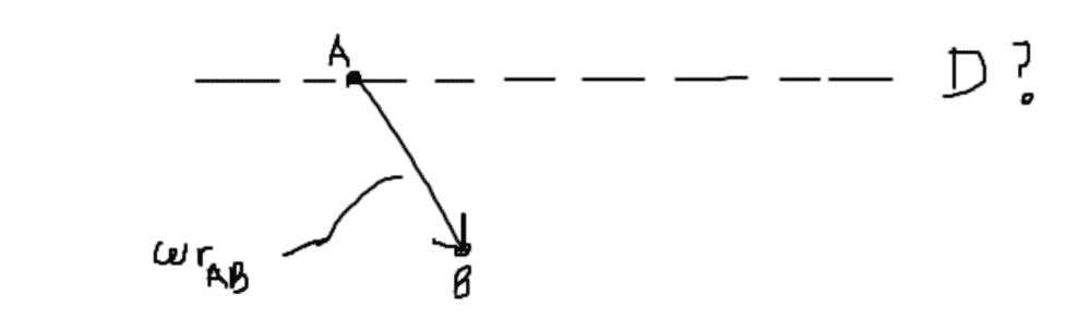

Hi there,
I don't agree with your velocity triangle (I think - it isn't too clear). Specifically the fact that ## V_{BD} ## doesn't start at the end of ## v_B ##. Apologies if this is understood, but I understand ## v_{BD} ## to be the "velocity of D relative to B" and thus the vector ## v_{BD} ## should start at the end of ## v_B ##. (EDIT: maybe the convention I have learned is back-to-front, but either way the velocity should not start at the same point where B starts)
The way I would attempt this problem is:
1. Draw ## v_B ## (which you have done)
2. Draw a line that indicates the range of possible motion of D.
What does that mean?
If D is constrained to move horizontally, then you know that ## v_D ## must lie in the horizontal plane, so you can just draw a dotted line extending in both directions to denote that we expect D to be somewhere along that line. (Same idea can be applied for any type of directional constraint)
So your diagram will look something like. I have purposely left out the angles.

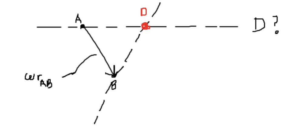

3. We know B and we want to find where ## D ## is - we need another vector (## v_{BD} ##) to fix this point. So now let us imagine we are rotating the crank in the CW direction. If we are stood at B, then which direction will D appear to be rotating (relative to B)?? If you aren't sure, then you could do another dotted line to allow for rotation in either direction. Then draw this vector/line starting from B. Now you should have an intersection between the two lines along which D can lie and thus you can find D.
Echoing sentiments from @haruspex and @Lnewqban above, it would be very helpful if you can post a picture of the actual physical mechanism. Just so I don't misinterpret the actual situation.
Hope this was of some help. Some details with drawing the velocity triangle have been left out as it is somewhat tedious to explain it all in a post if you already understand it.
