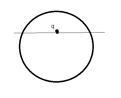

I have another question regarding electric fields:
If we place a conducting balloon in an electric field, and the outside field is pointing to the left. There will be an induced polarity with the negative charges clumping to the left side. It is observed that the balloon moves to the left. WHY does it do this? The superposition of the two fields shown is 0? - unless the outside field is "stronger" than the inside because the balloon "runs out" of electrons.
Here is another problem:
The inside of the balloon contains no charges. So if we apply Gauss's law, there will be no E field. But in this situation, there is clearly an E field.
  • #37
The static field inside the metallic balloon is zero everywhere.
The sum of the external field and the fields caused by the redistribution of charges exactly cancels.
This is true for any volume enclosed by a conductor, regardless of its shape.
See https://en.wikipedia.org/wiki/Faraday_cage .
  • #38
No there isn't. You haven't drawn it correctly.
Draw an insulating balloon in an external e-field. You'll find that the e-field passes right through the balloon since the charges making up the balloon cannot move about.
If I suddenly turn the balloon's material into a conducting material, the charges are now free to move about and will redistribute themselves. They will move until their own electric field exactly cancels out the external e-field inside the balloon.

  • #39
Yes, the negative charges in the conducting material of the balloon will move towards the field lines, and leave the positives behind. This leads to a field inside the conductor (from positive to negative charges) that cancels out the outside field. So how did I draw it incorrectly?
  • #40
There isn't a field inside the balloon so you shouldn't have any arrows inside the balloon. The field set up by the balloon's charges opposes the external field and cancels it, so if you're drawing the overall electric field then you would not have any arrows inside the balloon. Note that Gauss's law is about the net flux through a closed surface. Inside the balloon the flux through a closed surface is always zero, regardless of whether or not you have an e-field passing through, since there are no charges enclosed. Any field lines passing through one side of this surface simply come out the other, so their overall contribution is zero.

  • #43
Sho Kano said:
so towards either side, there would be a net field pointing to the center?
If that were true then there would be a current.

  • #46
Sho Kano said:
That's very non-intuitive because if a charged particle was closer to one surface (inside the conductor) than the other, I feel like it would experience a net force.
The excess charges do experience a force. The charges force each other away from each other, like a ballon's wall is forced outward when you add more "gas charge" inside the balloon. The main difference between how an excess "gas charge" inside a balloon behaves and an excess electrical charge inside a conductor behaves, is the elastic balloon can stretch; whereas the metallic conductor is crystalline, meaning the conductor's atoms have rigidly fixed positions relative to each other. If the excess charge on a conductor's surface becomes too strong, the resulting E-field will be so strong that it can force the extremely excess charge to leave the conductor's surface and accelerate into the air. That is how a spark is generated.

  • #51
I wouldn't say it is misleading. It is just unfamiliar to you and so you have not yet built up a correct intuition.
