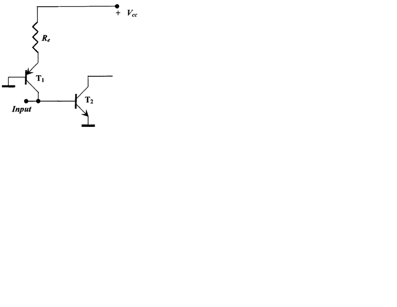

Attached is a picture of IIL (integrated injection logic) cell. I understand the operation of the second (bottom-most) transistor, and analysis of digital circuits is adequate only understanding the operation of this transistor.
I do not understand the operation of the transistor with grounded base. Does it act as some sort of voltage regulator?
Any information, is appreciated.

I don't know the answer to your question, but FWIW, I don't think anybody uses IIL anymore. It was conceived back in the 1970's, and CMOS logic has come so far since those days that I don't know why anyone would care about IIL. Perhaps your question is just intellectual curiosity, but if you are learning about logic families I would suggest focusing elsewhere.
I have received almost an identical response regarding a CMOS inquiry.
IIL has its applications, any information is appreciated.
I read that article and still wasn't sure what the transistor is for.
It isn't wrong - do a google search for images on IIL, you will get as many or more hits of the circuit I posted.
In fact, if it acts as a current source, they would be the same circuit.
any one know if that is the case

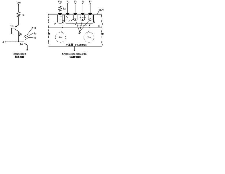

how about the one I've attached.
