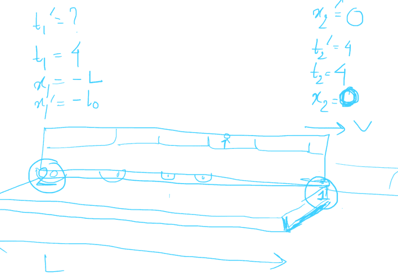

I've taken the coordinates for the front end coinciding with clock 1 to be-
a) (0,4) for both the frames
and the coordinates for the rear end coinciding with clock 2 to be-
a) (-l_o,t1') for the train's frame
b) (-L,4) for the platform frame
Using these coordinates and applying the Lorentz transformations, I arrive at this result, as shown in the pics. Is this correct?
The origin must be ##(0,0)##, by definition. The Lorentz transformation won't work with ##t =4## at the origin.
You've drawn the scenario in the platform frame. What about the train frame?
The results are hard to read. They don't look right at all.

But, I've taken into account the change of frames, right? I've used the inverse of the Lorentz matrix in this case.

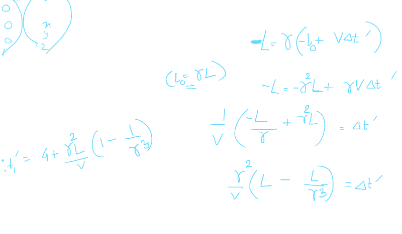

Ok, so I'm totally confused now. If I use the time transformation, I arrive at-
If I use the space transformation equation, I arrive at a different answer (which I posted just some time ago). Why is this happening? I don't seem to notice any mistake in any of the approaches, and I'm thoroughly confused.

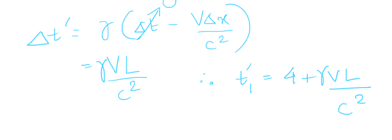

Ok, I panicked here and made a calculation mistake, it does turn out to be ##\gamma vL/c^{2}## using the space transformation as well.
