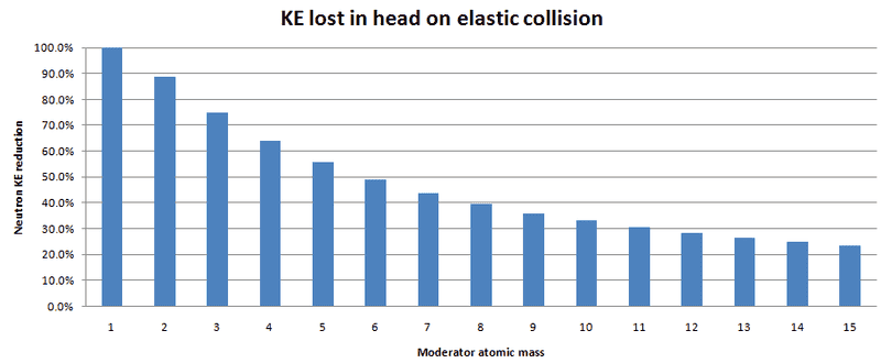

The lighter the nucleus the better the moderating or slowing down capability. A proton is a great moderator since it has roughly the same mass as a neutron. The moderator ratio however suffers because a proton can absorb a neutron and become a deuteron.

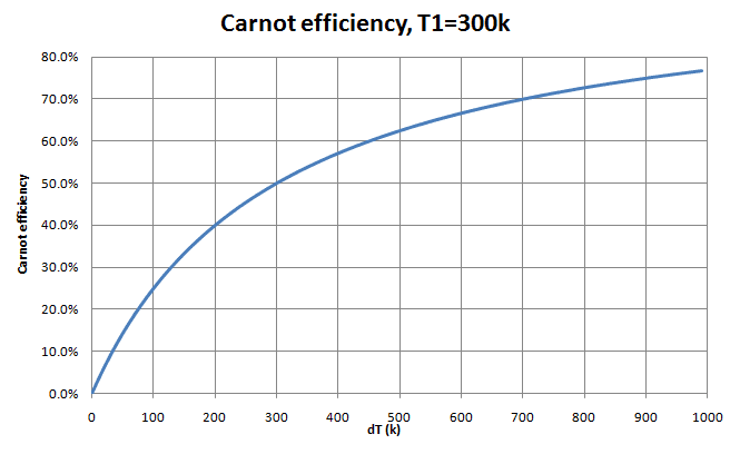

I should have mentioned that the carnot cycle is the most efficient theoretical heat engine, this is never achieved in the real world power cycles but it does stand that a higher dT results in higher thermal efficiencies, for all cycles (thermodynamics 101 really). A high temperature reactor could be used in a bottoming cycle where the heat is first used in high temperature industrial process (eg for hydrogen production) and then leftover heat is used to power a turbine and generator. In this way even higher utilisation of thermal energy can be achieved than in the carnot cycle.

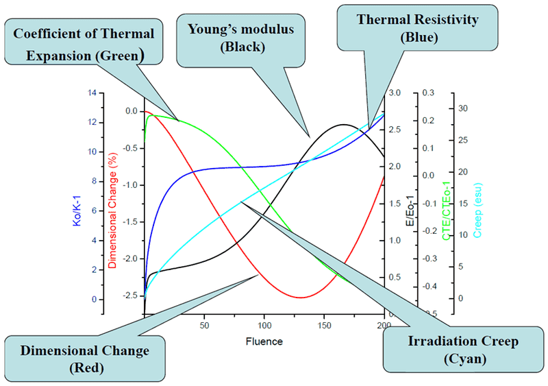

I'm convinced that in the future the industry will move away from water cooled and moderated designs, as all suffer from the high pressure and low temperature limitations. All other designs, gas cooled or molten metal/salt cooled use graphite as a moderator. Graphite moderated designs so far have lifetimes of 40-60 years but after this the graphite deterioration is to severe. It's not fully understood how the graphite changes:
This is for isotropic reactor grade graphite (gilsocarbon) at 450ºC. A better method of implementing graphite as a moderator needs to be devised for cost effective long lived reactors using graphite.
