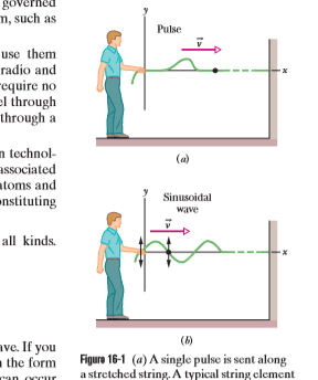

That's interesting. Can you tell me the difference between a zero-frequency zero-energy photon and no photon at all?
Does a wave exist with 0 frequency? If so, should it be just a wave pulse?
No, a wave pulse consists of many frequencies that interfere with each other to form the pulse. A wave with zero frequency can't be called a wave at all because nothing is changing. There is no oscillation, no vibration, nothing.
Based on a picture in book 'Fundamentals of physics', wave pulse does not look like as you said.
I know topic is Em Waves and brought a picture from mechanical waves. But way of imagining even an Em wave look like this only right?
Sure it does. The different frequencies interfere with each other such that they sum to zero or near zero everywhere outside of the pulse.
Thanks for clarification, so there is frequency even in wave pulse.
That's right. Mathematically, any pulse can be broken down into the waves composing it by using a Fourier Transform.

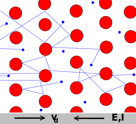

Drakkith said:
electrons are always whizzing about in all directions and current flow is the net flow of electrons in a direction.
Does that mean electrons literally displace and flow?
The frequency of this net flow is the rate of the oscillation in it. The electrons themselves aren't vibrating back and forth at this frequency.[/QUOTE]
Rate of oscillation in what? The whole bunch of flowing electrons? That whole bunch move back and forth as they flow just like a ship sailing back and forth in harsh waters? Then some people say frequency as cycles/sec. Can it be anywhere linked to this?
The electrons in the conduction band of a conductor are constantly moving about within the conductor in random directions and velocities. The electric field of an AC voltage source merely gives this random motion a small net velocity. In other words, more electrons move move one way past a point in a wire over time than in the other direction leading to a net flow of current in the circuit.
The net flow is the sum of all the different velocities and it is this net flow that oscillates in direction and magnitude. Any single electron is not oscillating back and forth.
Thanks for help, Understood what you have said and satisfied.

davenn said:
I have always understood that they are
and to confirm my thoughts I had to go google searching and found at least 4 sites that confirm that the electron/charge IS oscillating back and forward at the freq of concern
do you have something to the contrary ?
Well, my textbook, Semiconductor Physics and Devices, by Donald A. Neamen, gives a short explanation of electric current on pg. 74 and describes drift current as the summation of all the individual electrons velocities, each of which is much larger than the drift velocity that gives rise to current.
Several wikipedia articles also support this. See the following links:
https://en.wikipedia.org/wiki/Drift_velocity
https://en.wikipedia.org/wiki/Electric_current#Metals
Also, see page 3 here: http://alan.ece.gatech.edu/ECE3080/Lectures/ECE3080-L-7-Drift - Diffusion Chap 3 Pierret.pdf
The average instantaneous velocity is extremely large. One of wiki's articles gives a velocity of roughly 106 m/s. In comparison, drift velocity is on the order of cm/s or less.
Likes AlphaLearner
@Drakkith shows a strong evidence that electrons actually flow. Their movement seems back and forth but actually they are moving almost randomly like gas molecules inside a chamber. Probably for our level, the author may have made it simple stating 'You don't have a need for that level of understanding how current flows'. But truth must be known some day...
hang on ... they are all about DC currents, Ohms law and drift velocities ... I have no problem with any of that
and none of those 3 references deny that in an AC (RF) signal that the electrons oscillate back and forward about their general position
if fact I saw no obvious reference to an AC signal regardless of freq
There may well still be a general drift of electrons in an AC (RF) circuit I'm not 100% sure, I have never seen anything to back that up
maybe some one can confirm or deny it. Even if there is, it doesn't mean that in an AC signal the electrons are not oscillating about a point at a given freq be it 50/60Hz mains or in a 10 GHz microwave RF circuit

  • #34
I haven't seen anything that says that drift current only happens in DC circuits, and unless the electric field set up by the voltage source can completely counteract random thermal motion that is supposedly on the order of 1,000 km/s then I can't see how individual electrons would oscillate at all.
  • #35
At most frequencies, there is no difference between AC and DC electron drift.
For simplicity, think of a square wave AC instead of sinusoidal. DC current flows one direction for a while and then the other direction for a while. Normal models of DC electron drift apply. That holds true for all frequencies say from DC (or say 0.00001 hertz) to an high where the wavelength of an AC cycle at approximately 0.8c is comparable to the length of the wire. I don't know the Mhz or Ghz for the upper limit, but it is high. Only above that high frequency limit might it be appropriate to think of electrons vibrating, and at which RF effects begin to show.
Likes davenn
