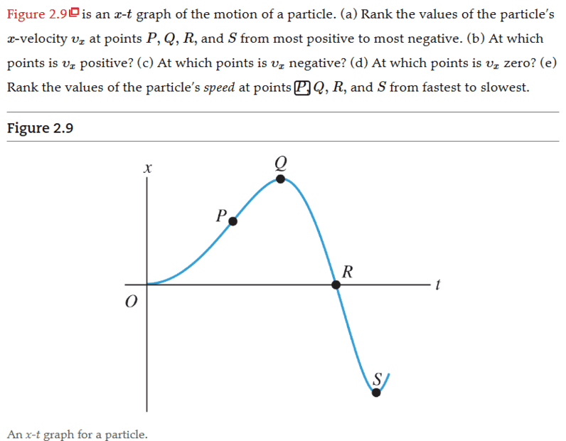

Rating speeds from least to greatest from a position time graph
  • Thread starter Thread starter Ineedhelpwithphysics
    Physics 1 Speed
The ranking of speeds from least to greatest based on the position-time graph is R > P > Q = S. R has a steeper slope than P, indicating a greater speed. P has a positive slope, confirming it has a non-zero speed. Both Q and S have horizontal slopes, indicating no movement and therefore zero speed. The explanations provided for the rankings are accurate.
43
(E) Rank the values of the particles speed at points P, Q, R, S from fastest to slowest
Speed = distance/time
My answer is R > P > Q = S
Since R is more steeper than P the speed is greater, speed is a non-negative unit so i assume that speed of R will be greater than P
Speed of P has a positive slope, also the magnitude is positive.
Q and S are the same due to the fast that they both horizontal slopes which means the object is not moving which means no speed.
This is my work , correct me if i'm wrong, thanks ^^^
Likes PhDeezNutz and Delta2
Ranking and explanations look good.
Likes PhDeezNutz, erobz, Delta2 and 1 other person
