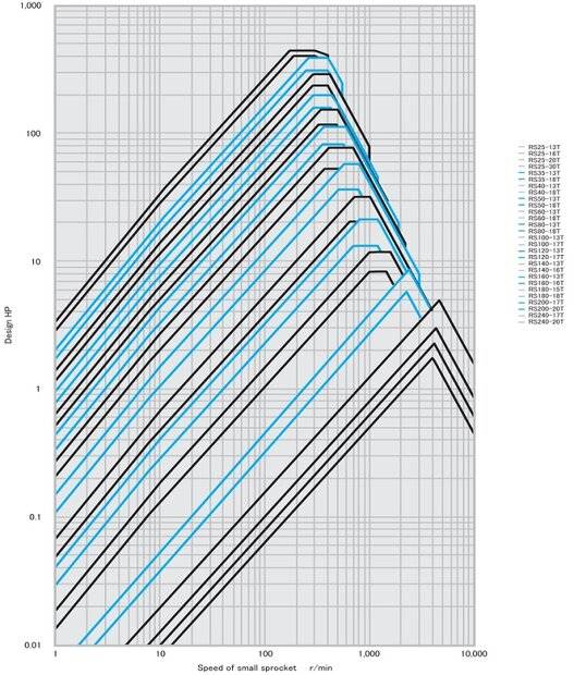

There are a number of variables involved in chain drive design. Search roller chain catalog, then dive into the engineering sections. The U.S. Tsubaki chain catalog is a (not the only) good one. The chart below is from page 253 in the Tsubaki Roller Chain Drive Selection Process section of the catalog.
Read the introductory section starting page 1 of the catalog first, then the engineering section starting on page 251. Study carefully the parts about lubrication vs chain speed.

Minimise the weight. If you know the RPM and HP, use the chart shown in post #3 to select the size of chain required.
Next find an acceptable chain drive ratio, p/q, where p and q are integers.
Make sure that p and q are as small as possible, while both have more than 12 teeth.
