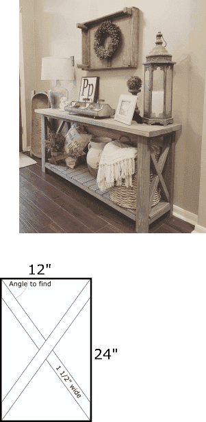

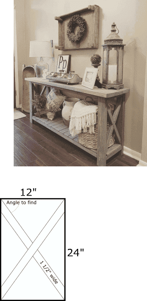

I'm building a bed bench and I have an interesting trig problem that I can't figure out. I have a rectangle with known values and a parallelogram that bisects it with a known width. Like a board. I want to be able to figure out the angles so I can cut it. I want the board to intersect the rectangle in a specific way. I've attached an image as I have no other way to describe this. It feels like this should be solvable. Just not sure how. Any help would be great. Thanks.

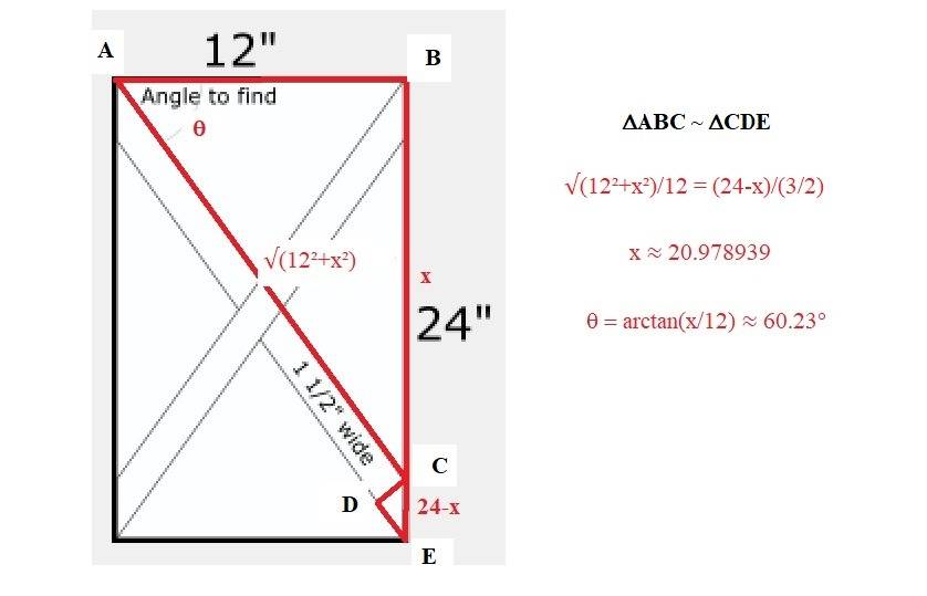

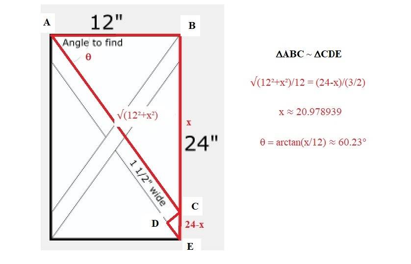

see diagram ...
