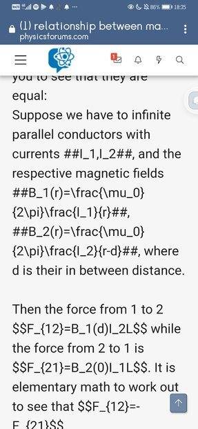

hmmm sorry this Is how it looks like on my phone 😬
Press the refresh page button of your browser.

hmm I don't really get it tho sorry:( can u look at my post 4?
Well it is because if we do the math (which you don't understand but ok I can't do much about it) we end up that both forces are proportional to the product of currents ##I_1I_2##, so it doesn't really matter if the currents are not equal. Both currents contribute to the magnitude of both forces.
