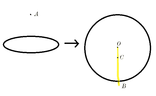

Currently reading Einstein's booklet on SR and GR. At this point SR has been explained but GR hasn't been introduced yet.
The setup is like this: ##A## is present in an inertial reference frame and looking down on a flat rotating disc. ##B## is sitting on the edge of that disc, ##C## is sitting somewhere on the radius connecting the disc's center ##O## and ##B##. Suppose ##B##, ##C## and ##O## each have an identically-constructed clock. From ##A##'s PoV, ##C##'s clock will tick at a slower rate since ##C## has some velocity w.r.t. ##A##. Then it's written that ##O## will obviously see the same slowdown for ##C##'s clock w.r.t. his own clock. This makes sense to me since ##O## isn't actually moving w.r.t. ##A##, so effectively ##O## belongs to ##A##'s reference frame.
Visually I'm seeing it like this:
##A## looks down on the 2D disc. But ##C## and ##B## can only see along one dimension, which is the radius ##OCB## (and that radius extending both ways indefinitely). ##C## and ##B## consider themselves to be at rest. My question is: can ##C## also conclude that ##B##'s clock is ticking slower than his (only using SR-based arguments, since GR hasn't been introduced yet in the text) ?
If ##C## had visibility beyond the single direction I've highlighted in yellow, then I understand he'd be able to somehow measure ##B##'s velocity w.r.t. himself, observe that that velocity is non-zero and hence say that "by SR, ##B##'s clock ticks at a slower rate". But what if ##C## can't see beyond the single yellow-highlighted dimension? Is the only way for him to reach that conclusion is to just watch ##C##'s clock tick rate (as he can't theoretically deduce it)?
Not if they can only look in the radial direction, because light doesn't travel in straight lines in the rotating frame so they can't see each other.
Generally, it depends what you allow ##B## and ##C## to consider. The simplest way is to calculate the interval along their worldlines during one orbit. Since that's an invariant, if the intervals are different their clock rates must be different. If you want an experimental procedure, have ##B## send ##C## a light pulse and vice versa; confirm that the Doppler factors are reciprocal.

If ##B## can send ##C## a light pulse, then ##C## should be able to see ##B## I think? Maybe by the first paragraph you meant that if ##B## is only limited to sending light pulse along the radial direction?
In the last paragraph then I'm assuming that ##B## sends a light pulse in all directions and one of them reaches ##C## - so ##C## realizes that that pulse came from ##B##. They can initially agree about the wavelength of pulses ##B## will send, and ##C## can figure out relative velocity of ##B## based on the observed wavelength of ##B##'s light pulse. That sounds fine or have I oversimplified it?

Yes - you said they could only look along the yellow line, which is radial. But light doesn't follow a radial line from ##B## to ##C##, so the pulse will come in from an angle to that yellow line - so won't be seen if you're only looking along the line.
I think that's right, if you're allowed to assume that ##B## and ##C## are fixed to the disc. I haven't actually done the maths so it's always possible I've overlooked something, but I don't think so.
This is not helpful, as mentioned above. I won't include this restriction.
Yes, since both ##C## and ##B## are at rest in the rotating frame they have ##dr/dt=d\phi/dt=dz/dt=0##. So with ## ds^2 = -c^2 d\tau^2## we have the time dilation is $$\frac{1}{\gamma}=\frac{d\tau}{dt}=\sqrt{-\frac{ds^2}{c^2 dt^2}}=\sqrt{1-\frac{r^2 \omega^2}{c^2}} $$ So rotating frame observers agree that clocks at rest at larger ##r## tick more slowly compared to the coordinate time.

So then C should observe B moving at a non-zero velocity w.r.t. him (in the direction of rotation)
##C## is non inertial, so you have to be clear what frame you mean by “w.r.t. him”. The meaning is ambiguous for ##C##.
If you use the reference frame that I described above, then the statement is simply false. In that frame ##B## is not moving (nor is ##C## obviously).
sphyrch said:
And because of this, having knowledge of SR, they should at once know that the other's clock is ticking slower compared to theirs
Even if you did find reference frames that match the description, your conclusion would not follow. Those reference frames are non-inertial. So the time dilation may depend on position and direction of travel. If you work it out correctly, as I did above, it will not be symmetrical.
Likes PeroK and sphyrch
  • #33
sphyrch said:
So then ##C## should observe ##B## moving at a non-zero velocity w.r.t. him (in the direction of rotation), whereas ##B## should notice ##C## moving at non-zero velocity (in the opposite direction of rotation).
You have to define a reference frame to determine motion. B and C are just points, that don't define unique axes.
If a reference frame is not inertial, you cannot apply formulas that were derived for inertial frames only.
Likes Vanadium 50, Sagittarius A-Star, Ibix and 2 others

Sorry for the delayed response. So then it seems that there's no way to theoretically conclude that ##B## and ##C## clocks are ticking at different rates based solely on SR. Either they'll have to do measurements using, e.g. , ring laser gyroscopes, OR the equivalence principle will need to be invoked (from which GR seems to follow anyways)
The reason I even asked for a purely SR-based argument in this thread is because of this paragraph in the text I'm reading
As judged from this body, the clock at the centre of the disc has no velocity, whereas the clock at the edge of the disc is in motion relative to К (this is ##A##'s (inertial) frame) in consequence of the rotation. According to a result obtained in Section 12, it follows that the latter
clock goes at a rate permanently slower than that of the clock at the centre of the circular disc, i.e. as observed from ##K##.
It is obvious that the same effect would be noted by an observer whom we will imagine sitting alongside his clock at the centre of the circular disc. Thus on our circular disc, or, to make the case more general, in every gravitational field, a clock will go more quickly or less quickly, according to the position in which the clock is situated (at rest).
I know the last line is true, but I'm not sure one can deduce that purely based on whatever was written before that in the quote, based on SR only (which is what was discussed in the book till that point). Hence the confusion. Maybe the last line in bold was sort of conceptual leap of faith?
Yes, you can. But the definition of "more slowly" that is being used is that of a specific inertial frame, the one in which the clock at the center of the disk is at rest.
