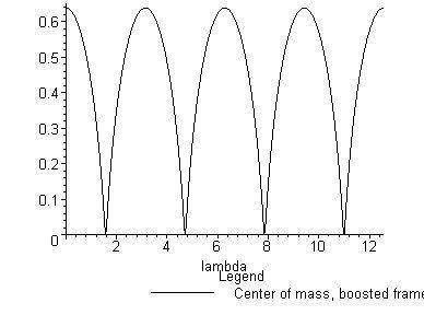

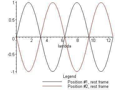

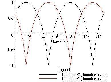

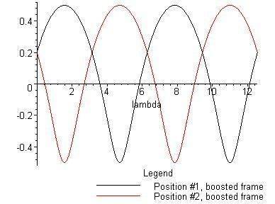

Physicsguru said:
Suppose that in a frame of reference where the center of mass is at rest, and the location of the number 8 on the surface of the solid spherical billiard ball is at rest, the rest mass is exactly m0. What would be the total inertial mass of the billiard ball in a reference frame in which the center of mass was at rest, but the number 8 was orbiting the center of mass with tangential speed v?
Only one of these can be an inertial frame in which the laws of SR apply, the other must be an accelerating frame in which they don't (I'm not sure what laws apply to rotating frames in relativity). Which one are you assuming is the inertial frame?
If the "orbiting" frame is artificial then it isn't an IRF, so in order to get the number 8 to rotate about an axis, somehow energy got put into the system to get it to spin.
In other words start off with an IRF being the one in which the center of mass is at rest, and all the parts are at rest, so therefore the number 8 isn't spinning in this frame. Since all the parts are at rest, and remaining at rest in this frame, this frame is surely an inertial frame. Now, we want to get the number 8 to start orbiting an axis of rotation in this frame, which we know is inertial. The only way to do that is to have an external source spin the eight ball. By stipulation there is nothing external to the eightball, so there can be no external source of energy to get it to spin, so let's modify the problem somewhat.
Assume that there is one and only one net external force which briefly acts upon this eight ball, to get it to spin, and that after this external force acts upon the eight ball, the number 8 now has a tangential speed of V, in this IRF.
What is the inertial mass of the eight ball now, after this external energy entered the eightball system?
