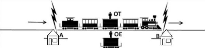

One observer OE, is on the ground, we take him as the fixed frame of reference.
The other OT is on the train that is moving relatively to the OE at a costant velocity ( they are both inertial frame of reference).
So, two lighning strike the two points A and B when the train is with back and end in the same points ( A and B) and the two observer are aligned.
The observer OE is at equal distance from A and B, so the light, which travel at constant speed c, arrive at the same time at his eyes, the two events are simultaneous.
The observer OE anyway see OT traveling to B and move away from A, the speed of light is always c, so he conclude that OT observers first the light from B and then the light from A.
The result: OT see first ligh from B and then from A in his frame of reference.( like what think OE)
I agree with that, but now there is the problem( more than one):
1- If the speed of light is the same in EVERY inertial frame of reference, in the reference of OT that speed is c, so i think when the two lightning strike in A and B, they are equal distance from the center where there is OT 'cause the first assumption (when A and B are ALIGNED) so i think light will arrive at OT at the same time also in his frame of reference, if i don't observe that i think light speed is greater than c from B to OT and lower from A to OT, but this is a contradiction, and I don't understand how to escape from that my surely wrong interpretation.
2-If A and B are fixed with OE, and they arrive at OE in the same time, when I am OT, I see OE traveling in the opposite direction so I see light from A arrive first to OE and the B, ( because always c is the speed of light), but in this case OT see the "same" event but from different perspective and this for me is clear, also with Minkowskii diagrams, i see two events simultaneous for OE and for the OT perspective they're not.
3-If A and B are fixed with OT, they are simultaneous for OT but OE see what the original experiment say: OT see first A and then B, this time I am totally agree with that.
So what is the difference between 1 and 3, and why if the speed of light is the same, c, OT see first B and then A, if they are aligned and equal distance from OT.
Thank for answer.

You are making an incorrect assumption here. The two light pulses arrive to OT at the same time if all three of the following conditions are met:
IF
1) OT is equidistant from where the flashes occurred
AND
2) The speed of both flashes are the same
AND
3) The flashes occurred at the same time
THEN
The flashes arrive at OT at the same time
We know that 1) and 2) are true, but we do not know 3). In fact, since we know that the flashes do not arrive at OT at the same time, we know that at least one of 1), 2), or 3) must be false. And since we know that 1) and 2) are true, that implies that 3) must be false.

I'm not sure I really understand your question. One of the things I think is most important in learning SR is to be able to transform an experiment (set of events) from one reference frame to another. In this case, let's first describe the experiment in the platform frame:
1) Platform Frame of reference:
There are two markers on the platform at points A and B. These are a distance ##L## apart, say.
The train has length ##L##, so that the front of the train is at ##B## when the rear of the train is at ##A##. We can call this time ##t = 0##.
At ##t = 0## two lightning strikes hit ##A## and ##B## (and the front and rear of the train).
NOTE: the time of both events in the platform frame is ##t = 0##.
At time ##t = L/2c## the light from the lightning strikes reaches the midpoint between A and B, where OE is standing. NOTE: this is largely irrelevant.
2) Train frame of reference.
The train is longer than ##L## (as it is length contracted in the platform frame).
The distance between A and B is shorter than ##L## (as the platform is length contracted in the train frame).
When the front of the train is at ##B##, the rear of the train is still not at ##A##. The point ##A## is somewhere near the middle of the train. Because the train is (much) longer than the platform.
At this time, let's call this time ##t' = 0##, a lightning strike hits B (and the front of the train).
Later, the rear or the train reaches point A. At this time a lightning strike hits point A and the rear of the train.
So, we can see that the lighteing strikes are not simultaneous in the train frame.

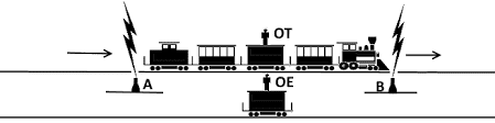

PS part of the problem here is when you rely on a diagram drawn in the platform frame. You are trying to think in the train frame, but the diagram is always the platform frame. This is confusing.
The first thing I would do is draw a new diagram for the train frame.

From the ground observer view, the train is moving away from strike A and towards strike B.
By the time he sees the light from both strikes, the train observer has moved to a point closer to strike B and further from strike A, in other words, the light from strike B will have already passed the train observer on its way to our Ground observer, but the light from Strike A will not have yet reached the train observer, and won't reach him until the train observer has moved even closer to where strike B occurred.
This means that the train observer had to be next to two different points of the tracks when each light flash reached him.
Now, here's the important part. The train observer must agree to this fact. You can't have the ground observer say that that light flash B reached the observer when he was next to point C of the tracks and Light flash A reached him while next to point D while the train observer says that both flashes reached him when he was next to point E. That would involve a physical contradiction.
So we are forced to accept that the train observer must see the flashes at different times, And, being at the midpoint of the train, with the strikes hitting the ends, and light traveling at the same speed from each flash, he must conclude that the lightning strikes that produced those flashes could not have occurred simultaneously in the rest frame of the train.
Likes cianfa72 and sysprog

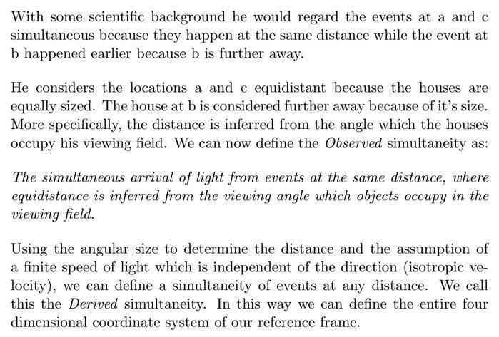

Once you understand non-simultaneity it is really not that complicated. It is also very natural: Just what you would expect.
You can also already see why non-simultaneity occurs without any reference to relativistic effects like Lorentz contraction and Time dilation. This because at low speeds non-simultaneity is proportional to the velocity ##v## and therefor it is already relevant while the other effects can still be neglected.
Addressing the misunderstanding:
If the two propagated light flashes meet each other at one point then any observer at that point will see them (receive the light flashes in his eyes) at the same time. This is totally independent of the velocity of the observer. However, they draw different conclusions about the simultaneity of the light flashes.
So both observers see two flashes at the same time. Nevertheless, your observer at rest concludes that they happened at the same time, while your moving observer concludes that the flash in front of him occurred earlier then the one behind them.
Why?

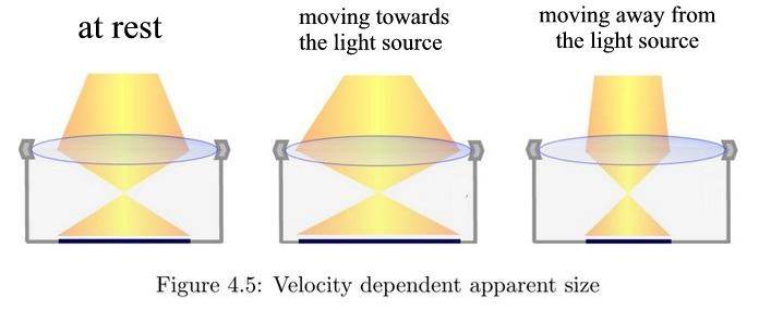

Say you see two flashes at house b and c at the same time. Your conclusion is that the flash at house b occurred earlier because, from the size, you conclude that house b is further away.
This is the whole point. The moving observer sees a bigger flash in front of him and a smaller flash behind him, so he concludes that the flash in front of him occurred later.
The explanation for this effect is (without any need to involve special relativity) just a simple vector addition in the rest frame. You need to add the speed vector of the observer to the light ray vectors coming from the light source.
The angle of the light rays change depending on the relative velocity and the apparent size changes.
The image above illustrates this effect. Now let's go into more detail using your image.
What does the OT observer see if he moves at 1% of the speed of light? We take the formula for ##t'## and for low speeds we can set ##\gamma\approx 1## so we have for the non-simultaneity:
$$t' = t - vx/c^2$$
Now the light rays coming of an object are wave-fronts build up from emitted light over a period of time. So a wavefront from a moving object is different than from an object at rest.
- OT will see the house B blue-shifted by 1% and larger by 1%.
- OT will see the house A red-shifted by 1% and smaller by 1%
- OT sees no red or blue shifting in the wavefront from both ends of the train.
- OT neither sees an apparent change in size of both ends of the train.
Because OT sees the objects in the frame at rest changed in size by 1% he concludes that there is a 1% shift in simultaneity as expressed by the formula above. This is all still without Special Relativity.

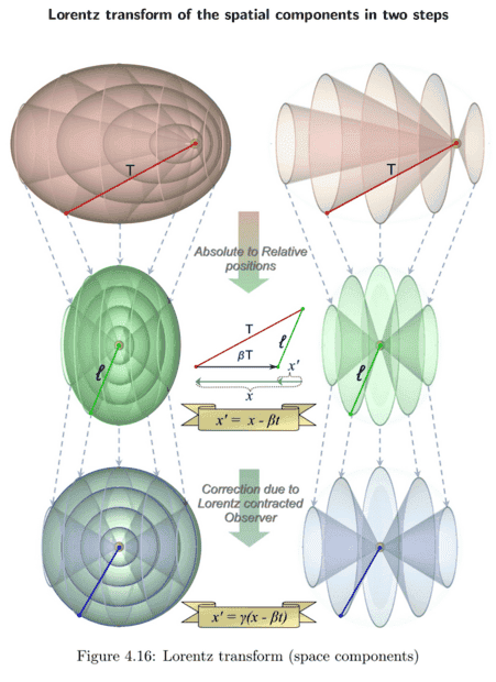

If you want to understand Special Relativity and the beautiful way in which this non-simultaneity effect perfectly reverses the relativistic effects of Lorentz contraction and Time dilation I can recommend to this chapter of my book:
http://www.physics-quest.org/Book_Chapter_Non_Simultaneity.pdf
It involves the ellipsoids of simultaneity. The ellipsoids on the top are defined as simultaneous by our moving observer by the effect described above. The ellipsoids in the middle reverses the vector addition in a non-relativistic way. The lower spheres are corrected for Lorentz contraction: Because we end up with spheres the moving observer concludes that the speed of light is still C in any direction, even after changing to a new reference frame.

lukka98 said:
Summary:: My question is about on of the "famous" Einstein's mental experiment: the train and the lightnings, i don't understand why the result is what it is, I thought for day but I don't understand this particular case, If you can help me to understand I'll very grateful.
Lukka98, Perhaps this may help resolve your problem #1: OT observes the light from each lightning strike at different times because OT was no longer at a location equidistant from both lightning strikes at the time the light from both strikes reached OT.
Let's stop time when the lightning strikes occur so we can establish what is occurring at that time. When the two lightning strikes occur, the light has not traveled toward OT yet because light takes time to travel. When the lightning strikes occur, OT is at a certain location we will call LOCATION 1. OT has not seen the light yet because light takes time to travel.
Now, let's start time moving very slowly so we can observe events in order. Let's first consider OT's relation to only the lightning strike at the front of the train. The light from the lightning strike is traveling toward OT, and OT is traveling away from LOCATION 1 (where OT was when the lightning strike occurred), and OT is traveling toward the light. The light reaches OT sooner than it reaches LOCATION 1 because OT has been moving toward the light while the light was traveling toward OT. The light traveled a shorter distance, which took less time to reach OT than it would have if OT was back at LOCATION 1, so OT observes the light sooner than if OT was back at LOCATION 1 when the lighting struck.
If we look at what happens with the lightning strike at the back of the train in the same manner, we notice that OT was moving away from that lightning strike while the light from it was moving toward OT, and OT was moving away from LOCATION 1, where he was when the lightnings struck. By the time the light from the back of the train reached OT, OT had traveled farther away from the light and farther away from LOCATION 1, so the light took longer to travel the longer distance to reach OT. So, OT observed the light from the back of the train at a later time than if OT were back at LOCATION 1.
Therefore, OT observes the light from each lightning strike at different times because OT was no longer at a location (LOCATION 1) equidistant from both lightning strikes at the time the light from both strikes reached OT.

lukka98 said:
- If the speed of light is the same in EVERY inertial frame of reference, in the reference of OT that speed is c, so i think when the two lightning strike in A and B, they are equal distance from the center (LBoy: but they are niot simultaneous) where there is OT 'cause the first assumption (when A and B are ALIGNED) so i think light will arrive at OT at the same time also in his frame of reference
Bold: here you have made the implicit assumption that both events are simultaneous for the OT on the train. And they aren't. That's where the misunderstanding comes from.
In the OE frame A and B are simultaneous (obvious I suppose). The OT has the same distance to the beginning and end of the train, where the lightning strikes, but by the time he sees the light from B (the beginning) a certain amount of time will have passed in which he approaches B and moves away from A.
The point or time at which it receives the light is crucial - that point is moving toward B and away from A.
Therefore, if the speed of light is constant for both observers - OE will see the light from B earlier and the light from A later, because distance from B to him is shorter due to movement, and bigger from him to A.
For him A and B are not simultaneous.

And now comes the book: let us look at the page 11 from the chapter: "Non-simultaneity from the classical wave equation"
LBoy said:
No, because that would mean that for both of them A and B occurred simultaneously. We explained this many times before.
No, @Hans de Vries is correct and you are wrong. If two flashes of light arrive simultaneously, but you know one source is further away, then you conclude that the one further away occurred first, even though they arrived simultaneously.
LBoy said:
The rest of explanation below is wrong. For example - the OT will not see flash B (front) as bigger and A smaller, velocity doesn't change the intensity (I assume that you meant intensity instead of size?) of the flash, it changes the frequency of light, so OT will see blue and redshift of light.
The rest of the explanation is completely correct (arguably, though, a lot more information than the OP needs).
Please look up aberration and beaming in special relativity. These effects, all derived in Einstein's 1905 paper (unlike prior work by Lorentz and Poincare) are in addition to redshift/blue shift. They cause increase/decrease in perceived size and intensity of a body image, depending on relative motion.
LBoy said:
And in no reference frame surfaces of simultaneity are ellipsoidal, not in this metric.
You misunderstand the argument. If you allow for light delays but do not account for specifically relativistic effects (simultaneity, length contraction, etc.) a sphere moving rapidly relative to you would appear as an ellipse. When the other effects are taken into account, it again looks like a sphere. This is all well known, and a search keyword for literature on this is Penrose-Terrell rotation.
LBoy said:
In conclusion - the whole post is misleading too, these are imho pretty basic errors too, sorry.
As far as I can tell, there are no errors in the referenced post.
Quote:
"The right hand side of same figure shows a very fast forward moving cabin. Light from the front passenger reaches the middle passenger much faster with a relative speed of c+v, while the light from the back passenger goes relatively slower with c − v."
And my comment to that: Sweet Baby Jesus.
No, that is correct. Implicit is that it is description of the cabin in a frame in which it is moving. c+v, for example, is difference in velocity of a wave front and a body, in that frame in which the cabin is moving at v. This is different from relative velocity as determined within the cabin.
I do not necessarily like the presentation in the book, but, again, I don't see any error in the section referenced.
Likes cianfa72 and LBoy
