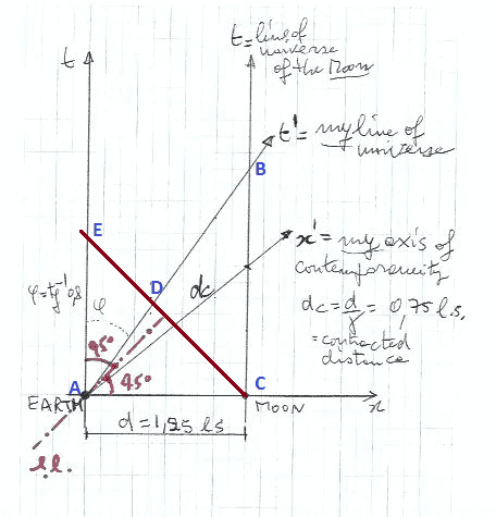

italicus said:
When calculating the time that a signal emitted from the Moon takes to get to me, I have assumed that the Moon and me are at rest in the same reference frame. I have specified this clearly for Andromeda, but it applies to the Moon too. So the distance is fixed, and t is a little bit greater than 1 second. It is obvious (better: relativistic ) that if I am in a spaceship flying towards the Moon at speed v = kc (referred to the rest frame said before), k<1, the distance contracts , becoming L_c = L/gamma . So the light takes less time.
If you are in a spaceship flying towards the Moon, measuring how long it takes for a light signal to travel from Moon to Earth, you measure the signal as traveling at c relative to yourself, and the Earth as moving at kc away from the point of emission.
So for example, if we assume the Moon is exactly 1.25 light sec from Earth, In the rest frame of the Earth-moon system, the light takes 1.25 sec.
If you were traveling at 0.8c towards the Moon, then the Earth-Moon distance is 0.75 light sec by your measure. However, since the Earth is receding from the emission of the signal, it will take 0.75/(1-0.8) = 3.75 sec between signal leaving Moon and arriving at Earth by your measure; a longer time than that measured in the Earth-Moon rest frame.
Likes PeroK

  • #72
Thank you Janus.
But note that I have told at the beginning of the post :
"When calculating the time that a signal emitted from the Moon takes to get to me..."
and I am on board a spaceship traveling at 0.8c towards the Moon (we have to imagine that my spaceship started with a speed of 0.8c suddenly, or crossed the Earth position already with that speed: no acceleration ! ). So I am interested in my propertime taken by the light signal emitted by the Moon to reach me, not the Earth. I simply divide the contracted distance, which is 0.75 ls , by 1 ls/s , and obtain 0.75s of my wristwatch time. This is the meaning of my last sentence :
"So the light takes less time” ...to reach me, of course! I don’t care of the Earth.
But you say that : “ the Earth is receding from the emission of the signal “ . Why? Earth and Moon are always at rest in the same reference frame. Please look at the following drawing, and tell me
what is wrong within it.

  • #78
This doesn’t make sense. Your proper time is only defined on your worldline. The signal emission is not on your worldline. So your proper time from the signal emission to anything is not defined.
All you can calculate is the coordinate time, and that coordinate time indeed does depend on the frame.

  • #79
It makes sense. My proper time is that signed by my wristwatch. But I just divide the contracted length 0.75 ls by c = 1 ls/s , and obtain 0.75s .
The coordinate time is calculated by the Earth observer, not by me. Between coordinate time and proper time there is the well known relationship : Deltat = gamma* Deltatau . (Sorry, I don’t know latex enough) . You can check that : 1.25 / 0.75 = 1.666... = gamma.

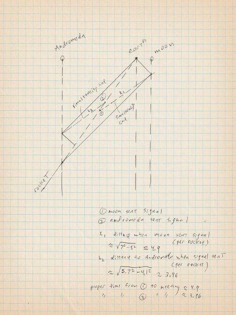

Attached is a diagram. It is all drawn in the andromeda, earth, moon rest frame. However, calculations for the rocket are still readily done in the frame using invariant interval computations. For more convenient scale, Andromeda is considered to be at distance 10 in Earth frame, and moon at distance 2, but no matter what the ratio is, the same thing is is possible - you just need higher rocket speed.
I show the rocket world line along with the andromeda, Earth and moon world lines. These are all dashed lines. Light paths are solid lines. I also show 2 rocket simultaneity dashed lines, which, of course, are consistent with mid point between send and receive times for rocket. I show the light paths the rocket would need to send to measure distance to Andomeda and the moon.
As you can see clearly, the rocket considers the moon to be at a distance of 4.9 when the moon signal is sent, the signal needing to be sent 4.9 seconds before meeting of earth, rocket and two signals - per the rocket. Similarly, per the rocket, the andromeda signal must be sent 3.96 seconds before the meeting to cover the distance of 3.96 and arrive at the meeting. Thus, for the rocket the time ordering of signal transmission events and distances to them are reversed relative to Earth frame.

I have labeled some events on your diagram, and explicitly added the light pulse that we are discussing.
Your wristwatch is on the worldline that goes from event A to event B. Your proper time is not defined for any events that are on any other line besides the line AB. In particular, your proper time is not defined for event C nor is it defined for event E. The only event on the light path for which your proper time is defined is event D. It makes no sense to speak of your proper time between C and E, it does not exist.
italicus said:
Due to my relativistic speed, the distance Earth-Moon , which in their common rest reference frame is L = 1.25 ls , appears contracted to me : L_c = L/γ = 0.75 ls.
How long does it take a light signal, emitted by the Moon, to cover this contracted distance ? Divide L_c by c=1ls/s , and obtain 0.75s of my time.
That's all.
Now, let the Earth frame be unprimed and the spaceship frame be primed, and use units of time in seconds so that c=1. Then ##\vec A = (t_A,x_A) = (0,0)## and ##\vec C = (t_C,x_C) = (0,1.25)## and ##\vec E = (t_E,x_E)= (1.25,0)##.
Now, if we do a Lorentz transform into the primed frame moving at 0.8 c we find ##\vec C' = (-1.67,2.08)## and ##\vec E' = (2.08,-1.67)##. So the time according to the rocket is ##t'_E - t'_C = 3.75 \ne 0.75##.
Note that in the primed frame the distance between the Earth and the moon is indeed 0.75 ls, but it is incorrect to assume that the time for a light pulse to go from one to the other is simply that distance divided by c. In fact, it takes considerably longer because the Earth and moon are moving in the primed frame.

  • #90
@Dale
you said this :
"The only event on the light path for which your proper time is defined is event D. It makes no sense to speak of your proper time between C and E, it does not exist."
I have never spoken of my proper time between C and E, which is a light path. I have spoken of my proper time between A and B , which is my worldline. Can I watch my wristwatch , during my trip to the Moon?
Do we want to determine at what time, measured by an Earth observer, the signal coming from the Moon meets the rocket ? Your additions to my diagram help. The meeting happens at the event D . A simple reasoning goes like this ( see for example the first chapter of the book by Morin on Relativity, already cited, but I don’t remember where! ) :
The distance Earth- Moon is L= 1.25 ls .
This distance is covered in part by the rocket, that has a speed of 0.8c wrt Earth ; and in part by the signal, that has speed c , obviously, and direction opposed to that of the rocket. So, the instant of meeting , as calculated by the Earth observer, that I'll call T_d, is given by the following simple equation :
L - cT_d = vT_d
which means : T_d = L/(c+v) = (1.25 / (1 + 0.8) ) s = 0.6944 s
this is the time of meeting, event D, measured by an Earth observer.
Yes, you can measure proper time from A to B, but that has nothing whatsoever to do with the light pulse when you said “I am interested in my propertime taken by the light signal”. That is what I am objecting to.
That single event, event D, is the only event for which a proper time related to the light pulse may be defined. Since it is a single event, no proper time duration may be calculated at all related to the light.
L - cT_d = vT_d
Sure ##\vec D = (t_D, x_D) = (0.69,0.56)## and ##\vec D’ = (t’_D, x’_D) = (0.42,0)##.
Likes vanhees71
  • #92
Dale said:
Yes, you can measure proper time from A to B, but that has nothing whatsoever to do with the light pulse. I thought that is what you were discussing.
Oh, at last, we have agreed on something! I see that you have also determined t’_d and x’_d=0, thanks. But now we are in OT a lot!
