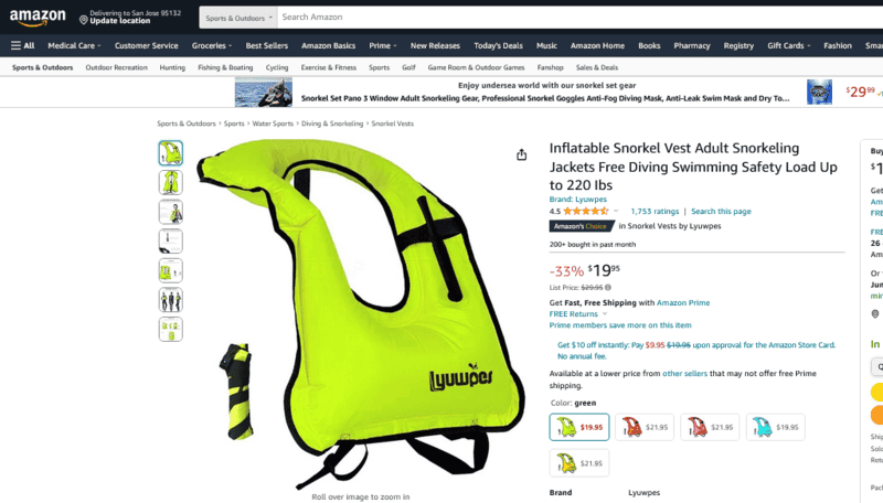

Welcome to PF, Bob.
Have you looked into the mechanisms that are used in buoyant vests (like in Personal Flotation Devices or diving Buoyancy Compensators)? That might give you a place to start.
https://www.boatspecialists.com/seachoice-inflatable-pfd-manual/auto-activation/
https://www.amazon.com/Lyuwpes-Infl...ing-Swimming/dp/B072295N17/?tag=pfamazon01-20

I will look into inflatable life vests, thank you.
