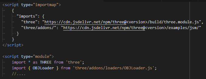

I can see the code you posted in an image at https://www.physicsforums.com/threads/cannot-type-etc-hosts-without-the-spaces.1045236/post-6796951
That code won't work - you can't load three that way (any more, I think you could with earlier versions which did expose a THREE global). You need to follow the instructions at https://threejs.org/docs/#manual/en/introduction/Installation: either Option 1 (which you will find easier in the long run if you can overcome your fear of build tools, and is certainly easier if you want to be able to run your script without an internet connection) or Option 2, which is set up to use a CDN but could I suppose be adapted to use an offline download of the whole bundle including addons, noting that this is undocumented and unsupported and probably requires a deeper understanding of how browsers implement CORS for JavaScript modules than I believe you want to delve into.
If you don't like Option 1 because you don't understand what is going on 'under the hood', follow the more explicit tutorial at https://threejs-journey.com/lessons/first-threejs-project

No, you don't need your webhost to support node.js, you simply need to upload the html and javascript files. I simply suggested Node.js as an easier way to get a development web server running on a local machine, all it is doing is serving static files. Your web host uses (probably) Apache to serve static files, you just need to upload them to the right directory.
If you are following Option 1: build using vite build and upload the build directory.
If you are following Option 2: just upload a html file containing an importmap pointing to the CDN:
(you need to substitute a version number in the import map above, something like

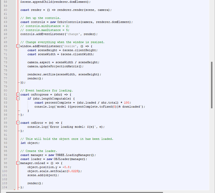

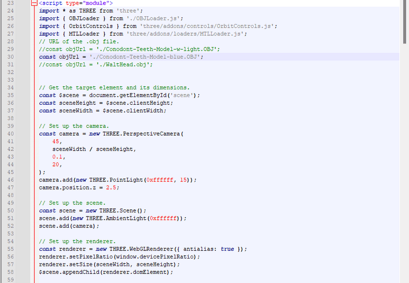

Not really sure how the pieces fit together. I
  • installed node in its default directory.
  • downloaded @pbuk's index.html to a local folder
  • pointed it at my .obj file.
  • pointed the OBJLoader to one I found in an example subfolder of the three-js-master folder
  • I didn't find any file called OrbitControls.js anywhere. There is no /controls/ folder. So I commeted that line out.
  • launched index.html
index.html throws a CORS error
I tried opening a terminal and running node index.html which, of course, fails.
I'm not really sure what I'm doing.
This is where I get stumped. There are an uncountable number of ways of configuring and using node and modules, and none of the examples match any others so the jigsaw puzzle pieces don't fit together. Even the Intro to node.js has absolutely nothing to do with what I'm doing. I don't see what I would gain by blindly going down a rabbit hole.
*sigh* guess I've got some tutorials to review.

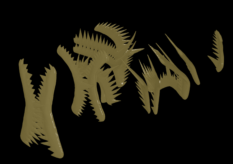

Jesoosi Christoosi! It's working!
https://www.davesbrain.ca/3d-three/index.html
Now all I have to do is figure out how to alter the lighting and add some colour...
Lighting
I added a light (otherwise it renders pitch black). I tried altering the light - turning it from the default 1000W down to 200W but it appears to have made no difference in final rendering - still that burned out white.
Colouring
I gave it a different colour (a deep blue) using "texture paint", just to see if the colour would render. It did not. Still stark white. Maybe texture paint is the wrong tool to export to .obj.
I think I need to break the object down somehow, before I can colour particular bits of it. It's a .OBJ, which means it has to be imported into Blender as a single object, not multiple components. I can only select the entire object (the orange outline). There is only 'Object Mode' available - there is no 'Edit Mode'. Maybe something to do with UV editing?

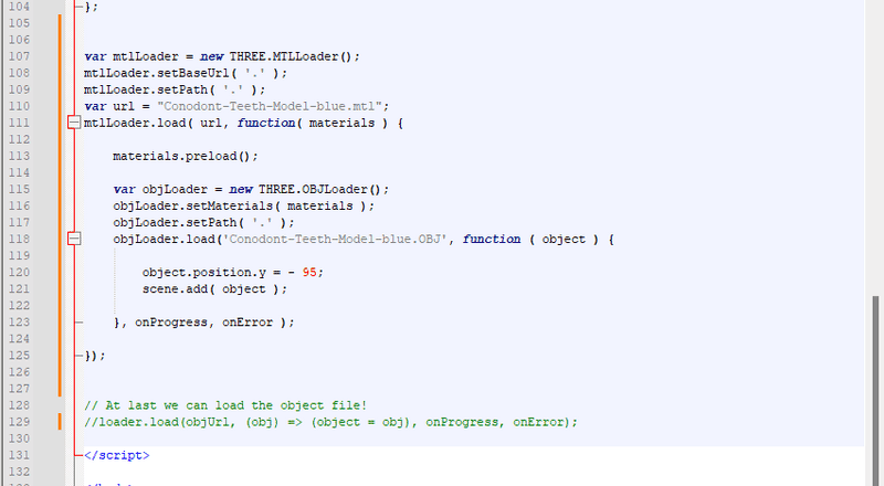

This is my attempt to dovetail @pbuk 's code with the example:
It dies on line 107 with "THREE.MTLLoader is not a constructor".
Here is my co ... ***SIGH*** Here is a screen grab of my code:
I'm trying a few alternate implementations I'm finding online. Problem is, Unless they list ALL their code, the samples are not compatible (since there are as many ways to implement a .js module as there are developers).
Yes, addons are no longer handled in this way. If you look at line 27 of your code
JavaScript:
import { MTLLoader } from 'three/addons/loaders/MTLLoader.js';
you can see that line 107 should simply be
JavaScript:
const mtlLoader = new MTLLoader(); // Don't use var, it is 2025.
Yes, that is because the new way of loading modules does not work from a file:// origin, it must be from a file served over http(s).
It's a shame you didn't try
Code:
npx serve .
like I suggested: that would have started up a web server on http://localhost:3000 which would have rendered your index.html file.
