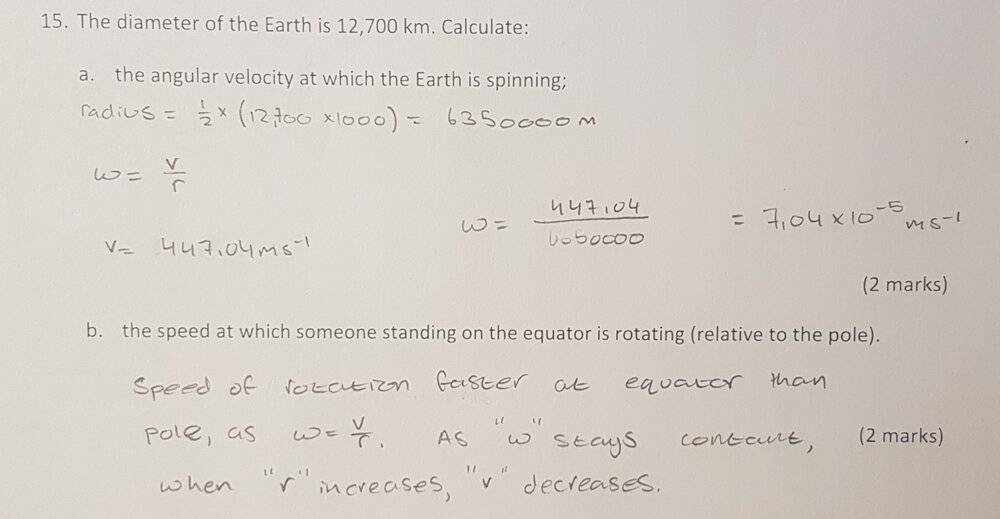

The diameter of earth is 12,700 km. Calculate :
a> The angular velocity at which earth is spinning
b> The speed at which someone standing on the equator is rotating relative to the pole

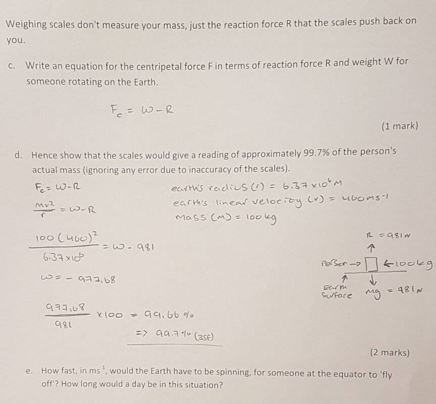

Weighting scales do not measure your mass, just the reaction force R that the scales push back on you.
c> Write an equation for the centripital force F in terms of R and weight W for someone rotating
on earth
d> Hence show that the scales would give a reading of approximately 99.7% of the person's
actual mass (ignoring any inacuracy due to the scales)

My solutions (attempts) :
a> w=v/r | r=6.35x10^6m | therefore V=7.04x10^-5 m/s
b> speed of rotation is faster at the equator than the pole as w=v/r. As w remains constant, as r increases towards the pole V has to decrease.
c> F = W - R
d> Stuck here. I presume that I have to use the equation from part C and gravity must be a factor but I am unsure of how to work this one out!
e> No idea how to work this out? Am I meant to google an equation for speed of rotation and the length of a day!? What would you do?
For a) you need the angular velocity ##\omega##. For b) you need the speed ##V##. For c) I think they require more than that.

So i am working through part D, using the formula (mv^2/r)=W-R.
Just wondering if I am suppose to use a made up mass and then show that the reading would be around 99.7% of it. Don't see any other way to get a value for W. Any chance you could work this out so we can compare?
RemotePhysics said:
So i am working through part c, using the formula (mv^2/r)=W-R.
You could use a test mass of ##100kg## if you want.

Maybe this is the problem. Do you really mean ##V = 7 \times 10^{-5}m/s##?
Aha, 7 × 10-5 is in rad/s not m/s! Does this mean that V should be the linear velocity of earth?
EDIT: I think that I have it! Thank you very much!

I don't know about other people, but I find your lack of working makes it difficult to follow.
If I get different answers from you, I don't know if you've used different values or done a different method, which may be not right.
(a) is not far from my answer, but I can't see why. But you may have used a different value for the period of rotation. If you showed your working, I could use the same data as you.
(b) puzzled me. It gave me a numerical value in m/sec , but you gave a verbal description, no numbers.
(c) I agree.
(d) I just used M for mass. Then gravity comes in automatically when convert it to weight.
The question setter deliberately tries to confuse you here by saying,
" Weighting scales do not measure your mass, just the reaction force R " which is true.
Then he says, "... the scales would give a reading of ... actual mass ... "
So, although they measure weight, they give a reading of mass. So you have to be very careful about whether R refers to mass or wieght.
When you say "(mv^2/r)=W-R." you are clearly using R as a force in Newtons.
So to answer the question you will either need to convert this to ##R_m## , the mass reading that the scales give, to compare with the real mass M, or compare R with the real weight W
With the level of working you show, I can't tell whether you are understanding this issue or not.
If you show working, we can tell the precise point where you get stuck or go wrong (and probably, you will be able to tell as well!)

Here are the images of the questions and my working out thusfar. Whats your thoughts on the wording of the questions? Methinks that they are not clear as they could be...
Hope that this makes more sense! :)
For part a) you can get the angular velocity directly from the period (one day). The answer to part a) should be in radians per second.
The answer to part b) should be the speed you found in a).
Part c) is correct with ##W = mg##, of course, where ##g = \frac {GM}{R^2}##. The point I would make is that we measure ##g## on a spinning Earth! So, what is ##g##? Is ##g## what we would measure on a non-spinning Earth or is it what we actually measure on a spinning Earth (and varying from place to place)? That's a question for the question setter. And, likewise, how is weight actually defined on the surface of the Earth?
Part d) looks right. But, again, the ##9.81m/s^2## is what we measure on a spinning Earth. The actual gravity ought to be something like ##9.84 m/s^2##, 99.7% of which is what we measure.
Likes Merlin3189
Thanks, this clears up a lot of my questions!

There's no conceptual problem here. The faster the Earth spins, the less effective gravity we feel. Eventually, if it spins fast enough gravity isn't enough to keep up on the surface.
Trying to think of which formula I would use for this... I suppose it must angular velocity (w) and gravity (g)? Maybe the centripital force equation F=(mv^2)/r where F=0?
The equation is simply ##g = a_c##, where ##g## is the purely gravitational acceleration at the surface of the Earth and ##a_c## is the centripetal acceleration of the rotation.
That should be clear.
This is a tad odd as there is no mention of this in my course. I suppose that what you are saying is that when when the centripital acceleration > gravitational acceleration then the person would fly off?
You are supposed to be able to apply your knowledge to a range of problems. In this case you are expected to work out for yourself that condition, using your knowledge of forces.
Likes Merlin3189 and RemotePhysics
That's right, though I might say that, when
the force needed to give the required centripetal acceleration > the force provided by gravity
then the person will not be held in a circular path on the surface of the earth.
Changing to refer to accelerations, answers your earlier problem about the person's mass: both forces are proportional to mass, so you cancel the mass from the forces and are left with the accelerations.Edit: Anyhow, what result do you get when you solve your equation,
