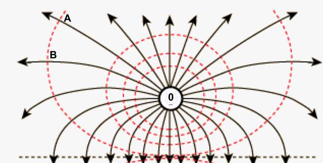

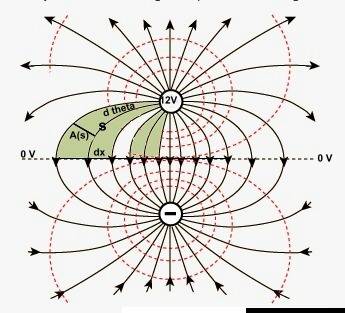

That's right, but say you have some small area, where you attach the positive ohm-meter probe, you will get equi potential curves ( the red curves ) like this:
A current will always flow perpendicular to the red curves, so within an area surrounded by two black curves ( current paths ), the current "flux" will be the same.

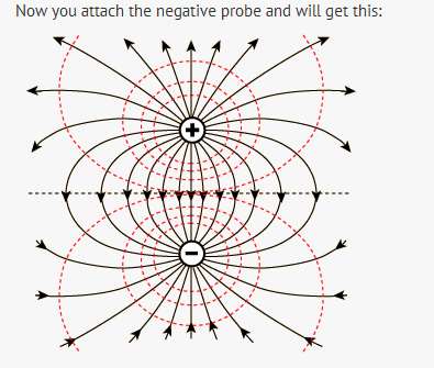

Now you attach the negative probe and will get this:
Again, the current flux will be the same within areas surrounded by two black curves. The resistance of such an area may be calculated:

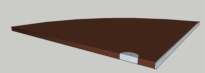

R = σ * 0L 1/A(s) ds , where A(s) is a cross section area, s is the current path and L is the length of the path.
If the area of the plate is not infinit, the curves will of course will be distorted. I recommend a numerical calculation to solve the problem.

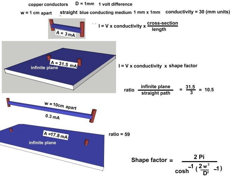

Hi
In fact the resisstance would be the same as between the metal electrodes in this image. This presentation reminds of of a similar problem I saw a few years ago where the only way was by a finite element approach. Somehow I find it hard to believe there's no pure mathematical solution to such a simple problem as mine.

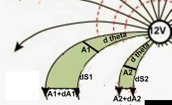

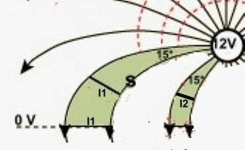

Hesch, I've re-arranged you image to get a clearer idea in my head of what you're saying. Your formula R= ... is obviously true but may I saxact, but really is only the beginning.
Something went wrong, I'll continue. "obviously true but geometrically doesn't help me much. I don't know if I should integrate with respect to d theta between 0 and Pi, hopefully being able to express S and A(s) as a function of theta, or with respect to dx between 0 and infinity. I'm not , or no longer able to master this problem.

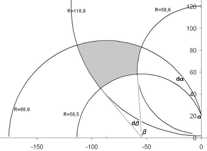

In the figure in #9, you have written a "dx" and a "dθ".
I prefer the θ because the current-flux then will be the same through all N areas. ( dI = I * dθ / 2π, seen close to the 12V-circle ).
( Hope you understand what I'm trying to express ). :smile:
Perhaps integrate over dθ using the area and length determined by θ? Of course integrate form 0 to 2π (or 0 to π and double). The area (or at least the width of the area) is a function of θ I think.
I'll give some thought to finding the functions for the length and width. They don't spring to mind. Perhaps someone else knows?
I'm not sure that's the easiest method, but hopefully it gives an analytically solvable solution.
Are we sure that the current-flux will be the same through all N areas for the same dθ seen close to the 12V-circle ?
It is not. It varies with the changing width and length, going up as the width increases and down as the length increases. That assumes an even conductivity. This should be covered by the equation -- which I still don't have.

I don't agree in that. The current density will change, but the current flux will not: No current will cross a current path ( black curve ), and due to KCL the current flux will be constant within an area.
If the conductivity is not homogeneous, the equi potential curves will be distorted, and thus the current paths and the shape of the areas.

Please Hesch, what does "and due to KCL" mean?
Secondly, I still don't see why the current fluxes I1 and I2, which we can express in total ampères crossing the straight line, should be the same for a same angle at the centre..
KCL means Kirchhoffs Current Law ( the 1. law ):
The sum of currents ( calculated with signs ) flowing toward a node = 0.
In case of your attached figure, a "node" could be a boundary "I1" in the leftmost area. Now KCL states that the current flowing toward this boundary = the current flowing away from the boundary, which means that the current flux will be the same as for both shown "I1" boundaries.
If the area/diameter of the "12V" circle is very small compared to the distance between "12V" and "-" poles, the "12V"-pole cannot "sense" the "-" pole and the current density will be the same close to the "12V"-area in all directions. Thus the current flux = Idens*dθ will be the same through alle areas.
At some distance from the "12V"-pole the length of the boundaries will increase and the current density will be decreased, but the current flux = (boundary length) * (current density ) will be constant.
"If the area/diameter of the "12V" circle is very small compared to the distance between "12V" and "-" poles, the "12V"-pole cannot "sense" the "-" pole and the current density will be the same close to the "12V"-area in all directions. "
I hope you're right on this, as it considerably simplifies the problem. I thought about this quite some time, I really remain only half convinced!

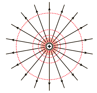

I read in a theoretical study on the Hall Effect that for a point electrode on an infinite plane, the current does emanate uniformally in all directions. So be it.
In this case, we can say that the ratio (A+dA)/dS between equipotential lines will the same for all d theta shade areas, ie (A1+dA1)/dS1 = (A2+dA2)/dS2. I'm not sure this helps much.
Could we therefore say that the ration of curve lengths AB/BO (O= origin) will be equal all round an equipotential line?

Not as far as I know. That would be true for concentric circles which these are not. It could be true, but I can't prove it.
The red equipotential lines are all circles. The black current lines must also all be circles. The circles are eccentric.
If AB/BO was constant for a particular circle then BA/AO must also be constant.
That would require A=B which is clearly not the case for eccentric circles, so the supposition must be false.

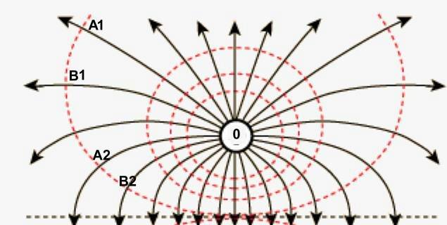

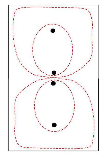

My supposition was that, for example in this image, B1 O/B1A1 = B2 O/B2A2

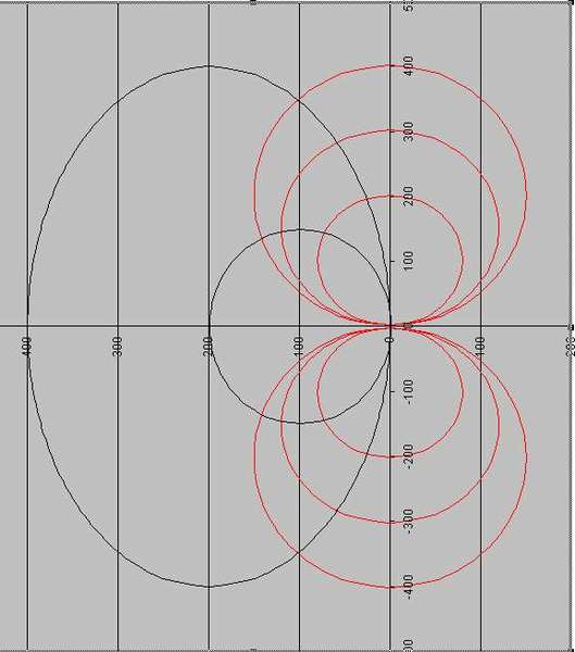

See Excel image. The 6 red lines are ellipses having the same two focal points. The two black ellipses pass through these two focal points. It looks very much like the red and black lines cross at 90°. So the focal points could be the point contacts, the red ellipses equipotential lines and the two black ellipses the current paths.
An interesting graph. But of what?
They are all perfect circles. But none of them have the same centre position.

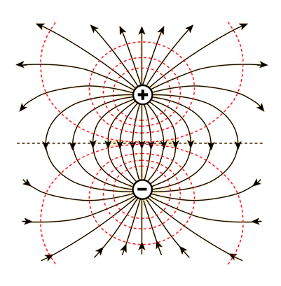

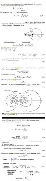

Jeff, graph of this image from the preceeding page :
Baluncore,
"they are all perfact circles" See image below. They are obviously not for a closed surface, what is the proof that they should they be so for an infinite surface ?
"they can be used to model the fields between cylindrical conductors of different diameters" Easy to say, do please carry on, assuming they are ellipses which should greatly simplify the problem.

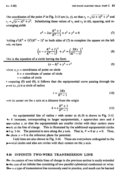

Years of experience. Attached are three pages from Electromagnetics. 2nd Edn. Kraus and Carver. 1973.
Start at bottom of page 81 with sect 3-19.

That's more than good enough for me, equipotential lines on an infinite surface ARE elliptic.
NO.
Half way down page 83; Eqn (9); demonstrates that the equipotentials are circles. Eqns (10) & (11) let you draw those circles.
At the bottom of that section it concludes; [ocr] Field lines are also shown in Fig. 3-16. These are everywhere orthogonal to the potential circles and also are circles with their centers on the y axis. [/ocr]
Attached is better copy of that last page.
