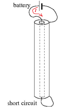

Here’s a picture of the diagram. The reason I’m confused is because of the odd placement of the resistor. Normally the resistor is connected at opposite ends. In this case it’s not, and I’m not sure why the resistance would be the same as if it were. Does the current still flow through the entire resistor?

The current first leaves the battery as shown below
Note that all of this current enters the core. Where does the current leave the core?
Think of the core as having a resistance which you found in part (a). So, you can think of the core as a resistor Rc. Likewise, the shell has an overall resistance Ra.
After the current leaves the core, where does it go?
It would go through the shell. I’m guessing this means that the two resistors are in series?
I don’t quite understand why that’s the case. Since the wires aren’t attached at opposite ends wouldn’t the current not have to travel through the entire length of the resistors? And wouldn’t that make the resistance less than it would be in a situation where the current does have to flow through the entire length of the resistors?
The current enters the top of the core and leaves the core at the bottom. So, the current travels the entire length of the core. Then the current travels along the "short circuit" wire (which has negligible resistance) and enters the shell. Where does the current enter the shell? Where does it leave the shell? Does the current travel the entire length of the shell?

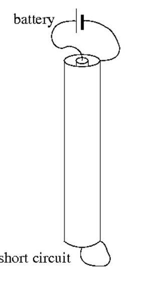

I believe the current enters the shell from the short circuit and then leaves into the negative terminal of the battery. So it does travel the entire length of the resistor.
Why though would it do that instead of just taking a straight path from the top of the two resistors? It seems like the electrons are not taking the path of least resistance.
The core and the shell are isolated from one another except for the short-circuit wire at the bottom. There is no "straight path from the top of the two resistors".
Often there is some sort of insulating material separating the core from the shell. Or, you can just think of there being an air gap between the core and the shell. Either way, current cannot travel between the core and the shell except through the wire at the bottom or through the wire and battery at the top. So, it's equivalent to
