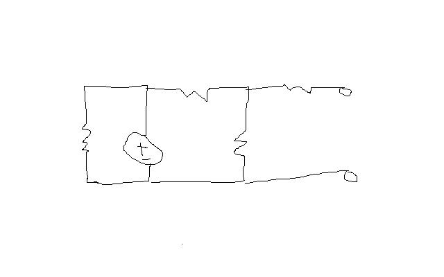

A resistor in parallel with a voltage source or a resistor in series with a current source has no effect on the rest of the circuit?
Depends on the internal resistance of the voltage source and the resistor value.
I take it these are ideal (mathematical) voltage and current sources with zero internal resistance.

I'm not sure how to use these threads that well...But here's a picture to help illustrate my point
http://img519.imageshack.us/img519/9540/circuityu9.jpg
The more resistors you add the more current you'll measure with the current meter inserted into the circuit.
:rolleyes: but the part labeled mA is part of "the rest of the circuit." any resistor of finite conductance that you place in parallel with that ideal voltage source will do nothing to the rest of the circuit. "do nothing" is semantically the same as "have no effect."

actually Type_R, before either of us had piped in on this, Don hit the issue on the head. the reason i am assuming that the internal resistance is zero is that is what you do with an ideal voltage source. the reason I'm assuming is this ideal voltage source is that is what you do in the discipline of linear electric circuits. we make other idealisms like conductances (or admitances) precisely add in parallel and resistances (or impedances) add in series. there's also the ideal Y-[itex]\Delta[/itex] conversion and this other concept of two-port networks that is an idealism of reality. the question really was asked, in my opinion, in the context of a linear electrics circuits course. and then the answer is "Yes, a resistor in parallel with a voltage source or a resistor in series with a current source has no effect on the rest of the circuit."
Type_R said:
He asked if a resistor in parallel with a voltage source have effect on the circuit...
Not quite. Re-read post #1, it asked if there's an effect on the rest of the circuit.
Yes, current out of an ideal voltage source will change. But no, the current through the rest of the circuit will not change. The difference in the two currents will be through the resistor that got added.
The rest of the circuit will have the same voltage across it, and current through it, as before.
For non-ideal sources, see Don's post #2.

i don't think your semantics of what the OP asked is correct. you have a voltage source (an ideal voltage source, in my opinion, considering the question) and you have whatever it is connected to (which is precisely what is meant by "the rest of the circuit"). now place a resistor of non-zero resistance in parallel with that (ideal) voltage source. does anything change in the rest of the circuit? there are three disjoint objects: the voltage source, the rest of the circuit, and the resistor we plan to shunt across the voltage source.
Right, the ammeter in post #10 needs to be between the two resistors, and not between the resistors and the source, to measure what's going on in the rest of the circuit. As is it's measuring what's going on at the source.
An electrical network is an interconnection of electrical elements such as resistors, inductors, capacitors, transmission lines, voltage sources, current sources, and switchesSo the wiring is apart of the circuit...The source is the "Voltage source"... Because the 4 amps coming back are is the combination of the 2 amps from the resistors WHICH is why it's 4 amps in the first place. Coming back from the voltage source.
My reasoning for saying that part of the circuit should literally be considered part of the "rest of the circuit" is because of how I measure... If I want to measure some of the circuits voltage. I'd measure from the first load to the end of some other load in the circuit. If I want to measure the rest of the whole circuit...I'd come from beginning of the first load all the way to the end of the last load. To have a "rest of" you need a beginning point. The beginning point of the electrons journey starts from the voltage source...all the way until last load and transmission line back to the positive potential. The way I look at "rest of the circuit differs from you guys who are saying "The devices in the rest of the circuit." But it's the resisting effect which is determining the current going back towards the voltage source.

I first started this thread when I was working on a problem of finding thevenin equivalent circuits.
When I am finding Voc,the resistor on the far left has nothing to do with the rest of the circuit, and same for a resistor if it is in series with a current source. When I am finding Rth and turn independent votalge sources to zero, it becames a short across the far left resistor.
