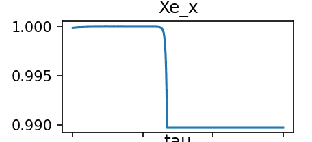

Hello everyone,
I am trying to code the recombination history of the universe in C. More precisely I have difficulties to solve the peebles ode equation. In fact when I am close to the saha limit, I begin the resolution but the rhs of the ode seems to be too big and it makes my result Xe diverge. Someone have an idea to solve the problem ?
Here is my code :

I decided to use gsl methods to because rk4 might cause some problems of stability. Now I try to solve Peebles ODE with this code :
[CODE lang="c" title="Peebles ode"]int peebles_ode(double x, const double y[], double f[], void* params) {
Recombinaison* rec = (Recombinaison*)params;
double a = exp(x);
const double OmegaB0 = rec->cosmo->OmegaB_0;
const double H_0 = get_H_0(rec->cosmo);
const double TCMB_0 = (rec->cosmo)->TCMB_0;
double T = TCMB_0/a;
double b = (eps_0*e)/(k_b*T);
double H = H_x(rec->cosmo, x);
double n_b = (3*OmegaB0*H_0*H_0)/(8*M_PI*G*m_h*a*a*a);
const double phi2=0.448*log(b);
const double alpha2 = (64*M_PI*alpha*alpha*h_p*h_p*sqrt(b)*phi2)/(sqrt(27*M_PI)*m_e*m_e*pow(c,4));
const double beta = alpha2*pow((m_e*k_b*T)/(2*M_PI*h_p*h_p),1.5)*exp(-b);
const double beta2 = alpha2*pow((m_e*k_b*T)/(2*M_PI*h_p*h_p),1.5)*exp(-b/4.);
const double L2s1s = 8.227;
double Xe = y[0]; // y[0] = Xe
double n1s = (1 - Xe) * n_b;
double La = (H*pow(3*eps_0*e,3))/(8*8*M_PI*M_PI*pow(h_p,3)*n1s);
double C = (L2s1s+La) / (L2s1s+La+beta2);
f[0] = (C / H) * (beta * (1 - Xe) - n_b * alpha2 * Xe * Xe);
cout << f[0] << endl;
return GSL_SUCCESS;
}[/CODE]
But there is a problem somewhere, because when I compute, it yield a result that not converges to 0 :
I have the values of f[0] that varies between 1e-13 at start and 1e-25 at the end. There is probably an issue with my ode, can someone see what is the problem here ?
