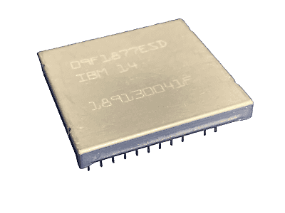

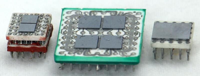

Aah! Fond memories! I used to work at IBM where they put the chip on a ceramic substrate. It was a lot more automated than what is in the video.
I started with products similar to these:
and with the cap on:

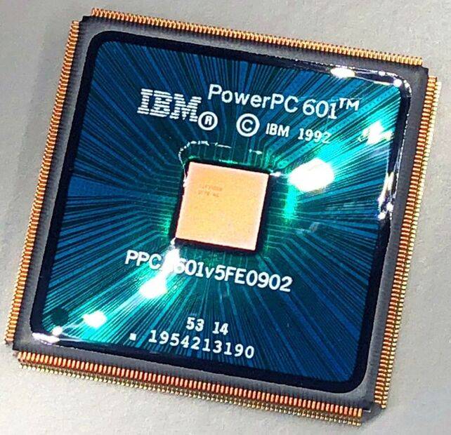

But I spent so much time on the PowerPC600 which was known to us internally as C4FP (C4 Flat Pack):
Even if I knew nothing about anything back then, I was impressed with that design compared to the ones above:
  • The pins clipped on the side instead of "nails" going through (hence "flat pack")​
  • The black seam (Hysol) that secured the clips​
  • The protective cap was replaced by a blue liquid cured to form a gel. And it was contained by the Hysol seam!​
Such a smart design. I cut the ceramic to the proper size, put the pins on, and also the Hysol on this product.

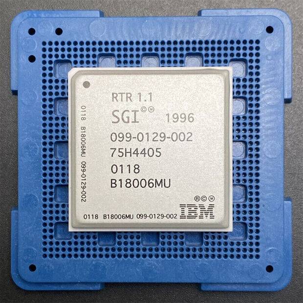

And they went back to pins, but they were soldered on instead of pushed through like in the earlier designs. There was even a version with balls which seems a lot smarter and easier to work with.
Can you imagine a machine was putting the right amount of some soldering paste on each "pad", at the same time, then the columns were put on, and the assembly was sent to the furnace for welding? Seemed a lot easier to clip the pins on the C4FP.
