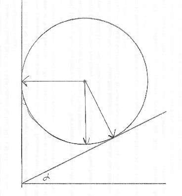

Right. Sorry. Here it is.
1.1 A ball of radius 3.0 cm and weight 1.00 kg rests on a plane tilted at an angle alpha with the horizontal and also touches a vertical wall. Both surfaces have negligible friction. Find the force with which the ball presses on each plane.
Fw is the force on the wall. Fp is the force on the plane.
Why did you write
Fw = tan(alpha) * kg-wt ?
Fw is a horizontal force because the wall is vertical and can only exert a force perpendicular to its surface.
Please post the free body diagram that you used to write your equations.
That's what is given as an answer in the solutions. I don't think it's correct. I think the answer is backwards.
I think the horizontal force on the vertical wall should be Fw=(1/cos(alpha)) * kg-wt. Not Fw=tan(alpha)*kg-wt.
It sounds like you agree. I'll try to draw a decent diagram and post it if this is not clear.

Here's what I came up with. I can see it when it rotates down but still seems kind of odd.
This diagram is confusing. I suggest that you redraw it showing the three forces that act on the ball only and find expressions for them. Then use Newton's 3rd law to find the force that the ball exats on the wall and on the plane.

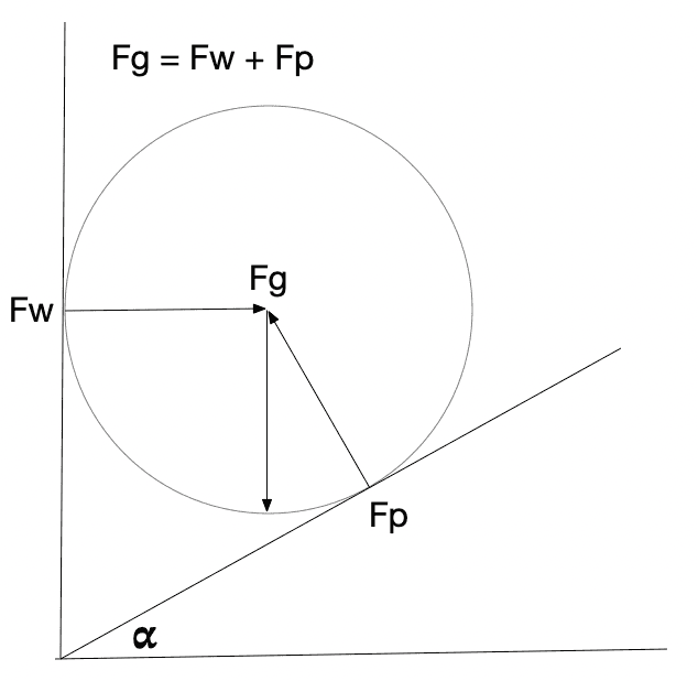

Better?
This seems to make sense.
John Helly said:
Two of those forces are forces exerted by the ball on the surfaces. The forces on the ball are in the opposite direction. As the ball is static, the total force on the ball must be zero - which is the key point.

Mahalo. I was trying to interpret it geometrically and could't get the directions right.
Is the wall pulling the ball towards itself or pushing back on it?
Same question for the ramp.
What are the two vertically upward arrows?
Likes MatinSAR

Ok. Correct?
That's the diagram but not the equation. Why should the weight be equal to the sum of the other forces?
Newton's second law says that the net force is equal to mass times acceleration. Here the acceleration is zero. The net force is the vector sum of the three forces. You have to find that and set its horizontal and vertical components equal to zero.

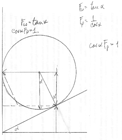

Well, this is what I came up with and it's obviously wrong but I don't know why.
  • Feynman-110.pdf
You're pretty close. Your forces in the diagram look good. But you need to be careful with the signs of the x and y components of the forces. Usually, we take the positive x-direction to be to the right and the positive-y direction to be upward. If so, then what should be the sign of the x-component of ##\vec {F}_p##? What should be the sign of the y-component of ##\vec {F}_g##?
  • #31
I concur with @TSny. For future reference, when the sum of any number of vectors is zero and you add them using the graphical "tip-to-tail" graphical construction, you end with a closed polygon. The number of sides is equal to the number of forces that are added.
Here you have a right triangle because there are 3 forces and ##F_w## and ##F_g## are perpendicular (see below). All you have to do is figure out which of the interior acute angles should be labeled ##\alpha## and then write down the usual trig relations.
