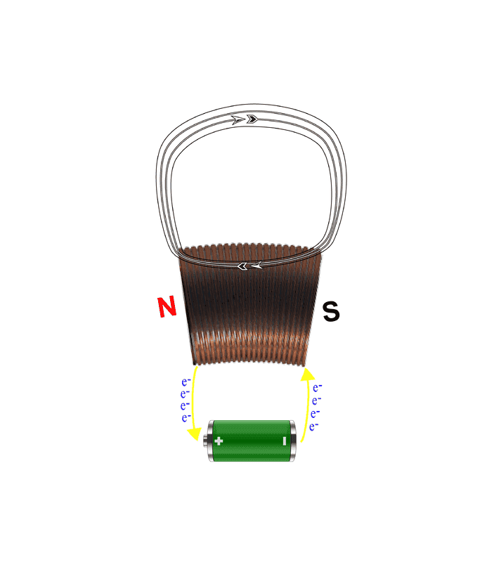

Ok I’m trying to understand the right hand rule in relation to electromagnets. Since I’m a visual learner I made myself a little diagram. Is my little diagram correctly showing the flow of electrons relative to the magnetic poles?
Also does the core and helix being slightly curved affect the lines of magnetic force as opposed to the core being straight?

It's not clear from the drawing whether the winding around the core is left handed or right handed. In other words, is the winding such that the wire leaving the positive terminal is wrapped from the front of the core towards the back or the other way around?

From my basic understanding the wrapping of the wire is not that important. It is the direction of the electric flow, no?
In my image the wire leaving the positive terminal is connected to the “north” side.
But here is a side view of the wrapping. Hope that’s more clear.
With N on the left, S on the right end of the coil
Note it is showing conventional current, not electron flow
so that makes your diagram incorrect :wink: That is, to satisfy your magnetic polarity, your battery polarity needs to be reversed
(Electron flow will be IN on the Nth end of the coil and OUT on the Sth end of the coilDave

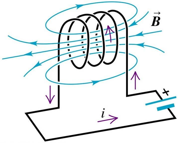

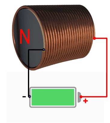

As @davenn already noted, to get the field lines pointing as shown in post #1, the battery must be connected as shown below. Current flow is conventionally opposite to electron flow, from positve battery terminal to negative. If you wrap the fingers of your right hand in the direction of the current, you thumb will point to the left which means that the field lines will come out the "N" side, loop around and go into the "S" side.
