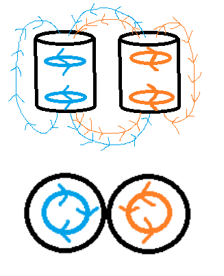

If the above is an electron moving towards the screen then the magnetic field it produces would be counterclockwise according to the right hand rule.
Using that logic, see below:
Green is copper wire, blue is electron movement in a permanent magnet and purple is the magnetic field.
I always picture a permanent magnet as having its own self-contained electric current as I don't know how they would produce a field otherwise, hence you see the electron flow inside the permanent magnet flowing counterclockwise. This produces the purple magnetic field. However this magnetic field would in theory envelop the copper coil surrounding it. If the magnetic field direction surrounding the electrons in the wire is stronger on one side, wouldn't it cause the electrons in said wire to also flow?
See picture above. If the big purple arrow (going up) of magnetic field is caused by something external, wouldn't it cause the other side of the electron's field to go down and cause the electron to move toward the screen?
That is what is confusing me a lot

The only (probably wrong) explanation I can think of as to why they only seem to interact when there is physical motion involved is when both are unchanging in state and position (even if such a state involves electrons flowing), an electron's own field will overcome any external field no matter how strong, a bit like if each electron became its own superconductor, and that state can only be broken by making the external field 'collide' with the electron to break that state. It just doesn't seem right.

I have seen diagrams like what I've shown and they say that if electricity ran through the coil it would enhance the effect of the magnet, but didn't say if any current would flow in the coil when external power was not applied. I think I'll have to try and set up an experiment if I can acquire the parts.

I think your diagrams have an error: the current flows in the opposite direction to the electrons. So your "towards" diagram has the field reversed. This follows on in your main diagram.

That's wrong, and it may lie at the root of your misunderstandings. There are no currents in a permanent magnet just sitting there. We require members to do some of their own study before posting questions here. In this case, I'll give you a start. Read and understand this: https://en.wikipedia.org/wiki/Magnetism#Sources_of_magnetism

Good spot- the green positive and negative symbols should have been swapped around. I think everything else was as I intended it though. Sorry if that led to any confusion

For magnetic surface currents in a permanent magnet see: http://farside.ph.utexas.edu/teaching/302l/lectures/node77.html ## \\ ## See also a Physics Forums Insights article that I authored: https://www.physicsforums.com/insights/permanent-magnets-ferromagnetism-magnetic-surface-currents/ ## \\ ## Some very detailed calculations have shown these magnetic surface currents to be a theory having considerable merit. The magnetic surface currents, along with Biot-Savart's law give results for the magnetic field that are completely consistent with the magnetic pole model for the magnetic field that is computed. ## \\ ## Griffiths' E&M textbook also presents them in chapter 6. His derivation is rather advanced and is easily overlooked by physics students who study his book, because he doesn't emphasize in great detail the results of his derivation, which I think are quite important in explaining the magnetic field of a permanent magnet.

I think that was exactly what I was wanting! Explains in an easy-to-visualise way and I think I get it now. That makes a lot more sense. So I wasn't entirely wrong; there is an electric current. Its just exclusively on the very outside of the material.

It's actually a different kind of current in that there is no actual electrical charge transport occurring. It is impossible to measure this current with a current meter, but all the calculations that are done regarding this "bound current" are extremely consistent. ## \\ ## On another note, this is actually extremely useful in this sense. In a transformer, plastic laminations are usually included to block unwanted "eddy currents" that occur. The "bound" magnetic surface currents are not blocked by these laminations, so that the magnetic field of the transformer does just what it is supposed to. If the laminations were to block the magnetic surface currents, the magnetic field of the transformer would be greatly reduced by the laminations.

The electron spin is different classically from orbital electron current, but in Griffiths derivation in chapter 6 of his book, he treats the case of a magnetic moment ## \vec{\mu} ## of either form (spin or orbital angular momentum). (Note: ## \vec{\mu}_s=\frac{g_s \mu_B \vec{S}}{\hbar} ##, and ## \vec{ \mu}_L=\frac{g_L \mu_B \vec{L}}{\hbar }##,(c.g.s. units), where the Bohr magneton ## \mu_B=\frac{e \hbar}{2 mc} ##, and where ## g_s=2.0023... ## and ## g_L=1.0 ## ).## \\ ## He considers an arbitrary distribution of such magnetic moments and derives the equation for the vector potential ## \vec{A} ##. This vector potential takes the form (c.g.s. units) of ## \vec{A}(x)=\int \frac{\vec{J}(x')}{c|x-x'|} \, d^3x' ##, where ## \vec{J} ## is any arbitrary current density distribution. With a couple of vector identities, he shows that the potential from his arbitrary distribution of magnetic moments has two terms that are of the following: ## \vec{A}(x)=\int \frac{\vec{M}(x') \times \hat{n}'}{|x-x'|} \, dA' +\int \frac{\nabla' \times \vec{ M}(x')}{|x-x'| } \, d^3x'##, where ## \vec{M} ## is the density of magnetic moments ## \vec{\mu} ## per unit volume. By looking at this result, one can conclude that the magnetic surface current density per unit length ## \vec{K}_m=\vec{M} \times \hat{n} ##, etc. ## \\ ## The first integral is the magnetic surface currents with magnetic surface current per unit length ## \vec{K}_m=\vec{M} \times \hat{n} ##, and the second integral involves gradients in the magnetization with bulk magnetic current density ## \vec{J}_m=\nabla \times \vec{M} ##, where I may have left off ## \mu_o ## and/or ## c ##, (or a ## 4 \pi ## ), in a couple of places. (Switching between c.g.s. and various SI units requires a little extra work. Griffiths uses a form of SI units). ## \\ ## (It is left open for discussion whether these currents are real or not. There is no actual charge transport here, but these currents can be used with Biot-Savart to compute the magnetic field ## \vec{B} ##. Alternatively, the magnetic field is given by ## \vec{B}=\nabla \times \vec{A} ## ). ## \\ ## Many physics students who have studied Griffiths textbook seem to overlook this very important derivation that he does. The magnetic surface currents that arise here can be used to readily explain the magnetic field of a permanent magnet of cylindrical shape that has uniform magnetization ## \vec{M} ## along its axis. The magnetic surface currents can be used to compute the magnetic field that exists both inside and outside the permanent magnet.
