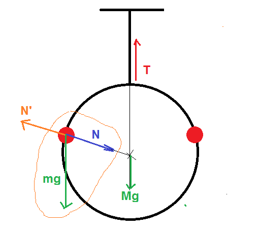

The forces acting on a bead is gravity and N, normal force from the loop. The forces acting on the loop are its weight, the tension of the string T and N', the force from the bead to the loop, equal and opposite to N.

Yes, your acceleration downwards will decrease, but I would think the blue N would then be on the bead and the orange N' on the hoop when the beads pass 90o from the top? (was hoping Mr Davis will respond)

No, the bead is in general position. And the normal force on the bead can be both inward and outward. At small angles, when the speed of the bead is small, and the radial component of gravity is also small, it should point inward.
Edit: At angles when the radial component of gravity is smaller than the centripetal force, the normal force points inward.
That is what I was trying to say. When the bead is in the top half of the loop the normal force on it is outwards, but in the bottom half it is inwards. So the radial component of gravity and its speed (radial acceleration) detemines the magnitude (and direction?) of the normal force?

I was not clear in the previous post. The normal force on the bead together with the radial component of gravity has to give the centripetal force. In the bottom half, the normal force must act inward. But in the top half, it can act in both ways.

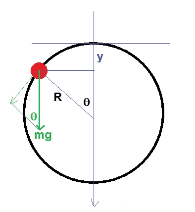

If the ring moves up the string becomes slack, so the tension is zero.
Find the vertical acceleration of the beads in terms of the angle θ. Write y, and take the second derivative.
Use conservation of energy to get the derivatives of θ. Derive the expression for the acceleration of the center of mass of mass, and find the condition, that it is equal to g.
